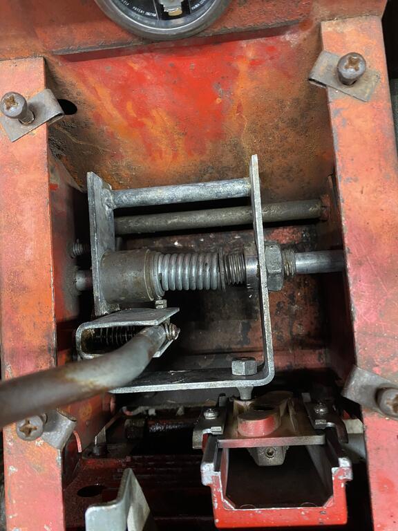

davidtmercer 83 #1 Posted July 2, 2023 I have a 1973 C-160 auto with Sundstrand 90-1140 installed. It has the hydraulic lift. The forward speed is too fast and can't be properly regulated with the centrally located forward reverse lever. Reverse speed is fine. Any assistance in resolving this would be greatly appreciated. Share this post Link to post Share on other sites

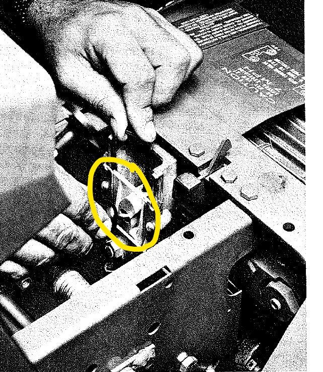

pfrederi 20,874 #5 Posted July 2, 2023 Is the plastic slider broken and or cracked (yellow circle) Try a neutral adjustment 2 Share this post Link to post Share on other sites
davidtmercer 83 #6 Posted July 2, 2023 It was the speed control lever tension adjustment. I took it apart, cleaned it in solvent, replaced it and adjusted it per instructions. The spring is almost fully compressed but it is currently keeping the control lever from moving. I am planning on replacing the acceleration spring and the plastic slider as preventative measures Thanks for your recommendations. Dave 1 Share this post Link to post Share on other sites
