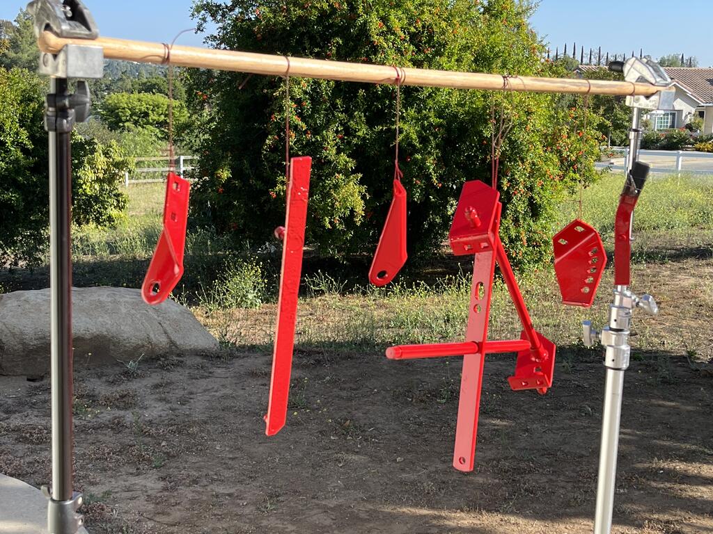

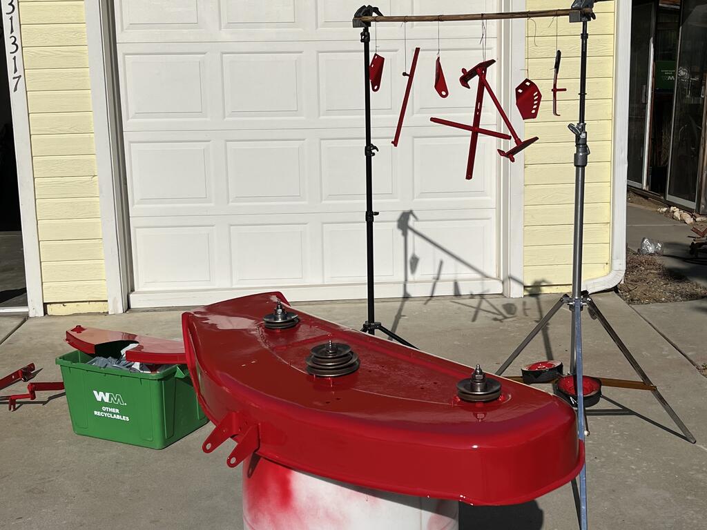

RoubaixRider 133 #1 Posted July 1, 2023 Well, I finally shot some some paint on the deck after a frew days of rust and surface prep. My deck had spent several years outside in the California semi-desert, and although not far gone, had a pretty good case of “patina.” Judging from the underside of the deck, it’s experienced very little use, and all of the fittings were still very well greased, and ran incredibly smooth, so for now, I decided to forgo going deep. I’ll do that in a little bit. I need to get this mower in action. This tractor, although gradually being restored is a user. The paint is Sunrise Red from RustOleum. I really think this color looks great and pretty close to what I remember. Wheelhorse Tractor’s looking like as a kid. 1 3 Share this post Link to post Share on other sites
ri702bill 10,610 #2 Posted July 1, 2023 (edited) Looks good so far! Without the use of a hardener in the paint, it most likely take a couple of weeks for the paint to dry sufficiently to allow handling for reassembly. Been there, done that! I see you wish to reassemble and get this goung soon... Did you paint the underside also?? That is the most critical area to me - if the grass is damp and clippings stick to it once you finish mowing, that is where the rust-out problem begins. So, if you painted it recently as the top - you may wish to invert the deck to allow the sun to reach the inside... If you did not paint the underside, NOW is a great time to choose a method to increase its life and deter the clippings from sticking, while the topside cures. The opinions vary here by members on the forum for what "treatment" to use. Some prefer to use spray-on truck bed liner, others use POR-15, and @peter lena is a firm believer in the 2 step penetrating oil soakdown method. IMHO, any one of them is better than just paint on bare steel.... I am not seeing the curved insert for the bottom, some 42" decks have it as a separate item - if you have one and it is welded in - it usually does more harm than good - areas between the blades collect the clippings and are very difficult to clean out to prevent rust. Nice use of the adjustable roll around rack for drying the parts. Search for the methods mentioned above for more info on each.. Bill Edited July 1, 2023 by ri702bill 1 Share this post Link to post Share on other sites
peter lena 9,562 #3 Posted July 1, 2023 @ @RoubaixRider nice job on that , do a regular look see on my stuff , just to check out on function and durability / issues . notice a lot of mowing decks are very low , not allowing for total deck venting / discharge , that by itself is a major corrosion builder . when I drop a deck , in addidition to a light clean out , prop it up to the sun , for a hot dry out , lubricate it to kill off the grunge and give it a break from grass rot build up .the oil soak , tends to bake on the hot under of deck , preventing rust and helping it shed debris . do this on my decks , no rust / rot solid , pete 2 Share this post Link to post Share on other sites

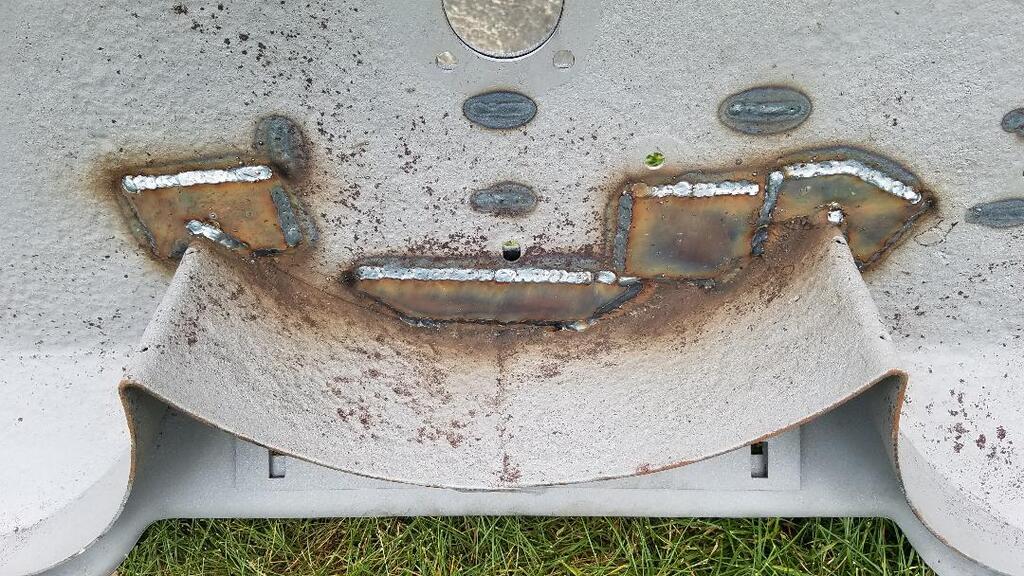

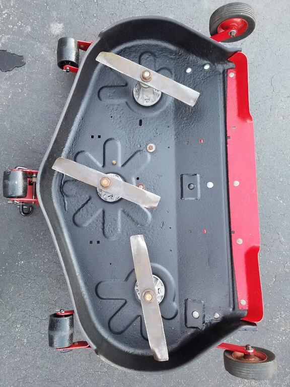

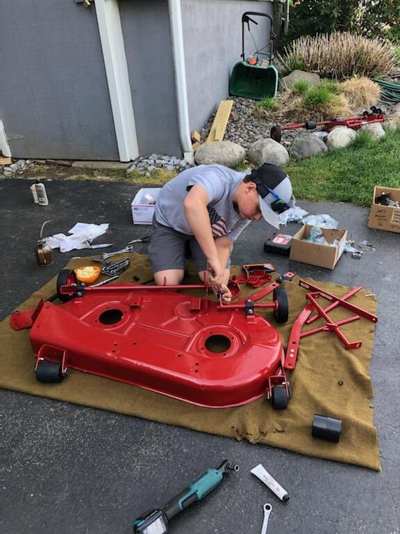

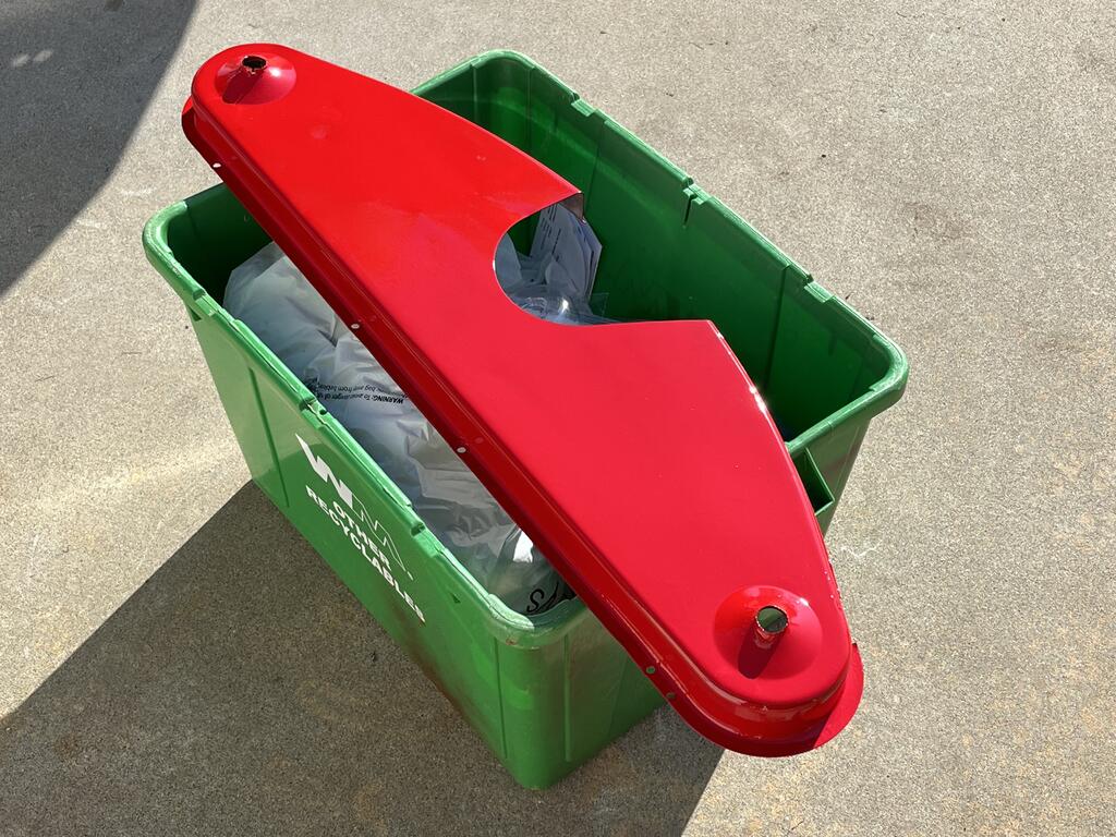

Brockport Bill 2,123 #5 Posted July 1, 2023 here are a few decks done some rehab work on - key thing to me is getting the underneath to bare metal -- getting the corrosion off -- i have also used professional sand blaster guy to save the really bad decks -- getting that degree of cleaning is a savior before whatever treatment you plan to then use 2 1 Share this post Link to post Share on other sites
peter lena 9,562 #6 Posted July 2, 2023 @Brockport Bill nice job on those decks ! its your interest and detailing that is the difference . initially found that just giving a deck a break form the grunge cycle , with a light clean out oil soak and tilted to the sun , to get it hot and dry made a world of difference . then I got into the bearing failure / noise issue , and combined the 2 for a solidily reliable . quiet unit . your weld repair is spot on . also put them away dry / cleaned , and oil soak , greased over winter , scary how we agree on this common failure , pete Share this post Link to post Share on other sites
Brockport Bill 2,123 #7 Posted July 2, 2023 8 minutes ago, peter lena said: @Brockport Bill nice job on those decks ! its your interest and detailing that is the difference . initially found that just giving a deck a break form the grunge cycle , with a light clean out oil soak and tilted to the sun , to get it hot and dry made a world of difference . then I got into the bearing failure / noise issue , and combined the 2 for a solidily reliable . quiet unit . your weld repair is spot on . also put them away dry / cleaned , and oil soak , greased over winter , scary how we agree on this common failure , pete i am always impressed with your advice to to others about mower care and maintenance -- i have a deck i plan to do this fall with your oil soak method -- i only took basic 11th grade chemistry - -plus typical lessons from my Dad about equipment care and metal and moisture not mixing -------------- I've tried to pass along to my 2 children and grandsons about caring for tools and equipment --- it really is a shame to see so many WH decks ruined with rust through holes just because of people not caring about a periodic cleaning - using a putty knife, a pressure wash -- end of season maintenance, etc. Just the $ expense of new equipment would seemingly be enough motivation for people but apparently in our "throw away culture" its sad so many people toss items and just go buy a replacement. The WH tractors are life long equipment to protect - including the next generation ---- my grandsons are already being taught - here are photos of 16 yr old grandson doing work on KT17 on C175....... my son snow plowing with the 312 in 1989 at age 8 ......... my sons 16 yr old and daughters 10 yr old replacing an electric pto clutch under a 257h a few months ago........ my now 16 yr grandson doing some mowing age 7, ........... and my grandson re-assembling the 37 s.d. mower after rehab ---- Take care, Bill 1 1 Share this post Link to post Share on other sites

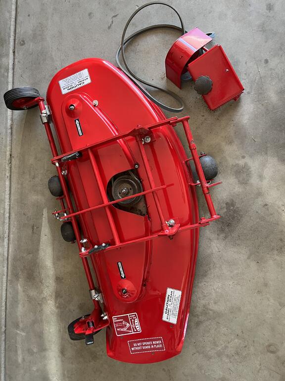

RoubaixRider 133 #15 Posted July 12, 2023 Well, Got the decals installed that I purchased from Terry. Was pretty sure they were in the right spot…worked for me. Gave it that finished look. This is a deck that I use, and it worked very well…but now that the grass is cut, it’ll be sitting for a good while. 🤣 Thanks for the help guys, Jason 1 4 Share this post Link to post Share on other sites
