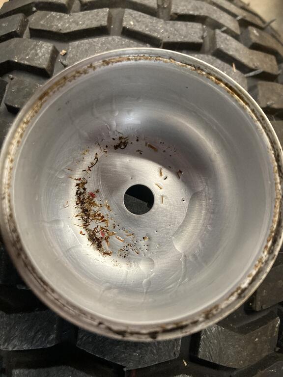

SylvanLakeWH 32,823 #1 Posted June 30, 2023 Started getting the C105 ready for snow plow duty and she's running a bit wonky...seems to be surging and a slight intermittent backfire... thoughts? 10 hp K 241AS Take a listen... IMG_2369.mov IMG_2368.mov Share this post Link to post Share on other sites
ineedanother 2,885 #2 Posted June 30, 2023 Fuel. I would be curious as to how long it's been sitting and what the fuel looks like. Drop the bowl and have a look. I don't see the fuel filter. That's a long run for fuel line so if it hasn't been replaced in a while, consider that along with moving the filter as close to the carb as reasonably possible. You might need to do a cleaning on that carb. 3 1 1 Share this post Link to post Share on other sites
SylvanLakeWH 32,823 #3 Posted June 30, 2023 Rec fuel. No ethanol. Purchased couple months ago. Used it all last winter to push snow and was in the Memorial Day Parade couple weeks ago... Fuel line / filter was replaced about a year ago. @ineedanother Thanks for the input. will check those out. Share this post Link to post Share on other sites
ineedanother 2,885 #5 Posted June 30, 2023 6 minutes ago, SylvanLakeWH said: ugh Well, there you have it, probably. Likely something hung up in your main jet Glad you can get rec90. I live in a county of more than 325,000 and there's not a single source for non-ethanol. Share this post Link to post Share on other sites

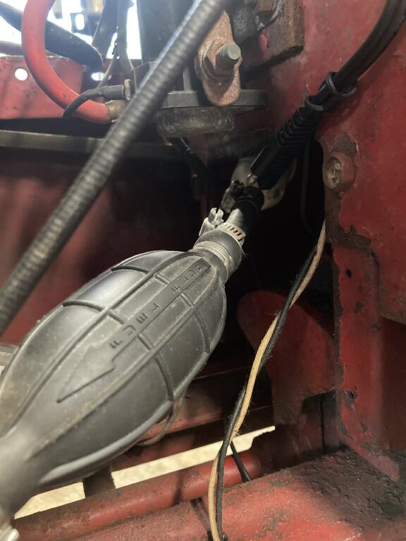

SylvanLakeWH 32,823 #6 Posted June 30, 2023 Just cleaned it up and purrs like kitten. Few shots of carb clean after to get the cob webs out. Gonna change the filter too. It's just above my marine bulb... Thanks for the help. 2 3 Share this post Link to post Share on other sites
