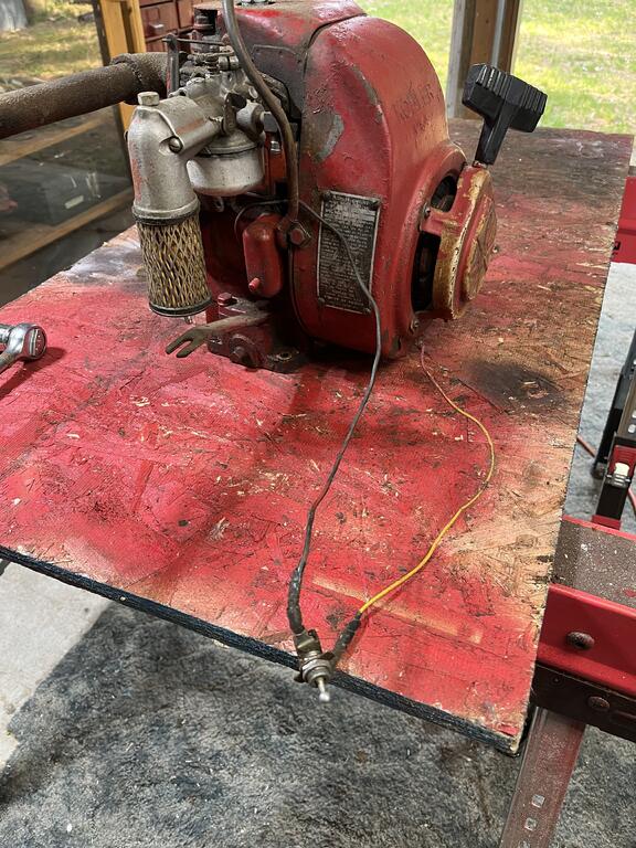

Bob Bauer 27 #1 Posted June 29, 2023 I have a question on Kolher k 91 RJ there is toggle switch on the dash and I think it for the on and off for the engine and one wire is disconnected but I still have spark.can you tell me where these wires are supposed to be hooked up? Thanks Share this post Link to post Share on other sites
Racinbob 12,996 #2 Posted June 29, 2023 It looks like your black wire it where it goes. The yellow goes to ground. 4 Share this post Link to post Share on other sites
Bob Bauer 27 #3 Posted June 29, 2023 8 minutes ago, Racinbob said: It looks like your black wire it where it goes. The yellow goes to ground. 9 minutes ago, Racinbob said: It looks like your black wire it where it goes. The yellow goes to ground. 9 minutes ago, Racinbob said: It looks like your black wire it where it goes. The yellow goes to ground. 9 minutes ago, Racinbob said: It looks like your black wire it where it goes. The yellow goes to ground. Thank you Share this post Link to post Share on other sites
Pullstart 70,095 #4 Posted June 29, 2023 Yep, you ground the wire out to kill the ignition on those. 3 Share this post Link to post Share on other sites
