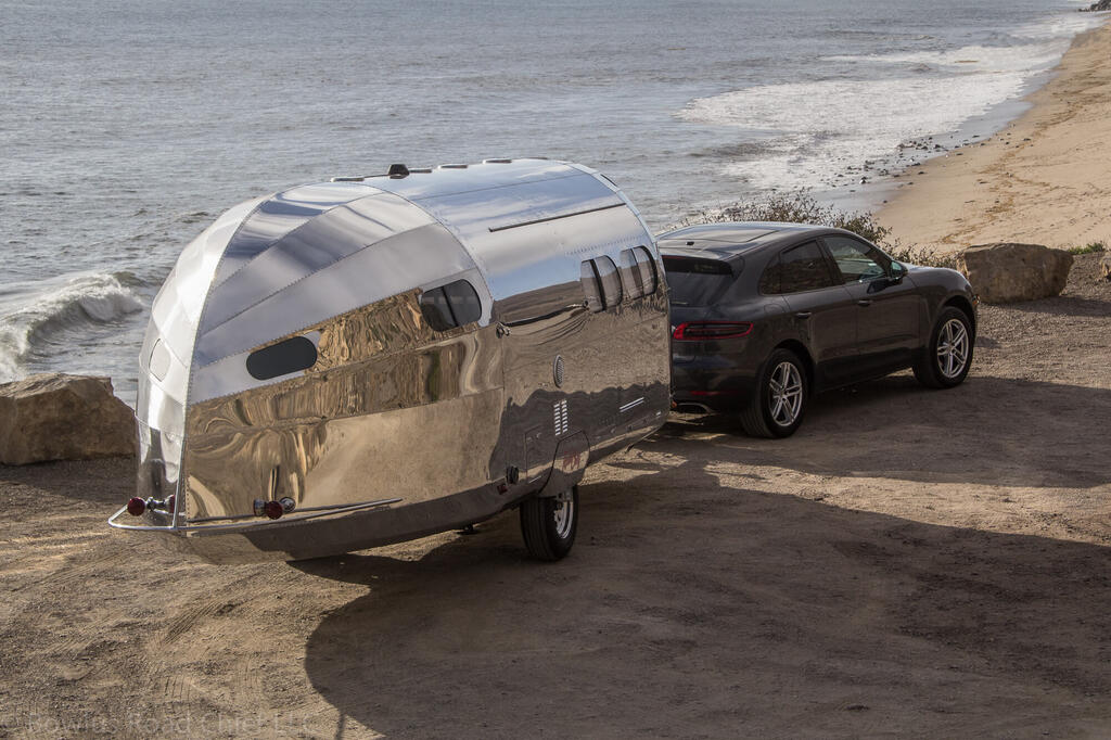

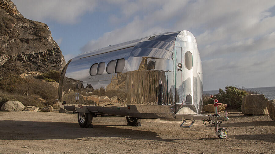

wh500special 2,344 #29 Posted July 6, 2023 A trailer that exemplifies the taper-at-the-rear design is this Bowlus Road Chief pictured below. Convert one of these to a cargo trailer and you’re set. Of course you’ll need deeper than average pockets. Surge brakes really only show up on rental equipment and boat trailers in the US. There are enough disadvantages that taking away their legal status has been considered. Perhaps their most significant drawback is that with a light tow vehicle (in comparison to the towed trailer) and on slippery roads it’s easy to create a situation where the tow vehicle doesn’t have enough traction to sufficiently resist the trailer and permit the actuator to develop braking pressure. Throw in a curve while braking and the situation can get worse. Outside of U-Haul and the marina, surge brakes don’t enjoy widespread acceptance. I always wanted an enclosed cargo trailer but never got serious about getting one. We’ve upfitted a few of them at work with mounted equipment inside (generators, deployable tents, etc) and have found they were generally all about the same quality level with the exception of the Wells Cargo and Doolittle brands. They were both screwed together and sealed up a little better, but even the cheapest seemed perfectly adequate for normal use. I don’t know if either or both of these brands are nationwide or regional however. Steve 2 Share this post Link to post Share on other sites
