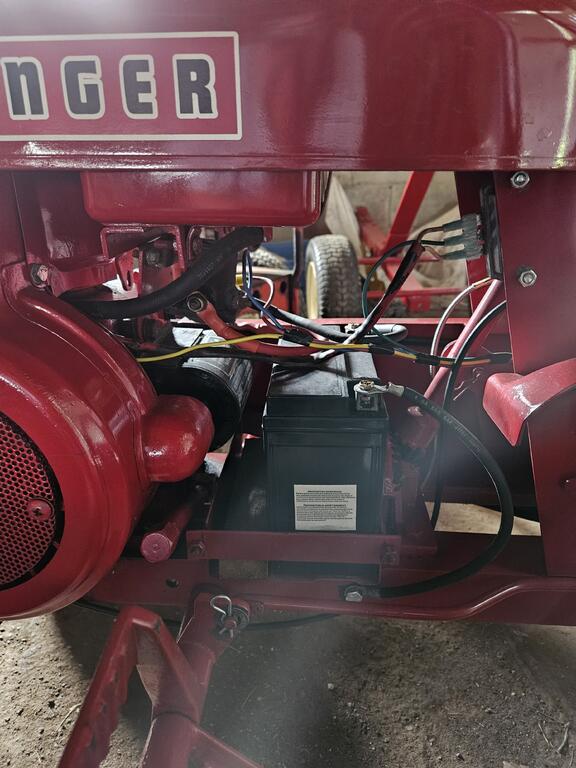

Mike'sHorseBarn 3,683 #1 Posted June 28, 2023 So I bought a lawn ranger at the big show that was already converted to an 8hp kohler, big reason why I bought it. Just want to see if I can relocate the battery somewhere so I don't have to buy million dollar motorcycle batteries. I know other tractors you can put the battery under the seat, but I don't think there's room on this. Thoughts? 2 Share this post Link to post Share on other sites
Jon Paulsen 291 #2 Posted June 28, 2023 Nice looking wheelpony! I would get an ammo can, paint wheelhorse red and attach the battery being the seat. But that's just me You might be able to find an actual surplus box that is a better fit than the HF fakes. Army surplus or fleabay. The real ones are also a much thicker material. I think you would want it well vented. Add drain holes, maybe a barbed fitting for a hose so it can't drain on the pony if the battery starts marking it's place. Share this post Link to post Share on other sites
SylvanLakeWH 32,598 #3 Posted June 28, 2023 Front or back on top a winch plate... maybe have @Wheel Horse 3D make up a fake tombstone weight to cover it... 1 Share this post Link to post Share on other sites
ri702bill 13,088 #4 Posted June 28, 2023 (edited) Different approach - looks like, with a bit of works, the welded battery box could be freed up and relocated aft a tad / rewelded to clear the starter and use a standerd U1 battery...... win / win... almost looks original that way.... OOPs - lower steering is in the way... Bill Edited June 28, 2023 by ri702bill Share this post Link to post Share on other sites
ri702bill 13,088 #5 Posted June 28, 2023 (edited) OK - round two... Can you relocate the U1 battery on the left frame rail the long way?? Tucked in after the bump out on the engine housing, next to the steering and just over the lower steering block tab?? Give a tape measure look-see! Would require a custom built battery tray & clamp.... Edited June 28, 2023 by ri702bill Share this post Link to post Share on other sites
