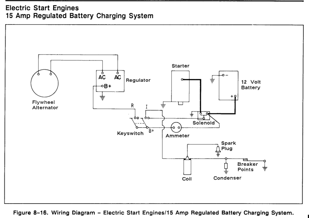

ineedanother 2,806 #3 Posted June 27, 2023 2 hours ago, SaintJay said: I don't need to connect all the safety switches, I just want to turn the key and start it. I get it. Just to run during the swap. Will this work? Not sure which k341 you have... 1 Share this post Link to post Share on other sites

SaintJay 9 #5 Posted June 28, 2023 Yes, the B&S had magneto ignition and the K341s has a coil. I am trying to follow the wiring on my C165 as a guide. The problem I am having is that my C165 hasn't been charging the battery. I believe that the rectifier was removed prior to me getting it. I just ordered 2 of them and a new ignition switch for the GT1142. Ineedanother thanks for the diagram. I think that will put me on the right track. How about the key for the output shaft/drive pulley keyway? Anybody know a size or part number? Thanks for the help, Share this post Link to post Share on other sites
