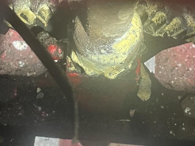

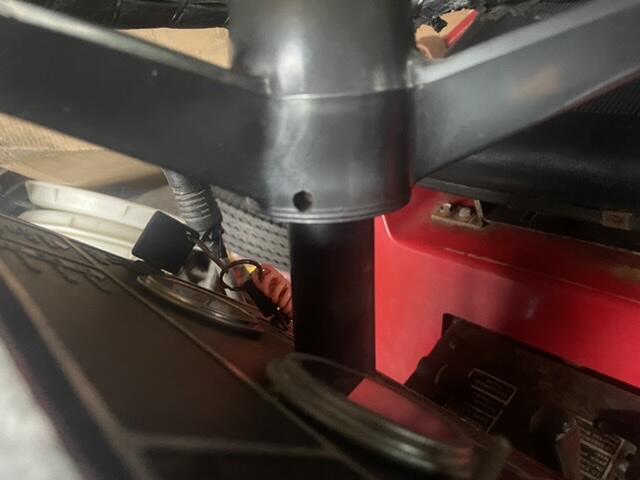

AHS 1,695 #1 Posted June 27, 2023 My (new 3/23) C175 was steering hard, all the grease zerks hadnt been touched in a while! I discovered the steering gear had seen better days! The grease zerk is pointed right towards the fan gear. All i have to do is punch the roll pin out of the steering wheel, and then the gear and steering rod come out? Ive never done this before! Ive heard about cracks in the fan gear assembly? Share this post Link to post Share on other sites
ri702bill 12,472 #2 Posted June 27, 2023 (edited) Your upper steering gear is welded to the shaft as your picture shows. (Older versions were not - were held with a pin) The fan gear is pinned and MAY be a source of lost motion in the steering. Very common to have to line drill and ream one size up (say 1/4" to 5/16" to get a proper tight fit...) AND an extra shim may be needed behind the fan gear hub to get a better engagement of the teeth... The cracks you refer to may be the arms of the lower steering block - VERY prone to cracking.... Gear removal is Best done with a domed roll pin punch, NOT a flat faced drift. Edited June 27, 2023 by ri702bill 1 Share this post Link to post Share on other sites
oliver2-44 11,622 #3 Posted June 27, 2023 I've learned from others on here and now just drill out the steering wheel roll pin with a carbide glass/tile bit. I do it in 2 passes stepping up in size. Take it slow and steady with a hand drill https://www.homedepot.com/p/RYOBI-SpeedLoad-Carbide-Hex-Shank-Glass-Tile-Bit-Set-4-Piece-AR1650G/205193138 1 Share this post Link to post Share on other sites
AHS 1,695 #4 Posted June 27, 2023 9 hours ago, ri702bill said: Your upper steering gear is welded to the shaft as your picture shows. (Older versions were not - were held with a pin) The fan gear is pinned and MAY be a source of lost motion in the steering. Very common to have to line drill and ream one size up (say 1/4" to 5/16" to get a proper tight fit...) AND an extra shim may be needed behind the fan gear hub to get a better engagement of the teeth... The cracks you refer to may be the arms of the lower steering block - VERY prone to cracking.... Gear removal is Best done with a domed roll pin punch, NOT a flat faced drift. The lower steering block comes out, right? Don’t quote. Me, but i have seen two bolts that hold on the fan gear? Share this post Link to post Share on other sites
squonk 47,370 #5 Posted June 27, 2023 The 2 bolts hold the block. The block holds the shaft the fan gear pivots on 1 Share this post Link to post Share on other sites
