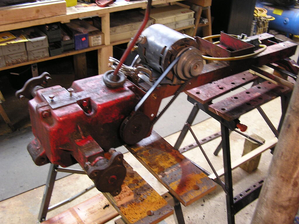

ri702bill 11,345 #10 Posted June 27, 2023 (edited) When you drain the Unidrive, to get ALL the liquid out, you need to raise the front end at least a foot to allow the oil to get over the hump on the bottom.... Raise it by the frame, NOT the front axle - that wat you can PROPERLY lube the grease fittings while waiting for it to drain completely. A half gallon of diesel fuel is all you need, works wonders. I did a bench setup to flush last year... worked well. Edited June 27, 2023 by ri702bill 3 Share this post Link to post Share on other sites

Jon Paulsen 291 #15 Posted June 27, 2023 1 hour ago, ri702bill said: When you drain the Unidrive, to get ALL the liquid out, you need to raise the front end at least a foot to allow the oil to get over the hump on the bottom.... Raise it by the frame, NOT the front axle - that wat you can PROPERLY lube the grease fittings while waiting for it to drain completely. A half gallon of diesel fuel is all you need, works wonders. I did a bench setup to flush last year... worked well. Sooooo, where's the cylinder on that thar engine? 1 Share this post Link to post Share on other sites
8ntruck 8,609 #16 Posted June 27, 2023 (edited) it is laying on its side, bolted to the frame. Edited June 27, 2023 by 8ntruck Share this post Link to post Share on other sites
ri702bill 11,345 #17 Posted June 27, 2023 1 hour ago, 8ntruck said: it is laying on its side, bolted to the frame. Nope - that thar is a 1/2 HP E-lectric Motor I had kicking around. With the proper alility to move the Fast-On wires to reverse it to a CCW direction - like a Kohler... 1 Share this post Link to post Share on other sites
8ntruck 8,609 #18 Posted June 27, 2023 But, it is the cylinder that is making the transmission go round & round......... Share this post Link to post Share on other sites
ri702bill 11,345 #19 Posted June 27, 2023 8 minutes ago, 8ntruck said: But, it is the cylinder that is making the transmission go round & round......... The cylinder is the electric motor - yellow power cord is in front of it.. Share this post Link to post Share on other sites
8ntruck 8,609 #20 Posted June 28, 2023 And the motor is cylindrical in shape. I see a visual pun here, that's all. Share this post Link to post Share on other sites
