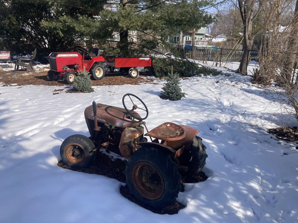

SylvanLakeWH 31,718 #3 Posted June 25, 2023 (edited) How big and how far? Strap / chain will do the trick for short distances directly from the draw bar. I've used my utility cart and strapped just the front in the cart and let them drag behind and dragged them out that way. You can see in the back of this picture. Edited June 26, 2023 by SylvanLakeWH 4 Share this post Link to post Share on other sites
