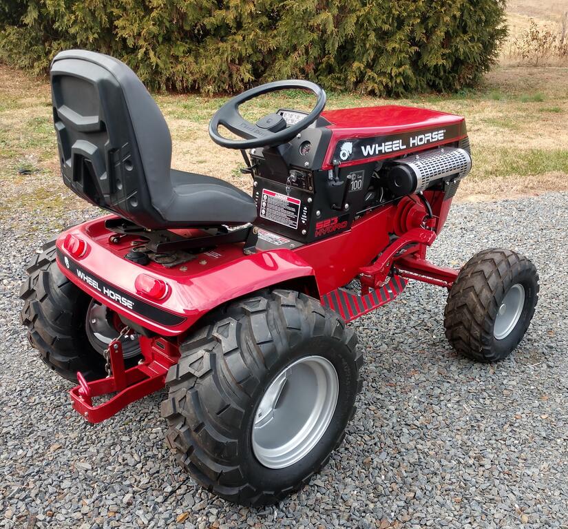

johnnymag3 2,646 #1 Posted June 21, 2023 Good day everyone...... Can I mount a 24 x 12 x 12 tire on my 520 Deep Dish wheels and have them fit on my 400 Series Tractors without any spacers..... ??? or on my C Series Machine C-160 ... ??? Thanks in advance !!! I am looking for any and all recommendations. JOHN Share this post Link to post Share on other sites

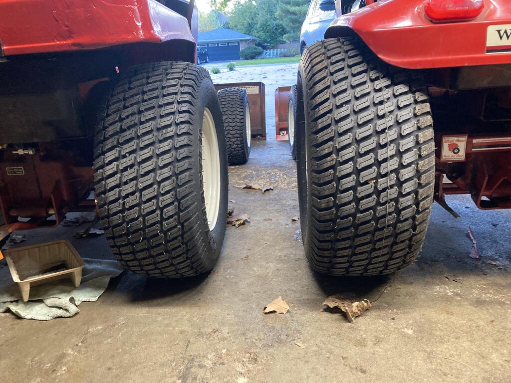

SylvanLakeWH 32,927 #7 Posted June 23, 2023 "Same size" rear tires according to the manufacturer... 23x9.5x12 Carlisle Turfmaster. Purchased couple years apart... I'll let you figure out the more recent purchase... go figure... 3 1 Share this post Link to post Share on other sites
