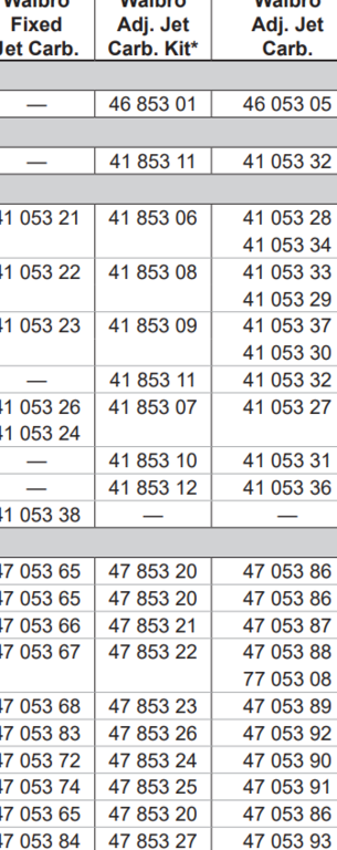

ANTPER 215 #8 Posted June 20, 2023 3 hours ago, squonk said: That may be a Wabro carb that's a whole nother animal compared to a std. Kohler carb. Do you have the carb number? You are correct. Wabro. 47 053 86 is one serirs of numbers. Next WHG 712892 Share this post Link to post Share on other sites
squonk 48,326 #9 Posted June 20, 2023 (edited) Kit is a # 47-853-20 You may have a difficult time finding a kit. I do see some Walbro bowl gaskets on Amazon and some small engine sites Edited June 20, 2023 by squonk 1 Share this post Link to post Share on other sites
