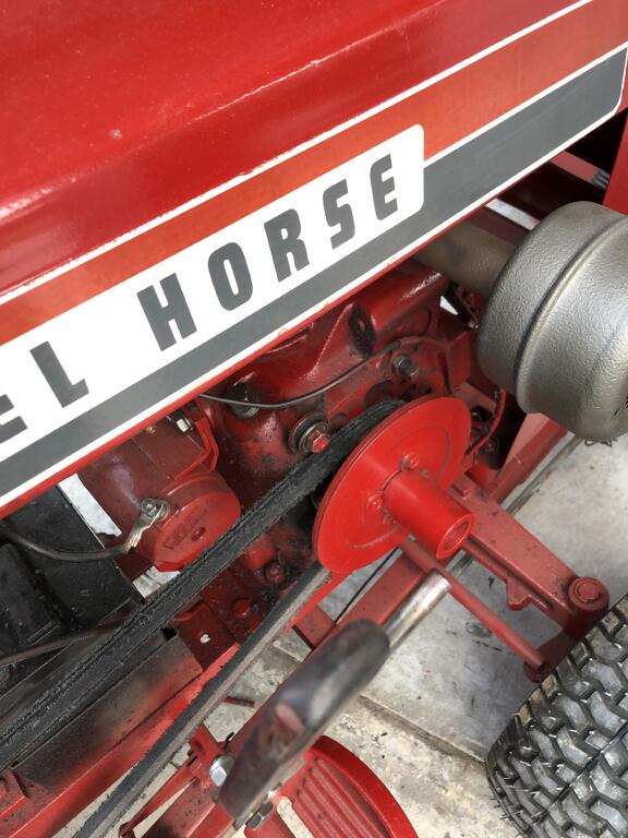

Achto 32,267 #2 Posted June 20, 2023 Any pictures of your set up, specially up near the engine, You may be missing some tabs on your belt guard or ?? 2 Share this post Link to post Share on other sites
WHX?? 57,649 #3 Posted June 20, 2023 if I haven't already done so. Sounds like you may have a belt guard issue and/or incorrect belt length. There might be some tabs on the front of the belt guard that are worn or missing. The belt guard needs to be on and in proper condition to brake the belt for proper shifting. There also might be a belt stop on the clutch idler that is important as well. The tractor should be at a complete stop for any shifting. As Dan said... pics will tell us a thousand words. 3 Share this post Link to post Share on other sites

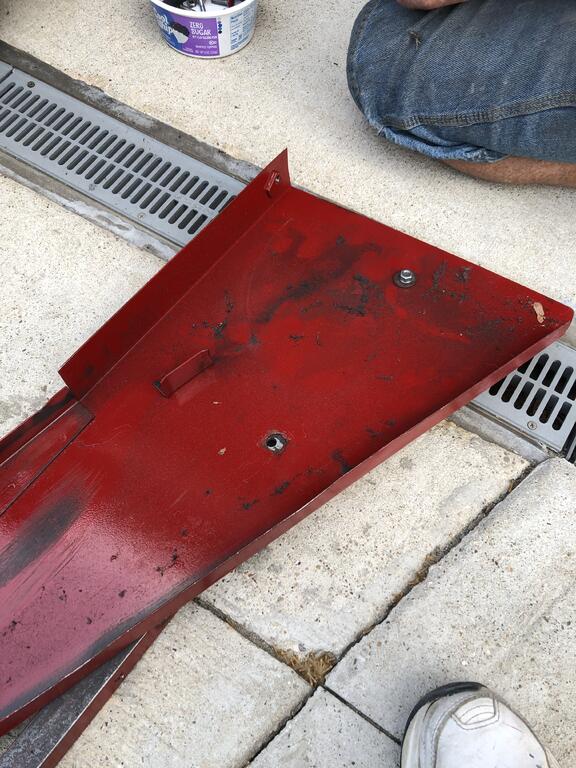

Jon Paulsen 291 #7 Posted June 24, 2023 any chance the fuzzy belt could be a problem? Is the belt guard oily or is that just a reflection? (I don't know anything about these horses) Share this post Link to post Share on other sites
Handy Don 17,212 #8 Posted June 24, 2023 No direct experience with horses of this vintage, but from looking at some around the show I noticed that more than a few have a bent-wire guide that rubs against a slack belt -- in addition to the tab on the belt cover. BTW, that tab can be manually tweaked to be sure it rubs the slack belt and barely misses the taut belt. On later models, I’ve seen a tab on the idler pulley that rubs when the pulley moves into the “disengaged” position. Hoping another member has some images they can share. Share this post Link to post Share on other sites

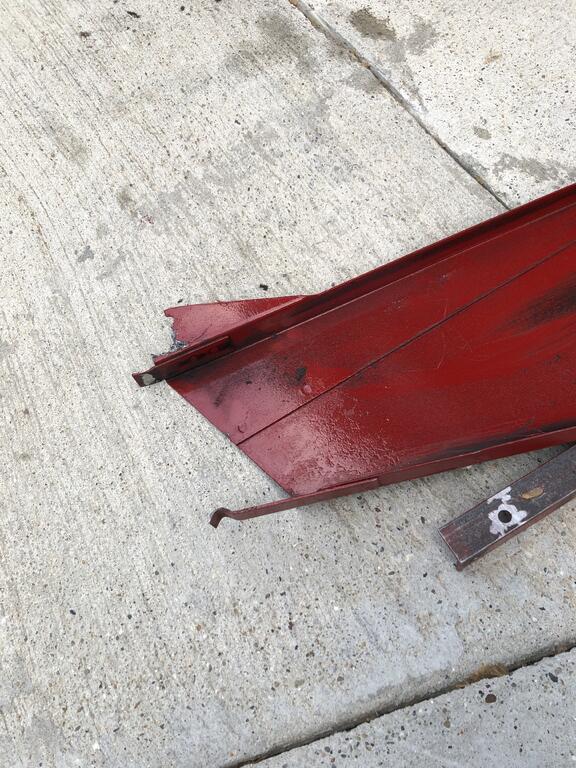

peter lena 9,993 #9 Posted June 25, 2023 @Old Tech think the outer TOP SIDE FRAYING IS SHOWING YOU THE FAULT , normally that would not even be an issue , belt sides are the typical wear area , and would also be smooth . think your belt guard , is off in its mounting spot , maybe even the wrong guard ? also note the belt debris on top of rear axel area , something is rough edging that belt , and shearing it like a lathe , should not be hard to find . would not be surprised if its the wrong guard , pete 1 Share this post Link to post Share on other sites

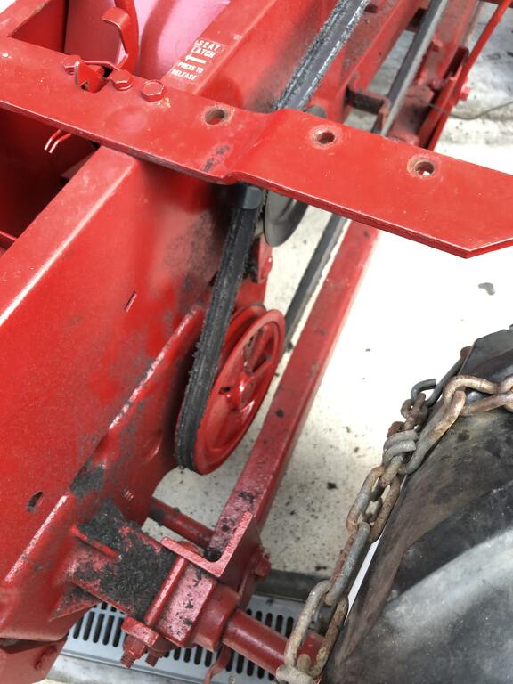

ranger 1,860 #10 Posted June 25, 2023 Is it a ‘Wrapped’ belt?, standard ‘Vee’ belts tend to ‘Grab’ more, also in the photo of the idler pulley, the belt brake ‘Tab’, fitted behind the tensioner, (Clutch) pulley, appears to be very close to the side of the belt, could that be causing the chafing? 1 Share this post Link to post Share on other sites
squonk 47,794 #11 Posted June 25, 2023 Start with a new belt. Gates 7473 Napa 5L820W Tractor supply 5L820 Belt guard must be on to shift trans. 3 Share this post Link to post Share on other sites
elcamino/wheelhorse 9,363 #12 Posted June 25, 2023 @Old TechI hand similar problem when I put a 8 speed in my Commando 800 (The famous Waldomobile ) . First problem was the rails in the trans were not aligned and the idler pulley was too large . Aligned the rails (where shifter goes into trans ) Replaced the idler pulley with on size smaller. Make sure the adjustment rod for the brake/ clutch is correct Looks like the tab on the idler pulley is touching the belt. 1 1 Share this post Link to post Share on other sites
rmaynard 17,495 #13 Posted June 25, 2023 On the 701 that I just rebuilt, the belt guard (which has to be on to get the belt to stop) did not have any tabs. So I made sure that the top of the guard was 1/8" off the belt (with the clutch out and belt tight). See picture below. And then I added a wire guide at the bottom also a little less than 1/8" from the belt. For me it fixed all issues with the belt not stopping. 1 3 Share this post Link to post Share on other sites
stevasaurus 23,786 #14 Posted June 26, 2023 (edited) You obviously need a new belt. Buy the one Squonk listed and let's see how it goes. The belt guard is your clutch. It stops the belt from turning so you can shift the transmission without grinding the gears. If you do not have the cloth belt, it will grab too much and the belt will not stop rotating. If you do have a cloth belt, check the alignment of your pulleys and whether the bearings are good...no slack in the bearings. Are the replaced pulleys the same diameter and width?? Do not use any belt sticky stuff!!! You need the belt to stop when you push in the clutch. All of those adjustments you made do nothing except to adjust the height of the clutch peddle and maybe the pressure on the brake. Edited June 29, 2023 by stevasaurus Share this post Link to post Share on other sites
