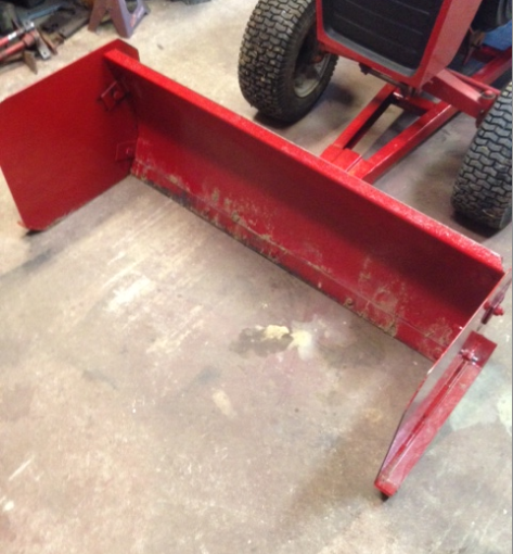

SylvanLakeWH 32,921 #3 Posted June 17, 2023 @JoeM very nice! Are those wings off a blower or did you fab them? 1 Share this post Link to post Share on other sites

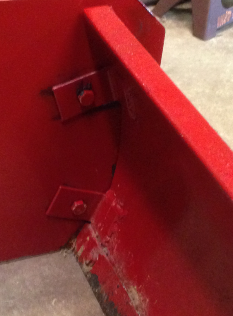

JoeM 10,318 #4 Posted June 17, 2023 1 hour ago, SylvanLakeWH said: Are those wings off a blower or did you fab them? Home made, tks We don't get enough snow to push. EB ended up with them and was asking how they mount. I am sure they will get a work out up there. 2 1 Share this post Link to post Share on other sites

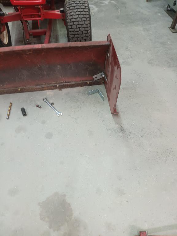

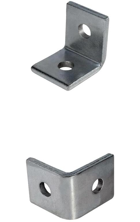

ebinmaine 81,281 #17 Posted January 24, 2024 Got a set of brackets in the post yesterday. I'll use these to bolt the side plates on to my 48" plow blade. On 6/17/2023 at 7:05 AM, SylvanLakeWH said: @JoeM very nice! Are those wings off a blower or did you fab them? Jim, for a size scale these are about 16" square. 1 1 Share this post Link to post Share on other sites

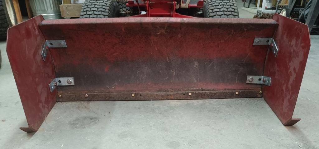

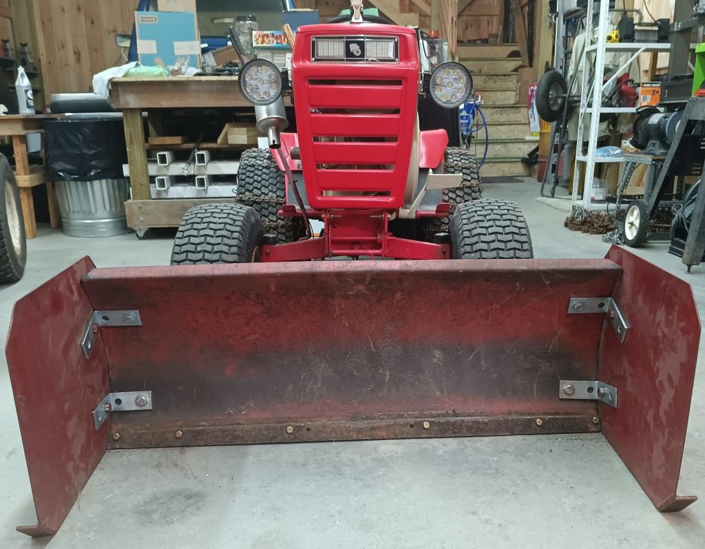

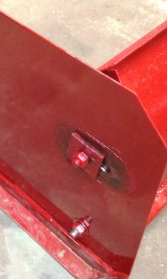

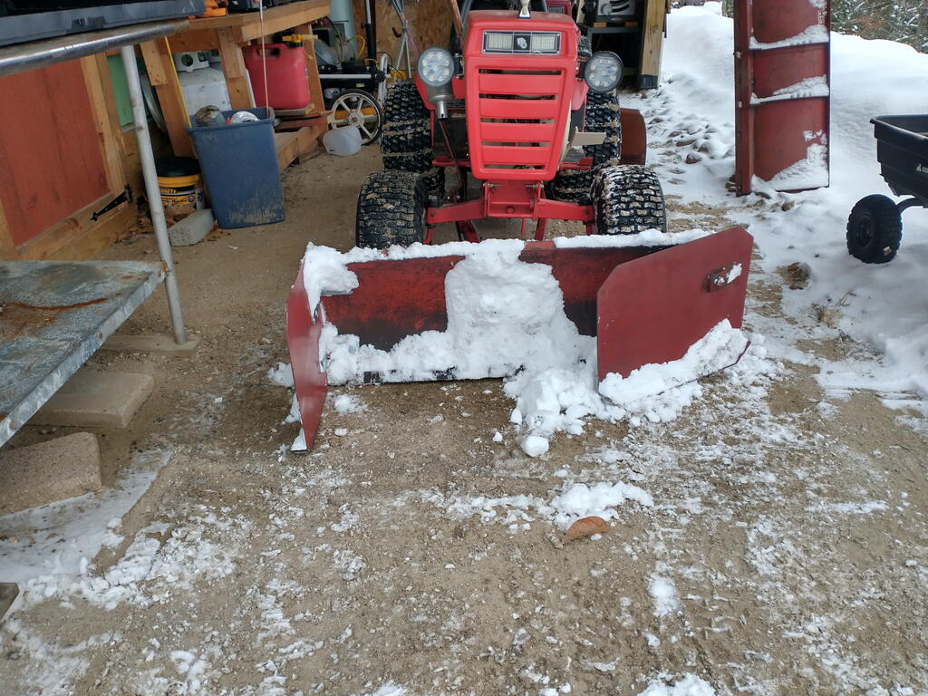

ebinmaine 81,281 #18 Posted November 28, 2025 Well. Here we are almost 2 years later. I've been using my 60" wide @wallfish -bilt plow for a few seasons. Works great but I wanted to try something a little different this year. Like any plow, the snow windrow escapes the tailing edge. Obvious. But it also escapes the forward edge. This year I'll have the above SUPER SCOOPER!! This should allow me to grab a half width or so of snow and just push it right in to the forest. The brackets in the previous post weren't quite wide enough because of interference to the plow frame bracing. I used a set with double holes per side but bolted only one hole 🕳 per. If the side scoops are flappity then I can add more bolts 🔩 or even consider a couple 45⁰ top braces. The 42" wide moldboard I chose is in really tough shape. Severely worn on the bottom and bent at the top. For those reasons I didn't feel too awful bad about drilling it. If this experiment goes well in principle I can consider using a 48" wide set-up. Here's the pics... now for some snow!! 2 4 Share this post Link to post Share on other sites
SylvanLakeWH 32,921 #19 Posted November 28, 2025 Excellent! I love the L bracket Frankenstein look!!! 3 Share this post Link to post Share on other sites
ebinmaine 81,281 #20 Posted November 28, 2025 34 minutes ago, SylvanLakeWH said: Excellent! I love the L bracket Frankenstein look!!! They'll get painted if the idea works out. I may add braces tomorrow. 1 2 Share this post Link to post Share on other sites

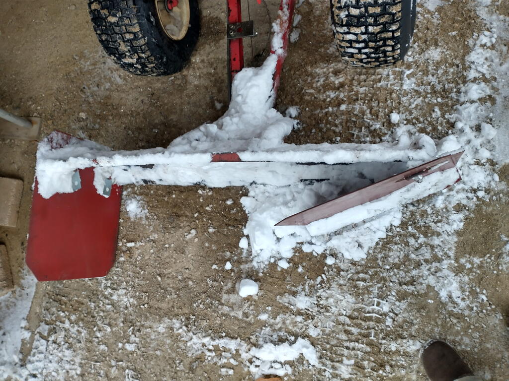

ebinmaine 81,281 #23 Posted December 24, 2025 (edited) Got a chance to really test this machine today. The more I used it - the more I like it. As much as I love SEAT TIME ... this is a VERY efficient way to plow snow. With 6 1/2" down I was able to force a whole scoop and then grab approximately thirds to push forward with minimal side losses. The side scoops are excellent but very weak. The BBT and I - having seen this setup in action - agree that this will need to braced - as previously discussed - AND welded at the edges. I caught a hidden rock at LOW speed. This was after I'd already straightened out the sides TWICE. Folding the brackets was waaay too easy with the weight of the tractor and all the added weight up against the rocks. It will also NEED to have any pivoting motions completely eliminated. This is a straight motion ONLY piece. Plow frame to tractor frame & plow to plow frame must be firm. More improvements soon! Edited December 26, 2025 by ebinmaine 2 Share this post Link to post Share on other sites
JoeM 10,318 #24 Posted December 24, 2025 maybe a tie bar across the top front edge ?? I seen others with vee gusseted too. 1 Share this post Link to post Share on other sites
ebinmaine 81,281 #25 Posted December 24, 2025 5 minutes ago, JoeM said: maybe a tie bar across the top front edge ?? I seen others with vee gusseted too. I'm thinking similar. Maybe a round rod at the front about 1/3 down from the top. I'll likely still do 45⁰ braces at the corners too. 1 Share this post Link to post Share on other sites
