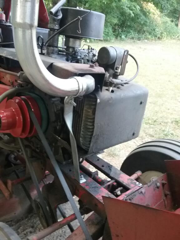

8ntruck 8,516 #32 Posted June 27, 2023 Good welding tips. I'm using flux core wire. It is what I have available. I'll agree that MIG is cleaner than flux core and maybe a better method for lighter gage material. I was trying to run a series of spot wields around the pipe, then short (1/2") breads between the spots. Most of the blow holes happened before I turned the voltage down a notch. I was pulling the weld on the short beads. I've got enough old muffler material now that I can chop it up into a bunch of coupons and practice looking for the sweet spot in settings and technique. 2 Share this post Link to post Share on other sites
