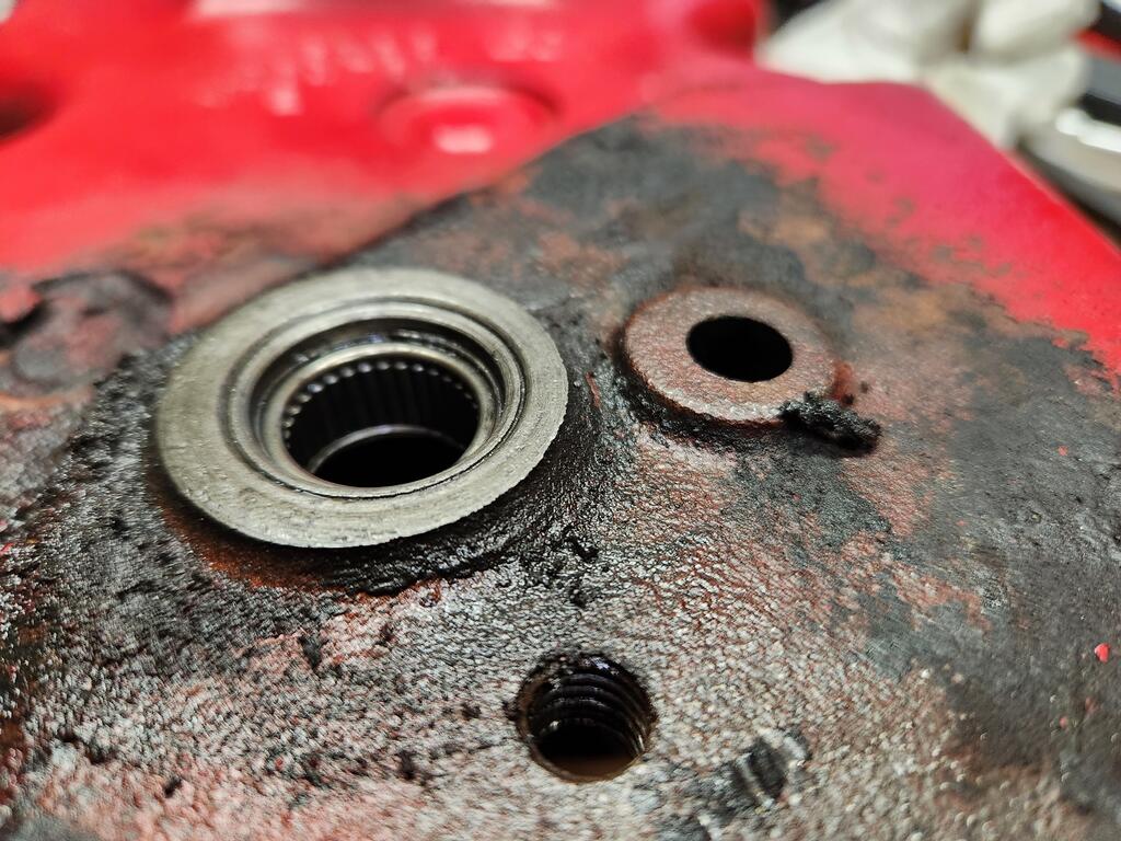

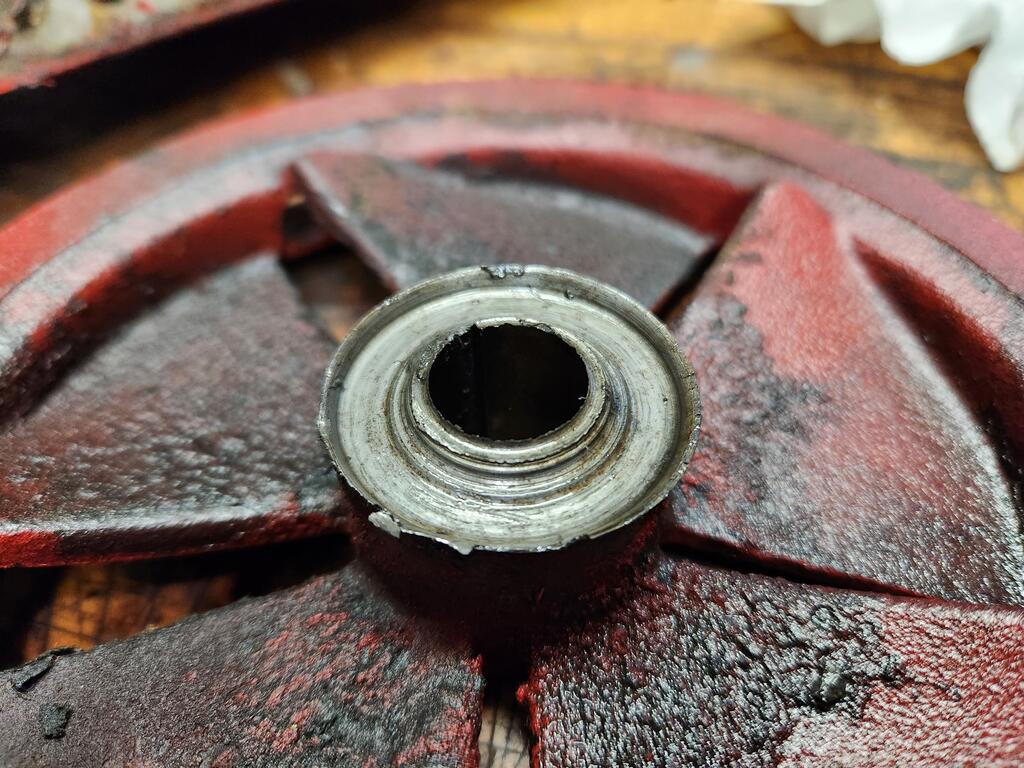

Crazy8 55 #4 Posted June 12, 2023 Thanks for tip on the plug for the detent spring & balls. Below are a couple pics showing the wear on the inside hub on the input shaft pulley. The pulley took the worst of the wear. I'm thinking that a brass shim washer between the pulley and the case would help prevent this wear. Thoughts? 1 Share this post Link to post Share on other sites
ebinmaine 81,289 #5 Posted June 12, 2023 3 minutes ago, Crazy8 said: . I'm thinking that a brass shim washer between the pulley and the case would help prevent this wear I can see the logic there but it shouldn't need it. Look around the inside belt groove for a set screw hole. I've had a dozen or more manual transmissions apart and never seen anything like that. Share this post Link to post Share on other sites
wallfish 20,744 #6 Posted June 13, 2023 26 minutes ago, Crazy8 said: Thoughts? It almost went deep enough to just seal itself I can see the hole in the groove in your pic about 11:00 The set screw is (or should be ) in the hub and the hole in the groove is so you can get to it with a hex tool A tight set screw and it shouldn't move. There's no much lateral force on those pulleys Share this post Link to post Share on other sites
Crazy8 55 #7 Posted June 13, 2023 When I went to pull the pulley off I found the set screw to be very tight, but the hex was clean and not rounded so it came loose without excessive force with the allen wrench. The pulley was still very tight to the shaft and I had to lightly drive the input shaft out of the pulley bore. This may indicate the pulley was set too far onto the shaft. I assume that when the gear case is reassembled, there shouldn't be very much end play in this input shaft that would result in this wear. Upon reassembly I'll check the shaft for excessive end play and correct it. Then I'll set the pulley with about 1/8" clearance to the case. I think you are right Wallfish, that the pulley had sealed itself against the case! Thanks for the input guys, Jeff Share this post Link to post Share on other sites

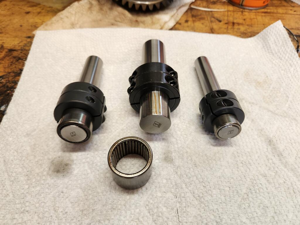

Crazy8 55 #11 Posted June 14, 2023 I came up with an idea to make some mandrels for pressing the needle bearings. From McMaster Carr I ordered short lengths of hardened & ground linear shafting and some double split shaft collars. The linear shafting is ground to very precise diameters and it fits the ID of the needle bearings perfectly. This will press them flush to the outside of the case then I'll still have to use a socket or something to set them deep enough for the shaft seals. 3 Share this post Link to post Share on other sites
Crazy8 55 #12 Posted June 15, 2023 I just had another idea for these mandrels. Once I have the needle bearings pressed in flush to the case, in order to press them in the additional bit more for the oil seal, I'll slide the collars back some and slide the old bearings onto the shafts and use them to set the new bearings in a little deeper. 2 Share this post Link to post Share on other sites
ebinmaine 81,289 #13 Posted June 15, 2023 6 hours ago, Crazy8 said: I just had another idea for these mandrels. Once I have the needle bearings pressed in flush to the case, in order to press them in the additional bit more for the oil seal, I'll slide the collars back some and slide the old bearings onto the shafts and use them to set the new bearings in a little deeper. I've done something similar to that. That will work quite well for you. Share this post Link to post Share on other sites
