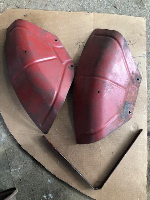

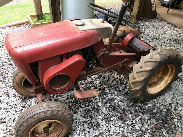

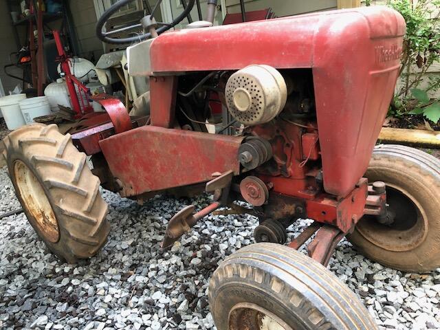

Sailman 1,305 #1 Posted June 11, 2023 So I found this 701 back in the winter and the PO said it had been in his family as far back as he could remember. Was in a storage building for the last 15 years and he says it ran when parked. I am just now getting around to working on it and REALLY need some recommendations on how to best "preserve" it. Don't want to do a restoration, want to keep it as honest and original as it is. I did use Penetrol on the toolbox, seat stand and v bracket fender support since they had so much rust. Was amazed at how solid they were under the rust! I have done the oil rub down on the fenders (they really soaked it up) but not sure what is best route for the tins. Just the oil rub down, penetrol, others? I don't want to do anything to "ruin" the value of it in its current condition. Ideas from the purists?? I know we all love pictures so.... 6 4 1 Share this post Link to post Share on other sites

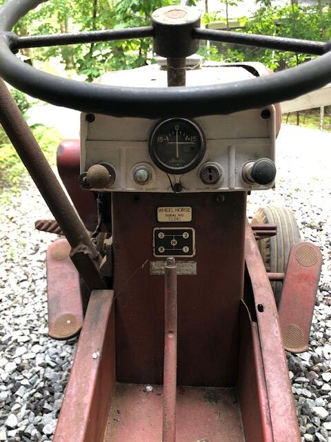

kpinnc 15,955 #2 Posted June 11, 2023 (edited) I'm wondering if the hood has been painted. The "WheelHorse" letters should be white, unless it just flaked off over time. Also no residuals of the hood decals. Not sure about the shifter. I think the first bent ones were for the HY-2 accessory hydro lift. That being said, she is very nice! Multiples nicer than either of my 701s. It would be hard not to restore it! Edited June 11, 2023 by kpinnc 3 Share this post Link to post Share on other sites
ri702bill 10,287 #3 Posted June 11, 2023 (edited) 46 minutes ago, kpinnc said: he "WheelHorse" letters should be white, unless it just flaked off over time. Also no residuals of the hood decals. Not sure about the shifter. I think the first bent ones were for the HY-2 accessory hydro lift. Agree on the possible repaint on the hood...1962 was the first year for the bent shifter to clear the HY-2 unit (look at the HY-2 manual - tells you where to bend a 1961 shifter..) IF you want to add value, loose the pepper pot and find a correct 1" Showerhead Muffler...IMHO - money well spent. (Good luck and be prepared to shell out a lot for it) Is the original dash cracked below the ammeter?? Possible wrong choke cable?? Missing small diameter shift knob is rather easy to find... Looks like a good solid start - has the correct pointed rear fenders (701 only)... Edited June 11, 2023 by ri702bill 1 Share this post Link to post Share on other sites
Sailman 1,305 #4 Posted June 11, 2023 (edited) Sounds like given the missing original parts and repainted hood it might be best to just penetrol it, paint the rims and go with that. Maybe not the original condition I thought. I am not up for a full on restoration. Edited June 11, 2023 by Sailman 1 Share this post Link to post Share on other sites

Wild Bill in VA 1,545 #6 Posted June 12, 2023 It's amazing to see the plastic dash in as good shape as it is! Most dash panels get broken when the choke or throttle cable get bound up. Not many original model 701 survivor tractors left, due to all the unique parts it's also the hardest Wheel Horse model to restore. Wild Bill in Richmond VA 2 2 1 Share this post Link to post Share on other sites

rmaynard 16,646 #11 Posted June 12, 2023 2 hours ago, Wild Bill in VA said: It's amazing to see the plastic dash in as good shape as it is! Most dash panels get broken when the choke or throttle cable get bound up. Not many original model 701 survivor tractors left, due to all the unique parts it's also the hardest Wheel Horse model to restore. Having restored one 701 in 2013 and now completing my second 701, I can't disagree about "hardest to restore". I've been working on the second one for 5 years. The dash on @Sailman 701 does show typical cracks. If the dash needs to be replaced, the ones that @wheelhorsemanis making are much stronger. 2 1 Share this post Link to post Share on other sites
