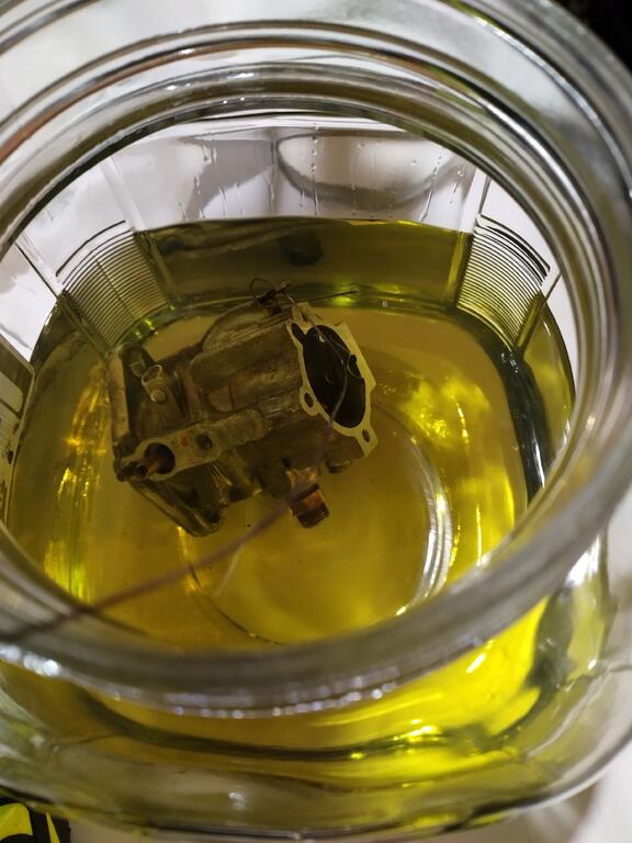

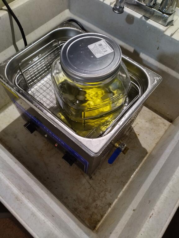

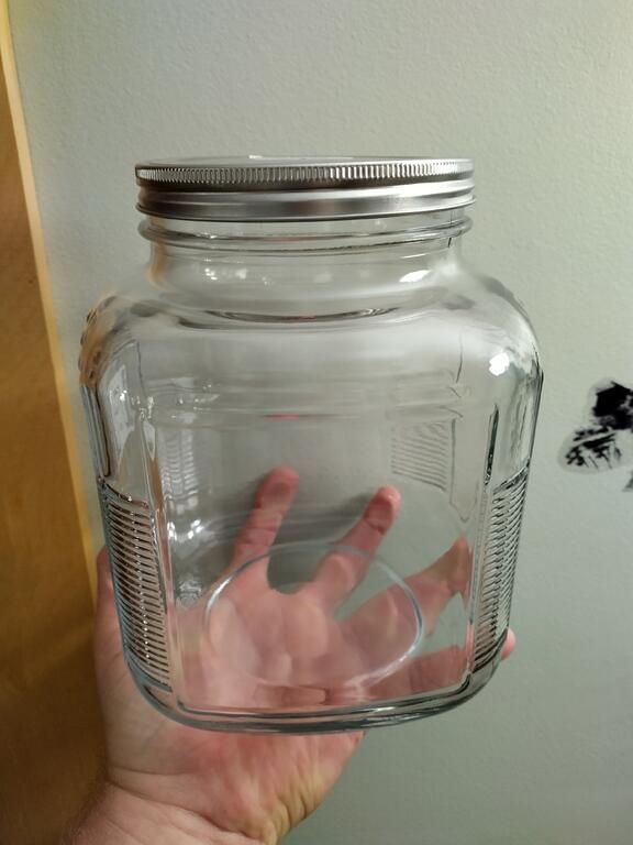

ebinmaine 80,756 #26 Posted August 18, 2023 I've been experimenting with several cleaning products for carbs. Tried pink stuff purple stuff green stuff and some other stuff. Per a YouTube video I watched I tried good ole gasoline. Success! Cleans excellent. Easily containable. Easily replaceable. Inexpensive. Also been experimenting with the internal container. Lots of folks don't fill the whole machine with the cleaning fluid. I liked that idea so I adopted it. I tried a couple types of plastic but the resonance wasn't great. I went to glass. Tried a couple different sizes and shapes. Today Trina and her mom were at the wally world. This new container landed here. Just excellent. Approximately 6 x 6 x 6. It'll hold at least 2 carbs. 2 2 Share this post Link to post Share on other sites
oliver2-44 11,758 #27 Posted August 19, 2023 Since your using the glass jar do you thing you would get more ultrasonic effect by removing the basket. So jar sits on bottom. 1 Share this post Link to post Share on other sites
ebinmaine 80,756 #28 Posted August 19, 2023 7 hours ago, oliver2-44 said: Since your using the glass jar do you thing you would get more ultrasonic effect by removing the basket. So jar sits on bottom. I've wondered that myself. The instructions from a cleaner I read (not sure if it was mine) states to leave the basket in place to prevent damage to the interior of the unit. Given that it's a glass jar with dull edges and not a sharp metal part being cleaned that's resting there, I may just try it. Share this post Link to post Share on other sites
ebinmaine 80,756 #29 Posted August 19, 2023 10 hours ago, oliver2-44 said: Since your using the glass jar do you thing you would get more ultrasonic effect by removing the basket. So jar sits on bottom. Did some reading this morning. Here's one of the references for keeping the basket in place: "Why Use a Basket for Ultrasonic Cleaning? Cleaning baskets may be an optional accessory when buying an ultrasonic cleaner. That’s because many users may already have baskets. Ultrasonic cleaner parts baskets are needed for two major reasons: 1. Parts baskets keep products being cleaned from contact with the bottom of the ultrasonic cleaner tank. Otherwise severe damage and eventual leaking will result due to vibrations. 2. Parts baskets ensure cavitation (cleaning) action is maximized by holding products at the optimum level above the tank bottom. This is why different tank dimensions call for correct basket specifications." It's the part in bold above that made me decide to keep the basket in. Share this post Link to post Share on other sites
