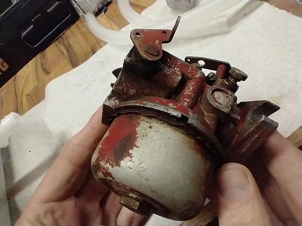

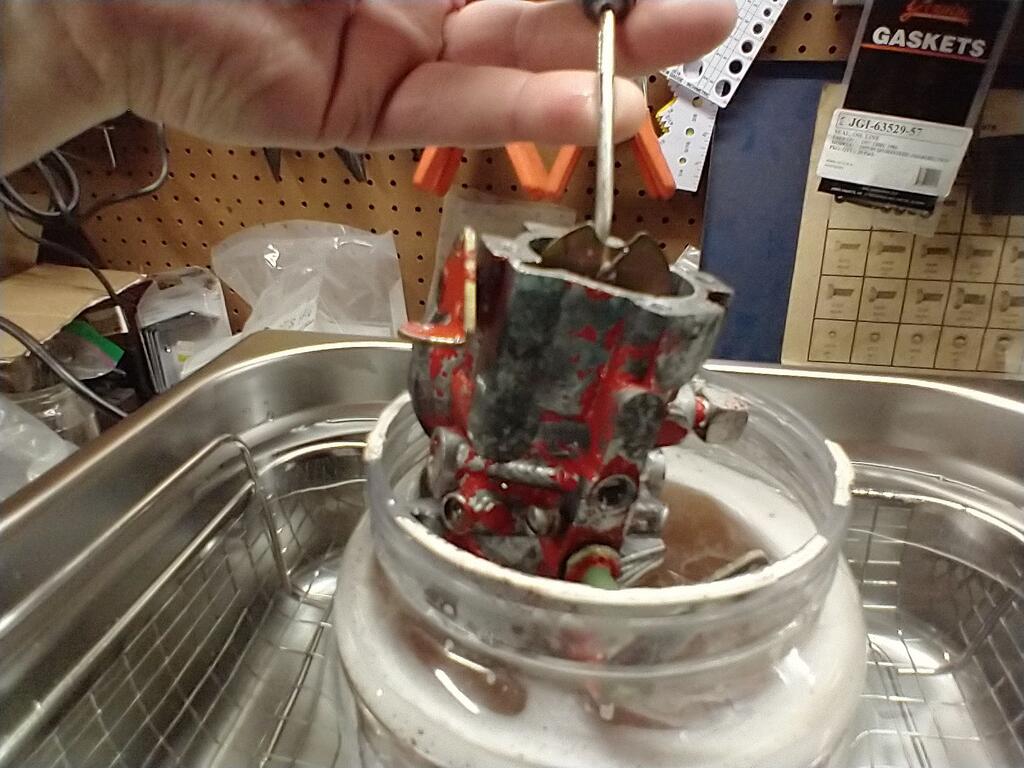

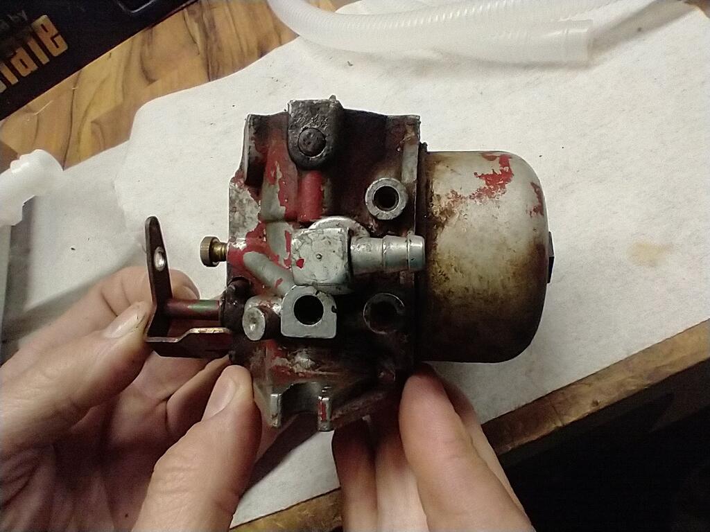

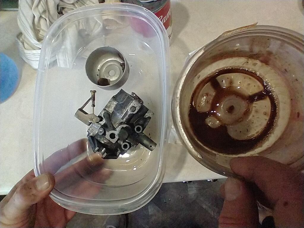

ebinmaine 80,756 #1 Posted June 9, 2023 I received a 10L manual knob ultrasonic cleaner today. Initial impressions are very good. I filled a large peanut butter jar with a Kohler carb in water with a little Pink Stuff Cleaner. Ratio maybe 10:1 ?? Dropped that in the cleaner. Filled around it with hot tap water. That was around 40⁰ C. I let it set for just a few minutes to bring the temp up more then set the machine for 30 minutes. When done the temp was 60⁰, 65⁰ or so. Here's two before and an after pic. I purposely did NO cleaning up on the carb just to see exactly what this cleaner could/could not do. Have to say. I'm impressed. I think after a good soak, a hotter bath, and maybe 2 more cycles this'll be pretty well spotless. 5 5 Share this post Link to post Share on other sites

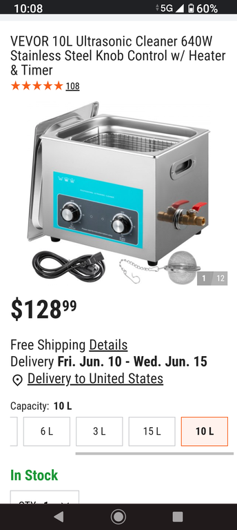

Oldskool 6,678 #2 Posted June 9, 2023 Keep the info and updates coming. The Harbor place? 2 Share this post Link to post Share on other sites
ebinmaine 80,756 #3 Posted June 9, 2023 33 minutes ago, Oldskool said: Harbor Vevor. Same thing but different. 2 Share this post Link to post Share on other sites

squonk 48,140 #13 Posted June 9, 2023 11 hours ago, ebinmaine said: Vevor. Same thing but different. And no part # or price posted! I use a cup and a half of Simple Green purple degreaser and the rest water in my Horror Fright unit. The fluid gets pretty dirty and I feel it isn't worth it to save it to use again 2 Share this post Link to post Share on other sites

ebinmaine 80,756 #16 Posted June 9, 2023 1 hour ago, squonk said: And no part # or price posted! Here ya go sir. 1 Share this post Link to post Share on other sites

ebinmaine 80,756 #24 Posted June 12, 2023 On 6/9/2023 at 1:35 PM, Retired Wrencher said: Sounds like you have a handle on it Eric. Good post by all. Not quite done with this yet but an update. Definitely impressed. As a reminder here's the before: And again I purposely did NOT do any mechanical cleaning or crud removal because I wanted to really see what it would do. This is after 3 rounds of approximately 30 minutes each and a bit of blowgun at 80 to 100 psi. Obviously the container has a fair amount of sludge in it and that doesn't include the stuff floating in the now nasty looking cleaner I dumped out. 1 1 Share this post Link to post Share on other sites
