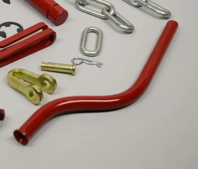

Southern_Secret 464 #1 Posted June 7, 2023 I ordered a brinly hitch and roacker shaft kit for a 314-H from WHPM. I trayed putting it on last night but im not sure what way the tube that the cable runs threw goes. When I put it the way that it seems like it fits, the bracket the holds the tube doesn't sit flush with to top of the trans. I feel like a fool, but I just want to make sure I get it on correctly. Any help would be greatly appreciated! Share this post Link to post Share on other sites
kpinnc 17,072 #2 Posted June 7, 2023 Does your cable tube have a distinct curve to it? If so, there is a hole at the forward mounting between the top two tranny bolt holes. The small end of the tube inserts there. 1 Share this post Link to post Share on other sites
Southern_Secret 464 #3 Posted June 7, 2023 It does have the curve, when I put the tube under the pump and line it up with the hole, the end with the flair is not laying flush ontop of the trans and the bracket is cockeyed. So your saying that the tube goes the that hole, not just line up with it? Share this post Link to post Share on other sites

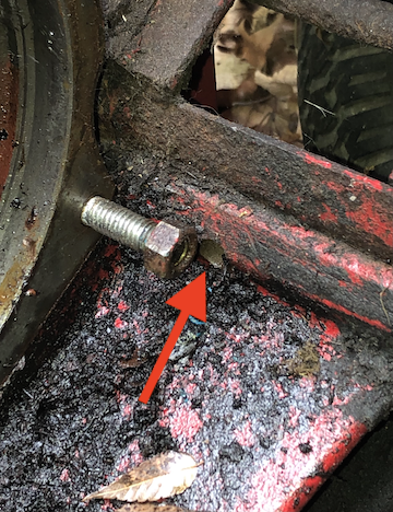

Handy Don 15,780 #6 Posted June 8, 2023 Just two quick notes: --the forward end of the tube doesn’t just “line up” with the hole, it wedges into the hole in the transaxle casting (this hole is larger than the hole in the trans plate) --be sure there is no debris along the tube’s path that is preventing it from seating properly Share this post Link to post Share on other sites
Southern_Secret 464 #7 Posted June 8, 2023 So the end of the tube does go into the hole that's in the bracket in front of the hydro pump? Share this post Link to post Share on other sites
Handy Don 15,780 #8 Posted June 8, 2023 30 minutes ago, Southern_Secret said: So the end of the tube does go into the hole that's in the bracket in front of the hydro pump? Fortunately for you I have a parts tractor with the hydro pump/motor removed. 😁 The red arrow points to the hole in the lip of the transaxle. The tube goes INTO that hole. The hole in the plate is slightly smaller, so the tube butts up against the plate. When i put a new tube in one tractor, I used a drift pin through the plate hole and casting hole and got the tube onto the end of the drift pin. That helped me align the tube to the hole and get it in. Be careful not to bend or expand the end of the tube--it is supposed to be a very snug fit and warping the tube will just make you crazy trying to get it in. 1 Share this post Link to post Share on other sites
Southern_Secret 464 #9 Posted June 8, 2023 I believe you have helped me, i thought the tube just butted up against the hole. That is probably why the other end of the tube, that is suppose to clamp to the top of the trans will not sit flush. I will find out today or tomorrow if that solves my problem. 1 Share this post Link to post Share on other sites

Southern_Secret 464 #12 Posted June 9, 2023 Issue resolved @Handy Don thank you for your insight, i got home yesterday and it was raining so i could go to the garden, so i worked on the tractor. I got my hand up in there and lined to tube up with the hole, then i took a screw driver and used the handle end and put pressure on it as i wiggled the tube. The tube popped right in the hole no problem, I would have never figured that out on my own cause the instructions dont say anything about it going in the hole. @peter lena I lined the tube and plastic on the cable with a dry graphite powder, and i will be sure to keep it cleaned out for sure. 1 Share this post Link to post Share on other sites
