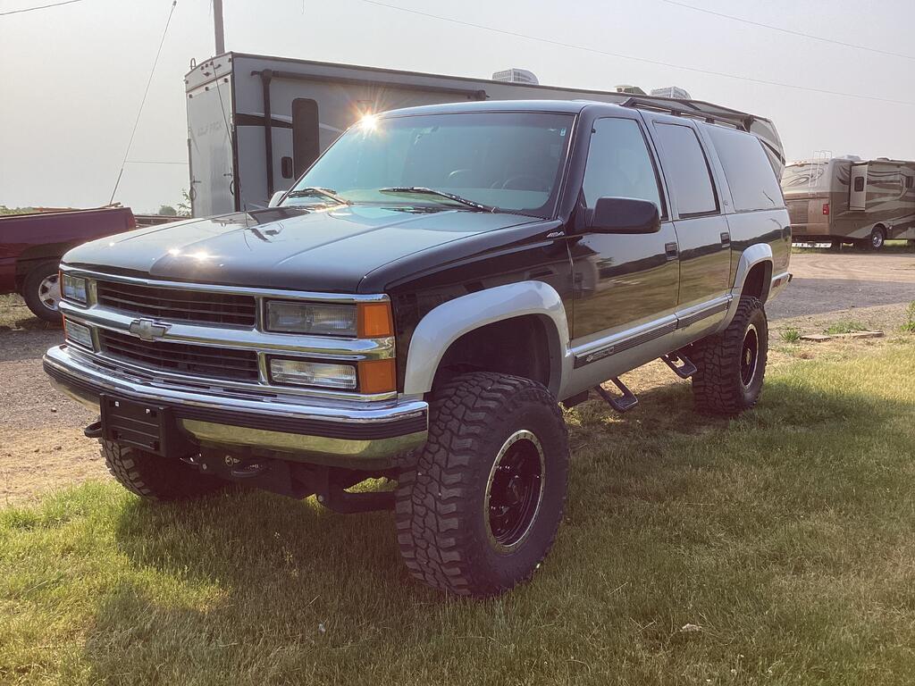

Pullstart 68,981 #1 Posted June 7, 2023 NEVER OVERLOOK THE OBVIOUS! When we bought Mrs. P’s ‘97 Suburban “DeEtte” from Colorado sight unseen, the seller told me the A/C probably needs a recharge, as it doesn’t work. Two years later, I decide to look into it. Mrs. P is on a girls trip with her mom, three aunts and grandma, so I’m sure she’ll need some excitement when she gets home. They can be hard work! I checked the pressure. It seems to have been recharged about umpteen times too many. Prepared with my meter for real troubleshooting,I decided I’d check fuses and relays. What relay? It was missing. I used a spare from the parts truck. Huh. It works! Now she can ride as cool as she looks! 7 8 Share this post Link to post Share on other sites
