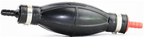

wallfish 20,510 #2 Posted June 4, 2023 Check the bottom of the carb bowl with your finger. If there fuel on it, it's leaking. Many leak but not fast enough to drip as it continues to evaporate. Fuel can also siphon back down the fuel line too. Try installing a marine primer bulb. give a squeeze or 2 before starting and the carb bowl is full instead of waiting for the pump to fill it. I've had trouble with the chinese cheapo bulbs dry rotting quickly 5 Share this post Link to post Share on other sites
kpinnc 18,886 #3 Posted June 4, 2023 If your fuel tank is not mounted above the engine, a primer bulb works wonders. Aside from the annoyance of multiple start attemps, it really saves your starter and battery life. 2 Share this post Link to post Share on other sites
SylvanLakeWH 32,141 #4 Posted June 4, 2023 (edited) Have had one on my k241 for years. Work great summer and winter... Edited June 4, 2023 by SylvanLakeWH Share this post Link to post Share on other sites
