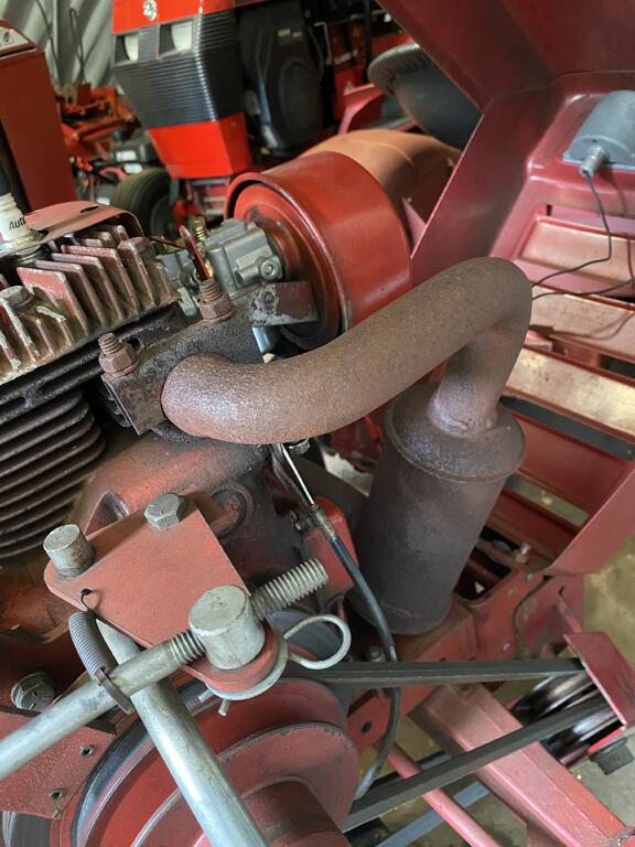

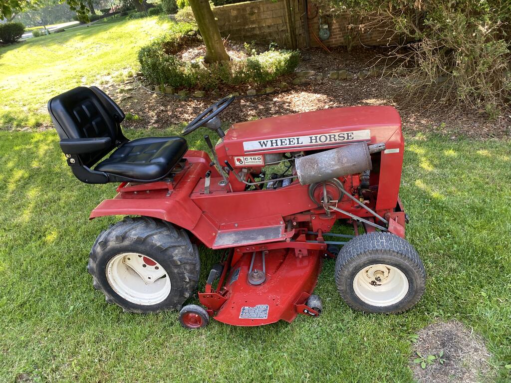

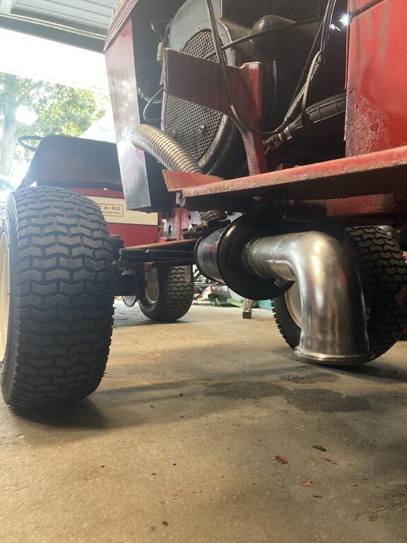

TonyBer 82 #1 Posted June 3, 2023 (edited) Bought this a few week ago on here...you may have seen it advertised here. Completely serviced and running/cutting great. This muffler has to go. What would you replace it with? E519DE68-18A7-44BE-846E-1CB5E4040F10.heic Edited June 3, 2023 by Sparky Share this post Link to post Share on other sites

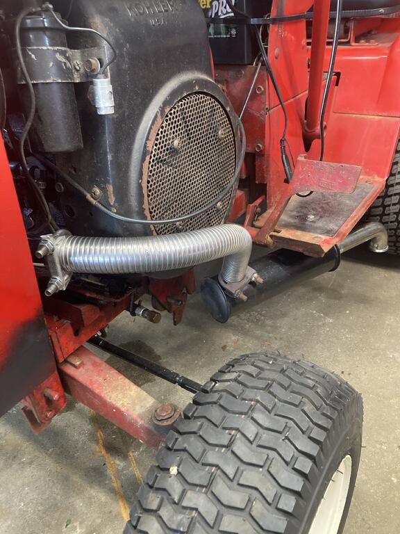

Pullstart 71,102 #3 Posted June 3, 2023 Nice looking C-160. There are options from mild to wild… depending on your taste. I prefer stacks when given the option for replacement, but they aren’t for everyone. 1 Share this post Link to post Share on other sites
Skwerl58 831 #4 Posted June 3, 2023 You have a nice exhaust on it maybe you can sell it or swap it for a muffler you like. We need to know the engine specs to give you correct factory recommendations. Tractor Supply usually has selection of mufflers 1 Share this post Link to post Share on other sites

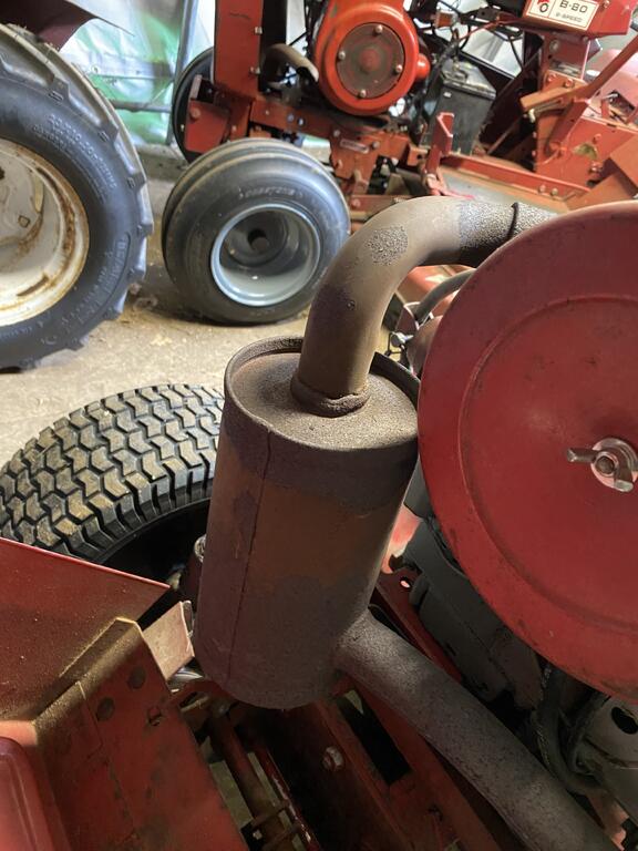

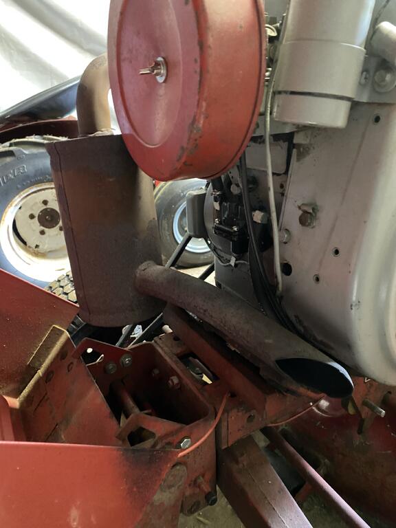

Sparky-(Admin) 26,216 #5 Posted June 3, 2023 Stacks look cool and all, but they can kinda hit you in the face with exhaust fumes more often than the low down factory setup. The factory exhaust for yours would look like this one my C-105. 2 1 Share this post Link to post Share on other sites

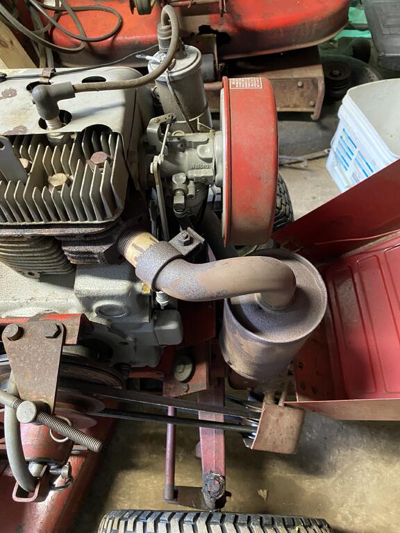

Sparky-(Admin) 26,216 #6 Posted June 3, 2023 My B-80 has a similar one, very quiet 🤫 setup when it mated to a little Kohler 8. 3 Share this post Link to post Share on other sites

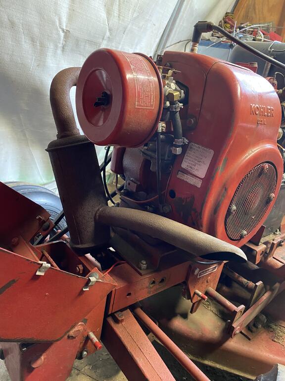

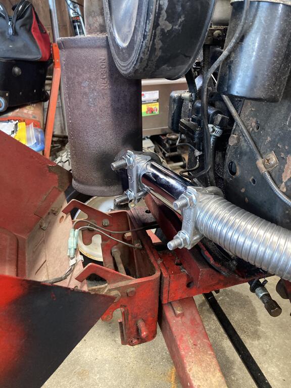

SylvanLakeWH 32,141 #8 Posted June 3, 2023 Just did this yesterday. Quiet and no fumes in your face... C-105 10 hp Kohler. 5 Share this post Link to post Share on other sites
TonyBer 82 #9 Posted June 3, 2023 (edited) 1 hour ago, Sparky said: My B-80 has a similar one, very quiet 🤫 setup when it mated to a little Kohler 8. This is the style I'd like to get. Is there a part number or name? Edited June 3, 2023 by TonyBer Share this post Link to post Share on other sites

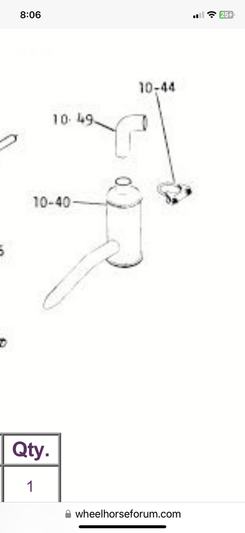

Skwerl58 831 #11 Posted June 4, 2023 Lots of people check out the Gravely and Cub Cadet mufflers for these engines because they are spec'd differently. You may need to get the additional hardware to mount the muffler to your engine. Also parts vendors sell replacement mufflers for the Kohler K series that should work. Check this one out at isavetractors: https://isavetractors.com/muffler-for-kohler-k241-k301-k321/ Share this post Link to post Share on other sites

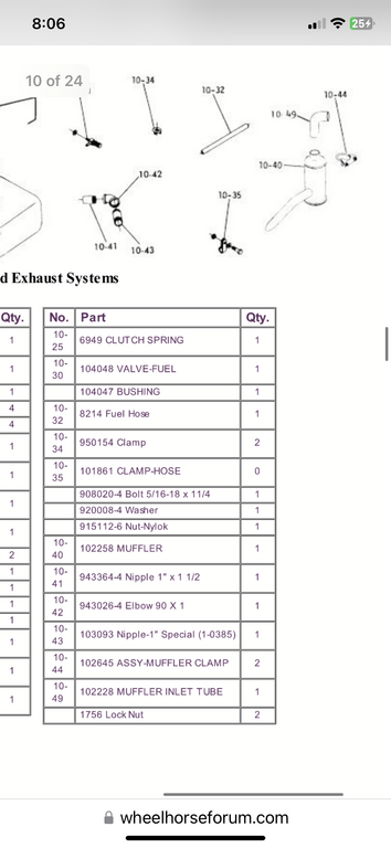

Sparky-(Admin) 26,216 #12 Posted June 4, 2023 3 hours ago, TonyBer said: This is the style I'd like to get. Is there a part number or name? For your machine I think this is it. If a new one was found it would be expensive I suspect. But a good condition used one should be easier to source. 2 Share this post Link to post Share on other sites
Monstrosity 1,153 #13 Posted June 4, 2023 14 hours ago, SylvanLakeWH said: Just did this yesterday. Quiet and no fumes in your face... C-105 10 hp Kohler. I like this idea mainly for my son!! 1 Share this post Link to post Share on other sites
Treepep 1,150 #14 Posted June 7, 2023 On 6/3/2023 at 3:38 PM, SylvanLakeWH said: Just did this yesterday. Quiet and no fumes in your face... C-105 10 hp Kohler. Wow! very nice! Grab a cold one and de ice the driveway too! Not the fastest but... 1 Share this post Link to post Share on other sites
