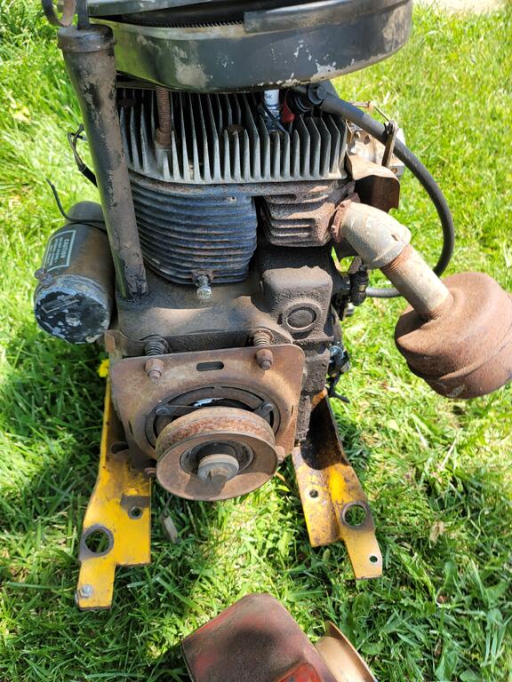

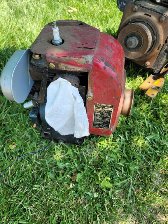

dotcomdz 49 #1 Posted June 2, 2023 A guy had these said he couldn't get running, but I don't think his operation to great, I think he was just working them no bench etc. Since I'm new to this whole situation, before I mess with them what are the things to NOT do because of hard to find parts if any. I think the one came off cub. The other one is red so that one good question😅 Share this post Link to post Share on other sites
23 Reo 235 #3 Posted June 2, 2023 What are the model numbers? Share this post Link to post Share on other sites
kpinnc 17,908 #4 Posted June 2, 2023 I see the red one is a K181. Can't tell on the other. Share this post Link to post Share on other sites
dotcomdz 49 #5 Posted June 3, 2023 Quote I will check but I'm pretty sure the one he said was off a cub came off a john deere because it has oil sump on bottom. If what I thought those kohler were made for John deere is that correct? Share this post Link to post Share on other sites
oliver2-44 11,401 #6 Posted June 3, 2023 21 hours ago, dotcomdz said: , before I mess with them what are the things to NOT do because of hard to find parts if any. Most parts are readily available, especially aftermarket (except some for the K141,k161) Because these may have been sitting awhile, spray some oil down the spark plug hole to lube the rings and turn it over as you work on them. Share this post Link to post Share on other sites
oliver2-44 11,401 #7 Posted June 3, 2023 1 minute ago, dotcomdz said: Quote I will check but I'm pretty sure the one he said was off a cub came off a john deere because it has oil sump on bottom. If what I thought those kohler were made for John deere is that correct? I think Cub also used a oil pan with a lower sump on it. but JD definitely did. 2 Share this post Link to post Share on other sites
RandyLittrell 3,944 #8 Posted June 5, 2023 On 6/3/2023 at 8:57 AM, oliver2-44 said: I think Cub also used a oil pan with a lower sump on it. but JD definitely did. They did, it looks like an AQS spec K series from a spread frame tractor. Randy 1 Share this post Link to post Share on other sites
dotcomdz 49 #9 Posted June 7, 2023 The smaller one he said had no spark🤦🤷 he didn't use a coil when he tried just did points and condenser then tried to start it like you see it Share this post Link to post Share on other sites
