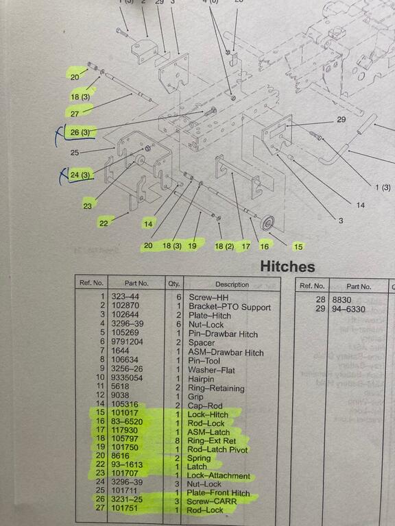

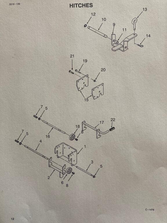

wallfish 20,744 #12 Posted June 1, 2023 That front mule drive is not specific to that 312. It's a very common part here in the US and on many European Wheel Horse tractors Many many models used that same exact part from 1973 - 1990s. Easiest to find it as an entire assembly. If you see one that looks the same it's probably good. There are some European members here that you can try contacting those guys from. If all else fails, I'll send you one. 1 Share this post Link to post Share on other sites

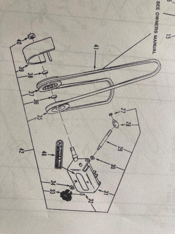

gwest_ca-(File Mod) 12,557 #13 Posted June 1, 2023 The parts in this picture are part of the mower deck. The rest are part of the tractor. 1 Share this post Link to post Share on other sites

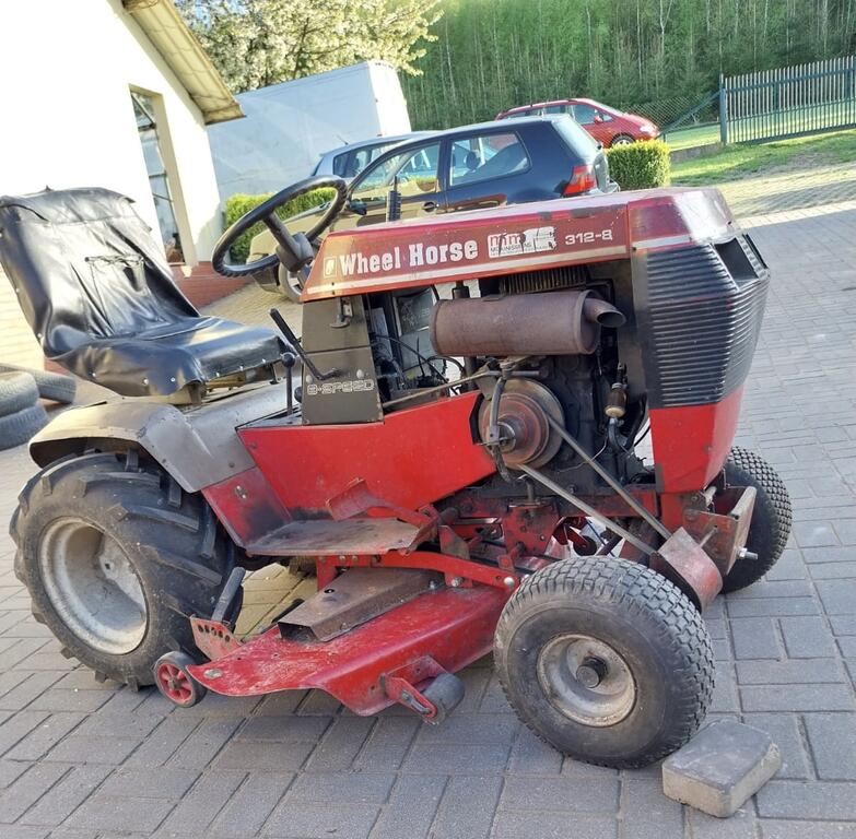

Rick3478 478 #16 Posted June 2, 2023 On 6/1/2023 at 10:26 AM, agnes said: I wonder what model it might be I need to figure this out because I'm looking for parts The red hood decals were used until about 1989, I think. Whatever happened to your rear fender pan probably destroyed the model and serial tag. What do y'all think, 21-12K804 maybe? Share this post Link to post Share on other sites
kpinnc 19,109 #17 Posted June 3, 2023 7 hours ago, Rick3478 said: What do y'all think, 21-12K804 maybe? Possibly... Get a pic of the whole dash area. Might help narrow it down. The hood decals make me think 1986-89 maybe? Share this post Link to post Share on other sites
