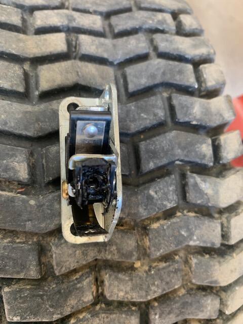

Skintraditions 6 #1 Posted May 31, 2023 (edited) UPDATE IT WAS THE COIL GUYS THANKS FOR THE INPUT Hey guys needing some help again , I gotta c-160 when I received it it was missing all the electronics ,I ordered points coil and condenser ,well after wiring it up before I put a switch on it I wanted to see if it would fire off with just the battery well I've melted 2 sets of points . I do not have a switch wired yet I was using a battery and hooking everything up other than the ignition wire with i have a gator clip on it so it's just straight wired while I'm testing for spark but I've checked and double checked the wiring from the points to the coil and the condenser to the coil but as soon as I hook up the straight wired to the battery and jump the solenoid it starts smoking, now with that said I did not replace the coil because i had a old one and didnt want tonwait on the coil to come in , could the coil cause that ? Or do I need the key switch to test .I wouldn't think so as my Troy built work horse tiller I just jump it off cause it need wired up for a switch and a batter too . Here's my wiring layout ...points to coil on the negative side and so is the condenser and the positive side of the coil I have a wire with a clamp on the other end for the positive side of the battery . Any idea where to look ? Edited June 1, 2023 by Skintraditions 1 Share this post Link to post Share on other sites

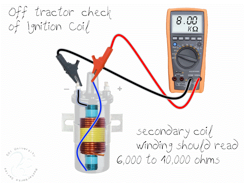

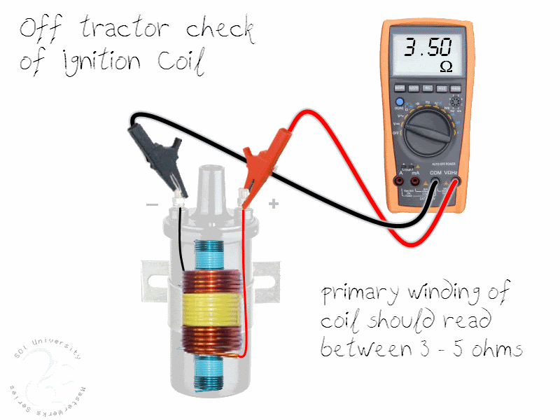

pacer 3,179 #7 Posted May 31, 2023 While on this topic ..... Is there a way to ...determine? it a coil has an internal resistor or not?? Like the poster @Skintraditions I usually have 3-4 coils laying around with unknown type internals. 1 Share this post Link to post Share on other sites
Pullstart 68,782 #8 Posted May 31, 2023 1 hour ago, pacer said: While on this topic ..... Is there a way to ...determine? it a coil has an internal resistor or not?? Like the poster @Skintraditions I usually have 3-4 coils laying around with unknown type internals. @953 nut? I’m sure you have a resistance valuetucked away somewhere? 2 Share this post Link to post Share on other sites
953 nut 63,985 #9 Posted May 31, 2023 @Skintraditions As others have said it could be the points are not opening or it could be the wrong ignition coil.If you are unfamiliar with gapping a set of points I save Tractors has some youTube videos worth watching. @Save Old Iron posted some drawings to help you determine if your coil is correct. 5 1 1 Share this post Link to post Share on other sites
