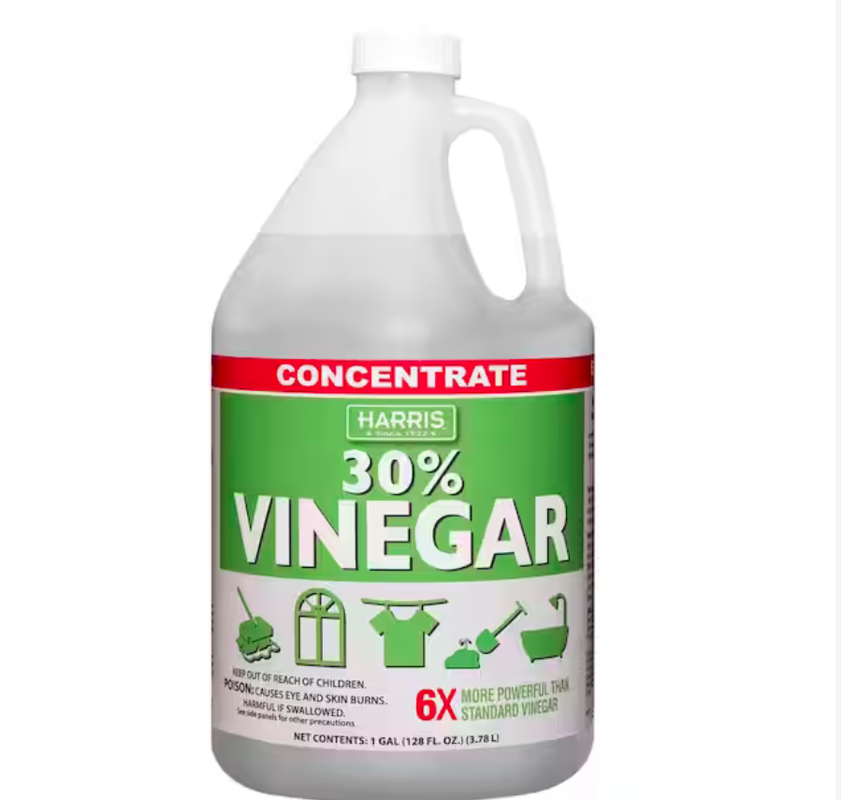

bc.gold 3,406 #4 Posted May 30, 2023 I've discovered how to make new friends, having the only mower in the neighbourhood that runs. After cutting five lawns its time to re-torque the cylinder head bolts. Also parked the mower out of sight. Pat's Briggs boxer is next to do, the fuel tank has a lot of varnish inside I'll give it a shot of Xylene solvent. Share this post Link to post Share on other sites
bc.gold 3,406 #5 Posted June 8, 2023 The extra strength cleaning vinegar did a much better job with the fuel tank. Share this post Link to post Share on other sites
