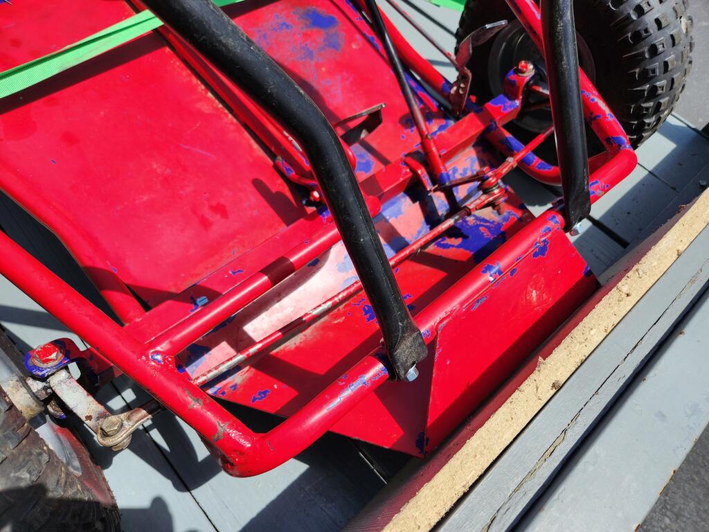

Racinbob 12,507 #1 Posted May 30, 2023 Last summer our son in law picked up a go kart that wasn't running right with ideas of fixing it up for the grandkids. The guy he got it from said it probably would be best to just get another engine for it rather than mess with the one that was on there. He bought a DuroMax engine, disassembled everything and that's as far as he got. It was never even mentioned to me until a couple of weeks ago when our grandson asked me if maybe I could get the go kart going. Well, you know the answer to that. The DuroMax was an electric start and a no go physically without cannibalizing it. I decided to get a Predator 212 and it is a great fit. It didn't take long before I realized why these engines are so popular. The drive was a basket case Comet Industries clutch and variable torque unit which I discovered is very popular in the go kart/mini bike world. I had never had my hands on one before so it was a learning process that I found interesting. Things are all back together now and I'm just waiting on a new drive belt which should get here today. OK, all that and I didn't get to the point. I'll be hauling the kart and the no longer returnable DuroMax back to their place and I'll have this Tecky engine sitting here. Something tells me I shouldn't just toss it out. Maybe a carb rebuild is all it needs. Maybe not. The shaft is fine for a Wheel Horse and there looks to be a 12v output even though it's a recoil start. I believe it was for the lights only. Here's the tag on it. Anybody interested in seeing if it can be saved? 2 Share this post Link to post Share on other sites
oliver2-44 11,137 #2 Posted May 30, 2023 @Racinbob, like your handle, we know you want to put the pedal to the medal on that cart! Of course we need a video of that. You've got to shake it down before its returned to the grandkids! Regarding that Tecumseh, I would love to see you go through it. I have an older H60 I need to get running, been avoiding it since its not a Kohler. I need all the Tecky inspiration I can get 1 Share this post Link to post Share on other sites

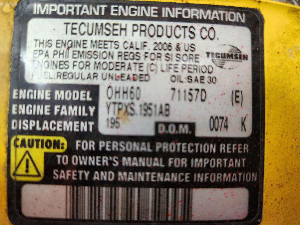

Racinbob 12,507 #3 Posted May 30, 2023 2 hours ago, oliver2-44 said: @Racinbob, like your handle, we know you want to put the pedal to the medal on that cart! Of course we need a video of that. You've got to shake it down before its returned to the grandkids! Regarding that Tecumseh, I would love to see you go through it. I have an older H60 I need to get running, been avoiding it since its not a Kohler. I need all the Tecky inspiration I can get Usually I'd say you're 100% right and I did attempt i just a short time ago. I was going to get on the road and clock it with GPS but before I even got to the end of the drive at partial throttle I backed off and turned around. This thing is scary dangerous. Not because of the speed but because of the steering. It goes far beyond horrible. We loaded it on the trailer to take it back but most likely the boys won't be driving it. It's so bad that theres no doubt in my mind that they would get hurt. I'm already looking into steering kits but that's yet another learning process for me. As far as the Tecky goes I was hoping to get it in somebody else's garage that wanted to tinker with it. I know nothing about them and really don't care to learn. 2 Share this post Link to post Share on other sites

Handy Don 15,630 #7 Posted May 30, 2023 The OHH60 is the overhead valve version of the HH60 (6hp). These had adjustable valves, cast iron sleeves, and ball bearings at the PTO end of the crank. Pretty solid. Yes, Tecumseh put a 3 amp stator in these since a common target market was something with lights, like a snowblower. Yes, the carbs can be finicky, especially if neglected and left with fuel in them to evaporate and gum up. Personally, I hate to abandon engines so I’d at least give the carb a good soak or dunk in the ultrasonic tank, if you have one. The rebuild kits are cheap and a complete aftermarket carb isn’t a lot more. One of these would be a reasonable replacement on a 604 or a ’64-68 Lawn Ranger worker or a mini-bike on go-kart. 1 Share this post Link to post Share on other sites
