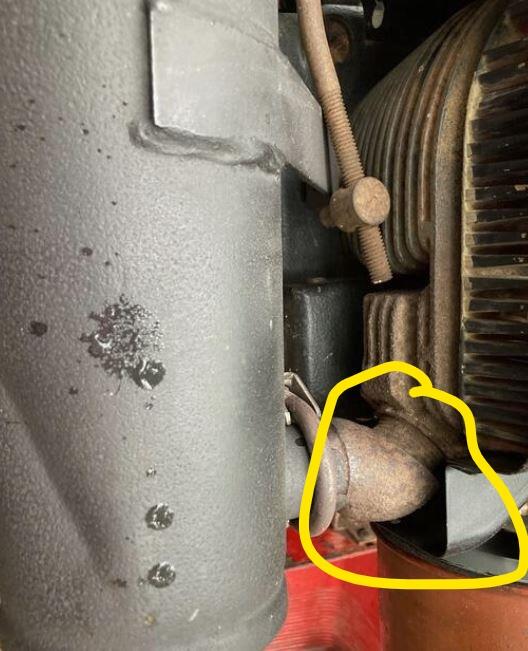

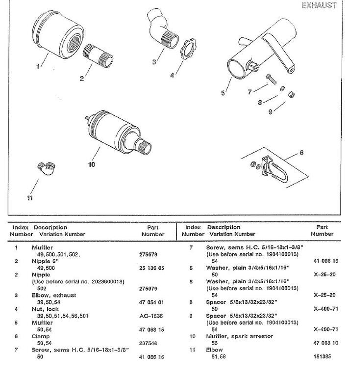

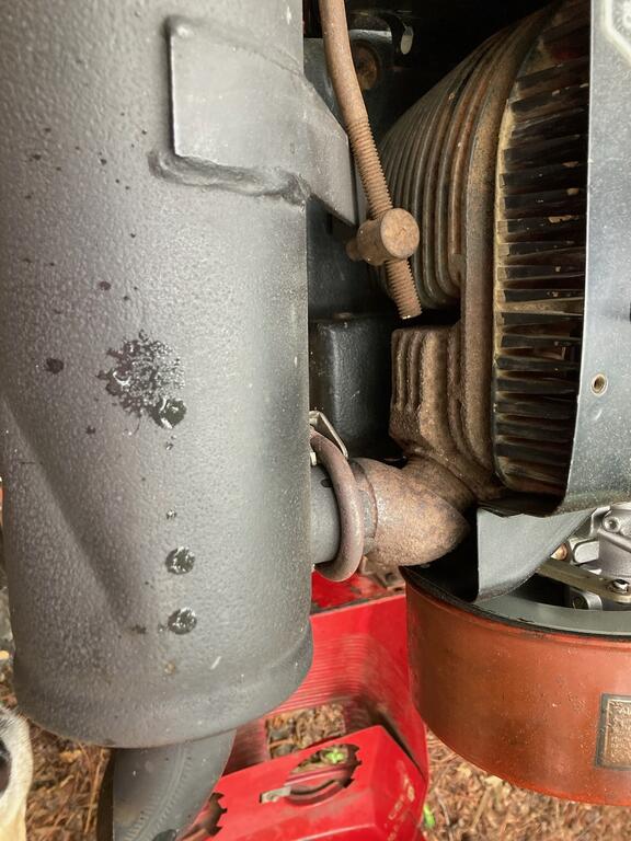

pfrederi 21,303 #3 Posted May 29, 2023 It is a Magnum big bock elbow. Part # is 47 054 01 When you find them the seem to be made out of a precious metal +/- $40 4 1 Share this post Link to post Share on other sites
ineedanother 2,885 #4 Posted May 30, 2023 2 hours ago, pfrederi said: It is a Magnum big bock elbow. Part # is 47 054 01 When you find them the seem to be made out of a precious metal +/- $40 Apparently precious metal 1 Share this post Link to post Share on other sites
Wheel-N-It 2,978 #5 Posted May 30, 2023 May be time for a stack on that one ??? Will it work? 1 1 Share this post Link to post Share on other sites

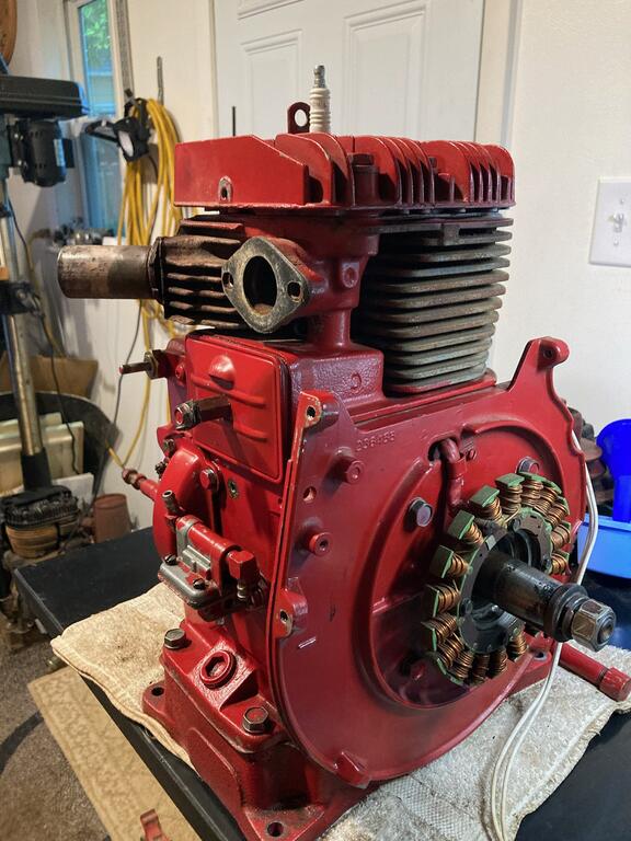

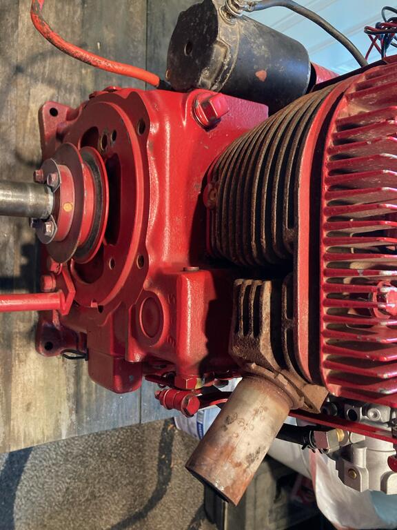

RED-Z06 2,720 #6 Posted May 30, 2023 Why do you feel like the stator has been hand wound? 1 Share this post Link to post Share on other sites
ineedanother 2,885 #7 Posted May 31, 2023 22 hours ago, Wheel-N-It said: May be time for a stack on that one ??? Will it work? A stack would work but I'm just not big on them. Personal preference I guess... I much prefer as a rule for things to be understated and outperform expectations and stacks run contrary to that IMO...just my opinion though and considering that this is a 300 series, I would rather speak softly and... 2 1 Share this post Link to post Share on other sites

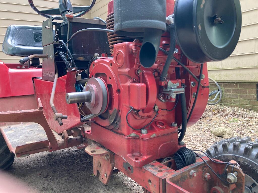

ineedanother 2,885 #8 Posted May 31, 2023 21 hours ago, RED-Z06 said: Why do you feel like the stator has been hand wound? This pic might not be clear enough but if you can zoom in, you will see. My first clue, and a reason for wanting to pull the flywheel was that both wires were white. It looks like decent work but something I've not done so I'm optimistic but a bit skeptical. 1 Share this post Link to post Share on other sites
RED-Z06 2,720 #9 Posted May 31, 2023 (edited) 38 minutes ago, ineedanother said: This pic might not be clear enough but if you can zoom in, you will see. My first clue, and a reason for wanting to pull the flywheel was that both wires were white. It looks like decent work but something I've not done so I'm optimistic but a bit skeptical. I mean its possible. Stator just looks typical kohler Edited May 31, 2023 by RED-Z06 1 Share this post Link to post Share on other sites

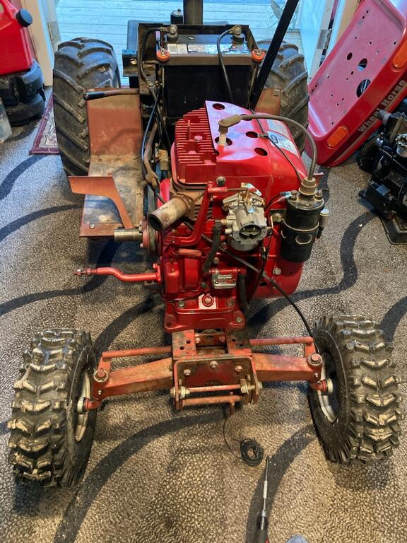

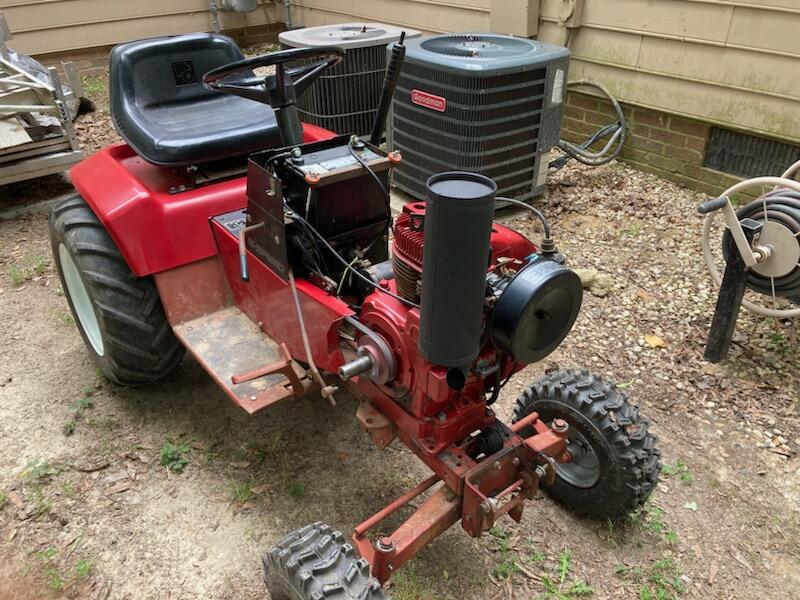

ineedanother 2,885 #10 Posted May 31, 2023 I swapped out the choke lever and found a bracket for the cable to run from underneath which should work fine with the dash on the 310. I'll likely pull the manual fuel pump on this motor since there's an electric one on that chassis so I think I'm in working order at least. I'll figure the exhaust out at some point and run without a hood for a while if I need to. 2 Share this post Link to post Share on other sites

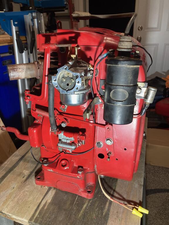

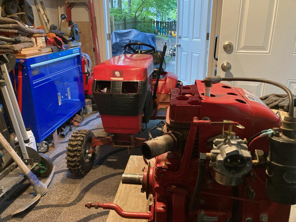

ineedanother 2,885 #12 Posted June 1, 2023 Well, time for a transplant. I really wish the M10 was up to the task because this means changing the wiring harness out to the original too but it's the right thing to do. A lot of work for a wagon-toter but it gets used quite a bit and the magnum is worth a rebuild and something down the road IMO. 1 1 Share this post Link to post Share on other sites
Wheel-N-It 2,978 #13 Posted June 2, 2023 Thats going to be a nice tractor !!! 1 Share this post Link to post Share on other sites

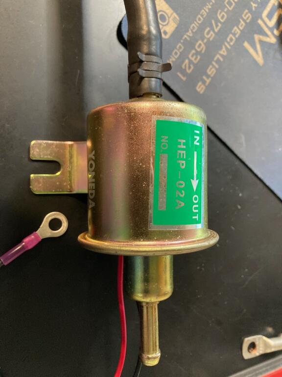

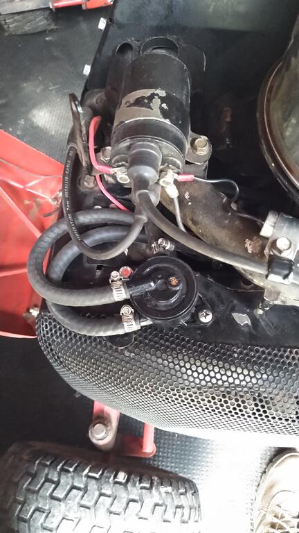

ineedanother 2,885 #14 Posted June 3, 2023 I had a little time today so I managed to swap the M10 out for the 241. It took a bit because well, I just don't seem to do anything quickly I decided early on to just make a new wiring harness and I use heat shrink and tend to make that a tedious task because I don't want it to look like some of the crap I've acquired. It's done and I'm good with it. I ran into a bit of an issue too with the electric fuel pump. I couldn't get the float to seat so I switched back to a manual pump and it works just fine. I swapped the throttle cable and still need to cut it and figure something out the exhaust but it runs well and will be a great worker Here is the pump that just seems to have too much pressure for a carb from isavetractors: 1 1 Share this post Link to post Share on other sites
RED-Z06 2,720 #15 Posted June 3, 2023 10 minutes ago, ineedanother said: I had a little time today so I managed to swap the M10 out for the 241. It took a bit because well, I just don't seem to do anything quickly I decided early on to just make a new wiring harness and I use heat shrink and tend to make that a tedious task because I don't want it to look like some of the crap I've acquired. It's done and I'm good with it. I ran into a bit of an issue too with the electric fuel pump. I couldn't get the float to seat so I switched back to a manual pump and it works just fine. I swapped the throttle cable and still need to cut it and figure something out the exhaust but it runs well and will be a great worker Here is the pump that just seems to have too much pressure for a carb from isavetractors: Every time ive tried to use a 2-4 psi pump on a kohler i ended up going back to mechanical, my M12 can sit a month and kick off on 2 or 3 revolutions so thats fine 1 Share this post Link to post Share on other sites
ineedanother 2,885 #16 Posted June 4, 2023 (edited) 4 hours ago, RED-Z06 said: Every time ive tried to use a 2-4 psi pump on a kohler i ended up going back to mechanical, my M12 can sit a month and kick off on 2 or 3 revolutions so thats fine Well, the M10 I transplanted earlier from a non-running parts tractor that according to the PO "just needed a fuel pump" had a fuel pump that had clearly been molested and I suspect that it likely dumped fuel into the crank case at some point. Not catastrophic but serious enough to require a rebuild so I thought going electric would eliminate that risk with this and others I have. I might be making more out of this than is warranted though. Edited June 4, 2023 by ineedanother 1 Share this post Link to post Share on other sites

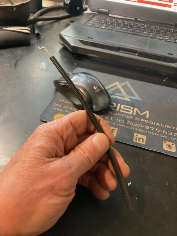

ineedanother 2,885 #17 Posted June 4, 2023 The exhaust isn't resolved yet but I cut a throttle cable (something I generally never want to do given their cost) and got that working well The muffler works for the time being but will need to have a permanent solution so the hood can go back on. Other than that it runs well and will get to work. 1 Share this post Link to post Share on other sites
bds1984 1,519 #18 Posted June 7, 2023 If you are using an electric pump, I'd bypass the mechanical pump all together. You wont have to worry about fuel dumping into the crankcase again. 2 Share this post Link to post Share on other sites
Wheel-N-It 2,978 #19 Posted June 7, 2023 On 6/3/2023 at 9:10 PM, ineedanother said: Well, the M10 I transplanted earlier from a non-running parts tractor that according to the PO "just needed a fuel pump" had a fuel pump that had clearly been molested and I suspect that it likely dumped fuel into the crank case at some point. Not catastrophic but serious enough to require a rebuild so I thought going electric would eliminate that risk with this and others I have. I might be making more out of this than is warranted though. I think you did the right thing by going back to a mechanical pump. Those old Kohler's were designed to run a mechanical pump, so that's what you should stick with if at all possible ( especially the old style metal rebuildable pump like you have here) 1 Share this post Link to post Share on other sites
davem1111 2,444 #20 Posted June 8, 2023 23 hours ago, bds1984 said: If you are using an electric pump, I'd bypass the mechanical pump all together. You wont have to worry about fuel dumping into the crankcase again. That's what I did on both my 312-A and the 416-8 I sold recently. I've been pretty happy with the 12v pumps. 1 Share this post Link to post Share on other sites
ineedanother 2,885 #21 Posted June 8, 2023 On 6/6/2023 at 9:39 PM, bds1984 said: If you are using an electric pump, I'd bypass the mechanical pump all together. You wont have to worry about fuel dumping into the crankcase again. That's really why I would prefer to go with electric but the one I have must generate just a bit too much pressure. I'll probably try another type. When I was using the electric pump I removed the mechanical pump altogether and covered the hole in the block with a metal plate and gasket. 1 Share this post Link to post Share on other sites
squonk 48,325 #22 Posted June 8, 2023 (edited) I have a Napa 619-1051 pump on 2 Kohler's with no issues. And the stator looks factory and both wires are white on many of them. Edited June 8, 2023 by squonk 1 Share this post Link to post Share on other sites
bds1984 1,519 #23 Posted June 8, 2023 3 hours ago, ineedanother said: That's really why I would prefer to go with electric but the one I have must generate just a bit too much pressure. I'll probably try another type. When I was using the electric pump I removed the mechanical pump altogether and covered the hole in the block with a metal plate and gasket. I did a very similar set-up on a C175 a couple years ago. I didn't like how the electric pump was making my volt gauge flutter so I put a vacuum nipple on the mechanical pump block off plate and used a Briggs style vacuum pump. Two years late it is still working fine. 1 Share this post Link to post Share on other sites
Bill D 3,193 #24 Posted June 10, 2023 On 6/8/2023 at 10:11 AM, bds1984 said: I did a very similar set-up on a C175 a couple years ago. I didn't like how the electric pump was making my volt gauge flutter so I put a vacuum nipple on the mechanical pump block off plate and used a Briggs style vacuum pump. Two years late it is still working fine. I did the same thing ony KT 17. So far it's working great. 1 Share this post Link to post Share on other sites

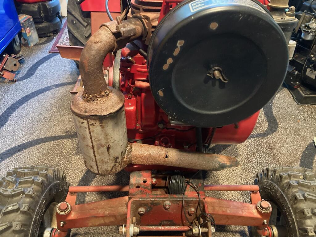

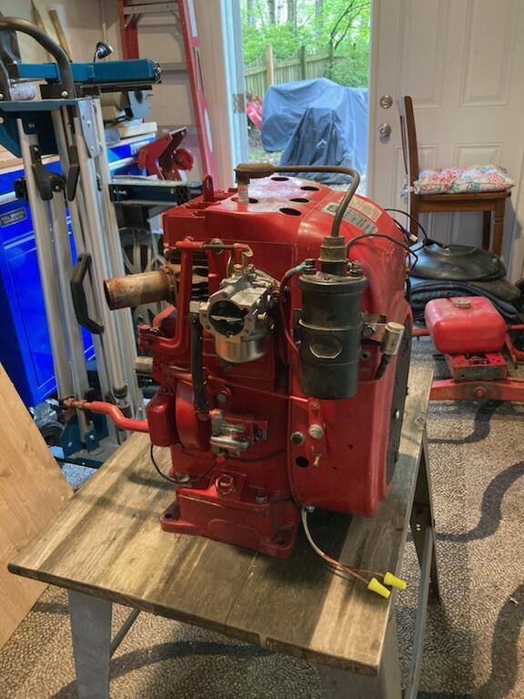

ineedanother 2,885 #25 Posted June 13, 2023 The mechanical pump is working fine and I have a rebuild kit on the shelf for it if I ever need one so it's staying for now. I had this beat up Nelson stuck in a corner and I think it's going to work. It needs a bit of work but the hood goes on and I think I can get the cancer sealed up well enough to suit my ears. 1 1 Share this post Link to post Share on other sites
