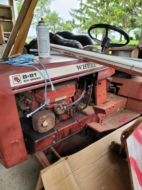

dotcomdz 49 #1 Posted May 28, 2023 I have one and it runs if I start with a drill but electrical is messed up or frozen starter. My question is I have a 12.5hp 1998 steel sleeve commercial briggs that runs great. Is it possible to swap such a large motor, has anyone done that and is it over kill? Share this post Link to post Share on other sites

dotcomdz 49 #5 Posted May 28, 2023 (edited) Main reason is I know the 12.5hp is a beast good well maintained engine. I was thinking of the swap to then give it to my younger cousin. I know nothing of this engine other than it runs, probably a massive amount of hours, probably will need carb work etc.... I mean I know I can just go buy a starter or maybe even clean the whole system up. I don't want to do that so that's why I was asking thoughts on possibilities other wise I'm just going to sell it like it is put the 12.5 on another GT I have Edited May 28, 2023 by dotcomdz Share this post Link to post Share on other sites
953 nut 69,844 #6 Posted May 29, 2023 10 hours ago, dotcomdz said: I was asking thoughts on possibilities No problem, your , your choice on what to do withit, Since your B-80 is equipped with a B&S already there should be a great deal of similarity between your two engines. First thing to look at is the crankshaft where the pullies mount, If that is the sane then in all likelihood the engine swap won't bee too challenging at all. 1 1 Share this post Link to post Share on other sites
