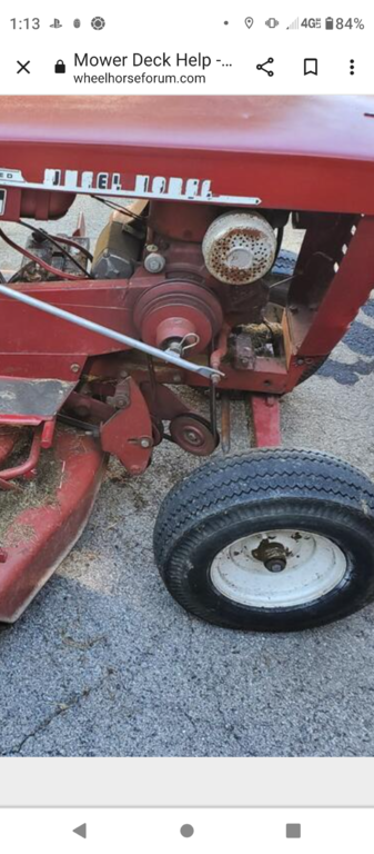

jtrosp1980 89 #1 Posted May 27, 2023 (edited) I have replaced everything that makes this work but still can't keep in place is this normal and if so any ideas how to keep on the guide for deck Edited May 27, 2023 by jtrosp1980 Added Pic Share this post Link to post Share on other sites
953 nut 63,340 #2 Posted May 27, 2023 It appears that you have the belt on the small outer pulley of your PTO. Move it to the large pulley and it will line up properly/ 1 1 Share this post Link to post Share on other sites
wallfish 18,818 #3 Posted May 27, 2023 It might be one of those decks and setups that required a 6 sided belt. A flat back part of the belt should not go into the groove of a V pulley. That rear pulley looks like it's a V . @gwest_ca had posted something before on a 6 sided belt 1 Share this post Link to post Share on other sites

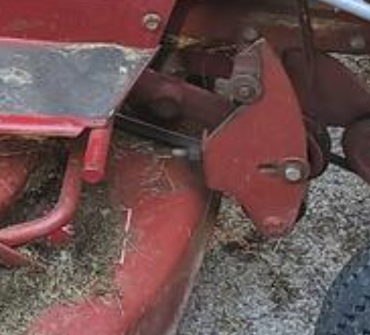

jtrosp1980 89 #4 Posted May 28, 2023 The guide jumped off the drive the second pic the belt stays on PTO it jumps at the mule drive Share this post Link to post Share on other sites
Ed Kennell 43,933 #5 Posted May 28, 2023 Is the belt too long? It appears the tensioner pulley is maxed out in the slot. Share this post Link to post Share on other sites
