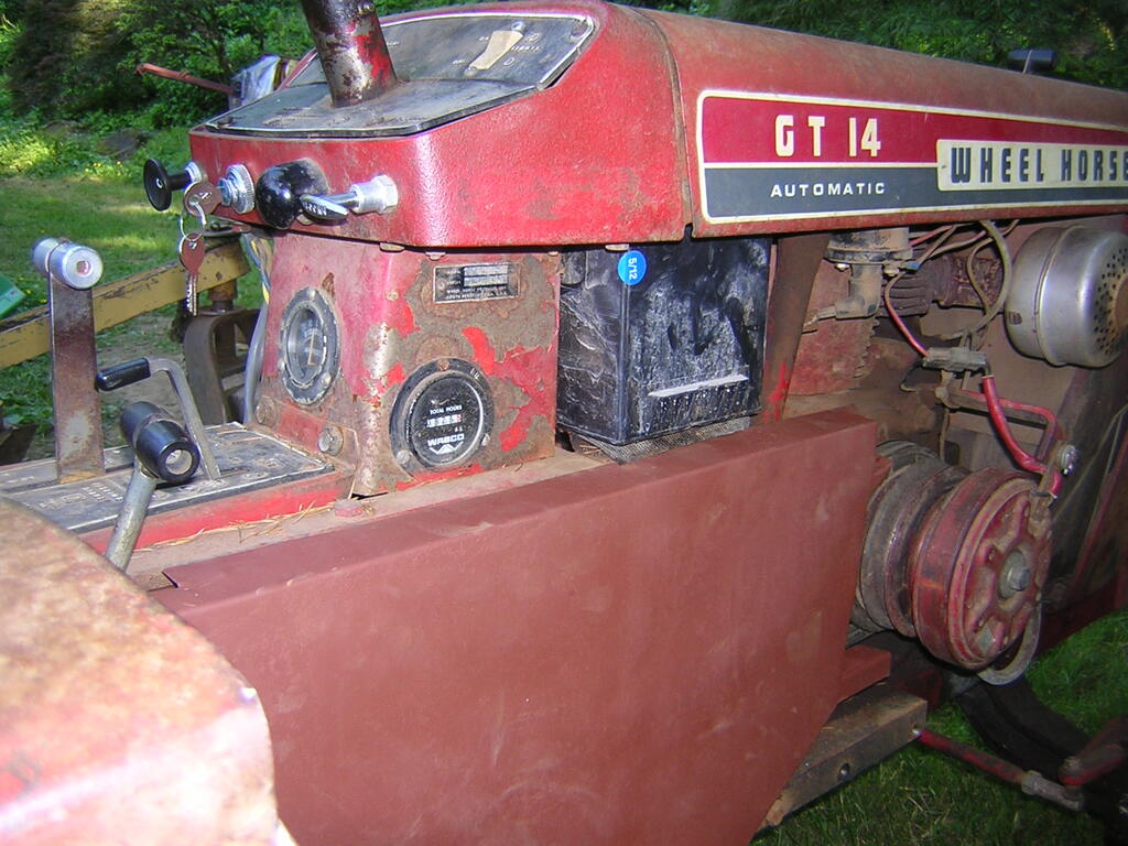

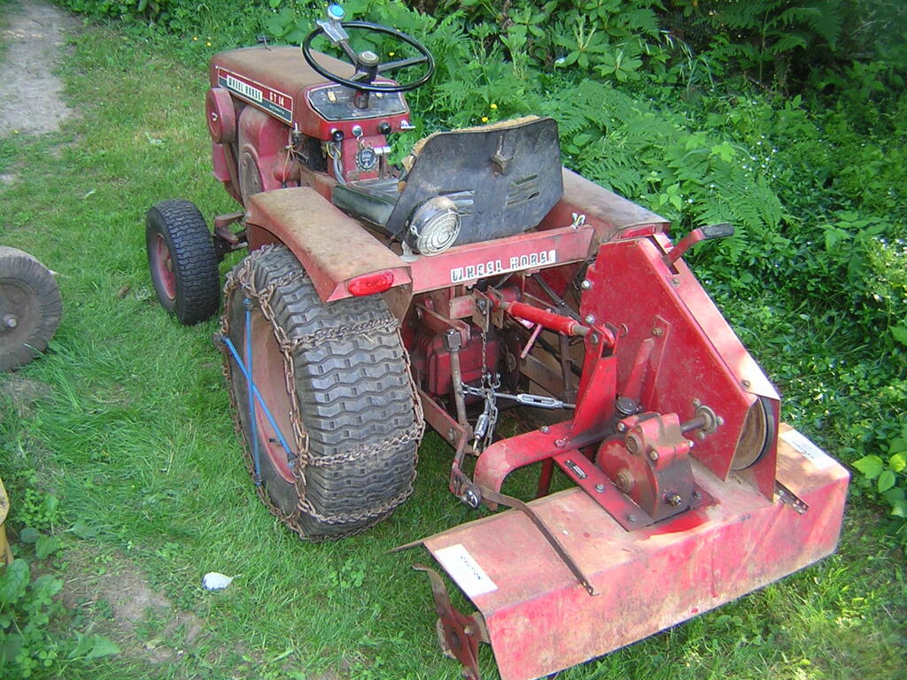

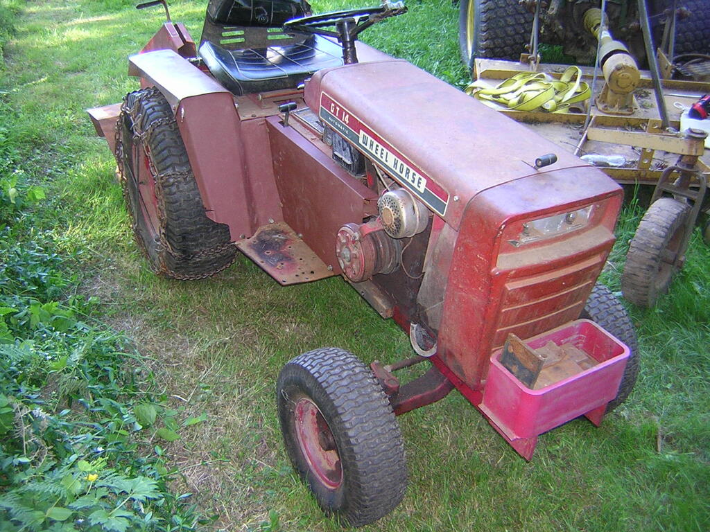

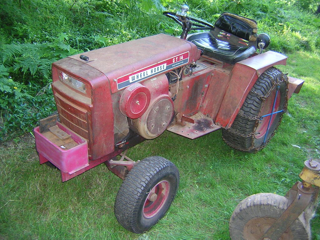

fullchoke 22 #17 Posted May 30, 2023 I got all of the fluids and filters changed. Removed the sickle bar mower, as I don't have any use for that. Mounted the tiller. Just drove it around to my back yard, but haven't done any work with it yet. The engine seems strong...no smoke, but it only has 826 hours on it so it should have quite a bit of life left. Thinking about how much use I'm going to get out of it makes me think I probably should consider selling it. This is the only GT-14 I have seen so I don't know how much it's worth out here in Oregon. Liking vintage equipment was my only real reason for buying it in the 1st place. I promised a photo or 2, so here they are. Thanks for the help in getting this little tractor going again. 1 2 Share this post Link to post Share on other sites
