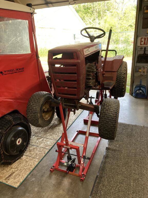

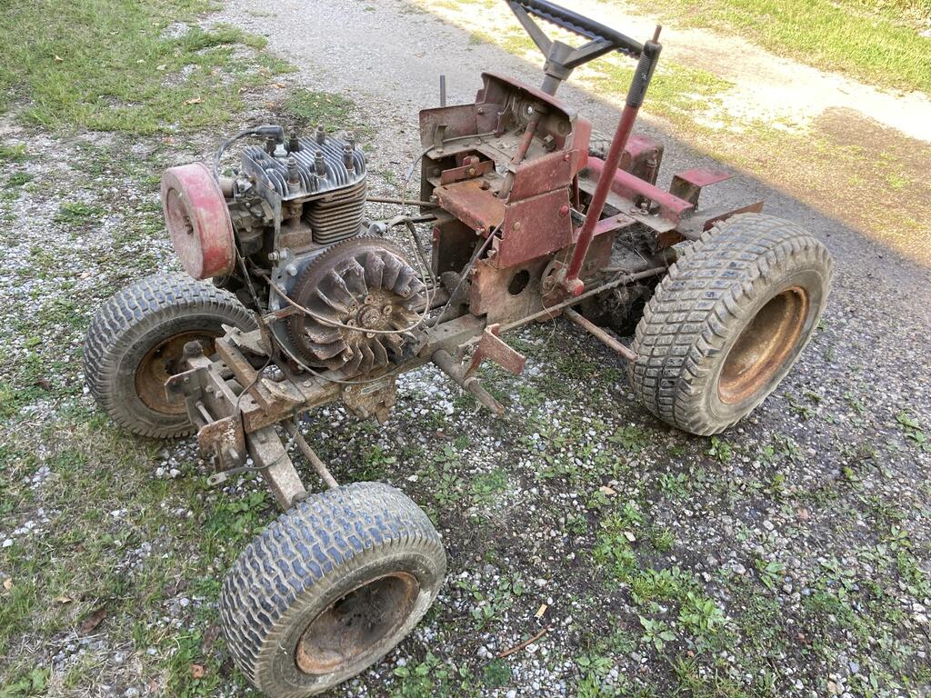

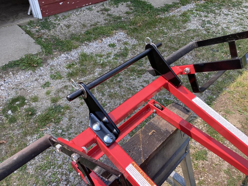

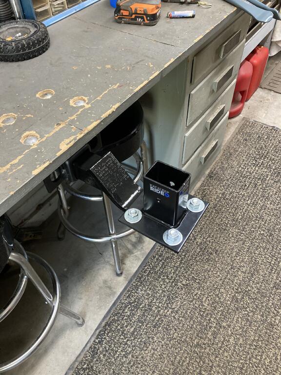

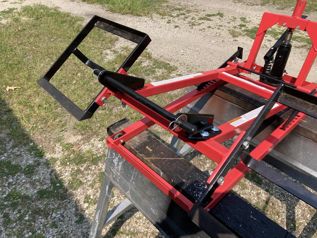

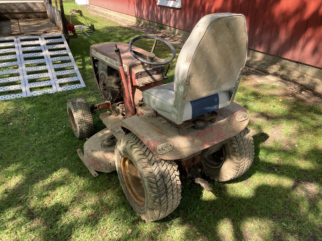

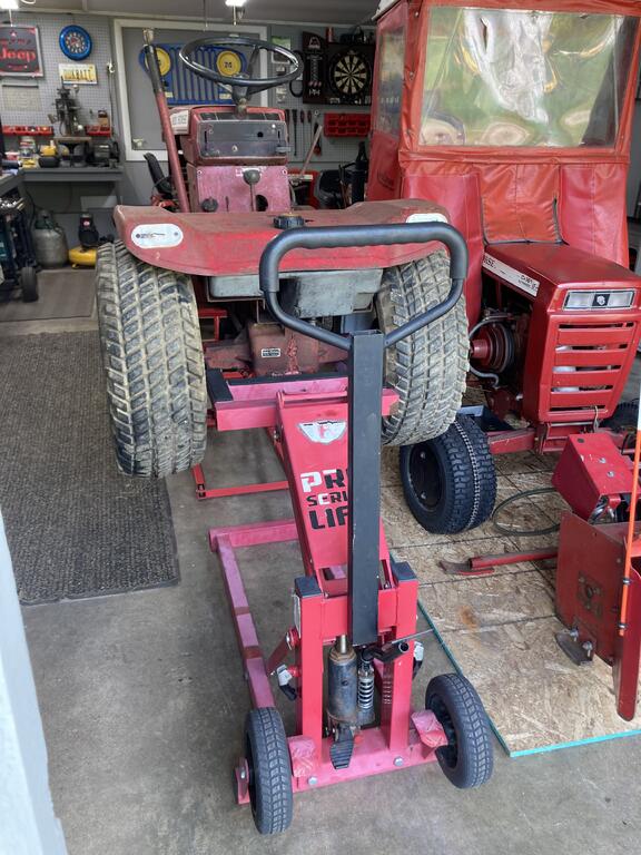

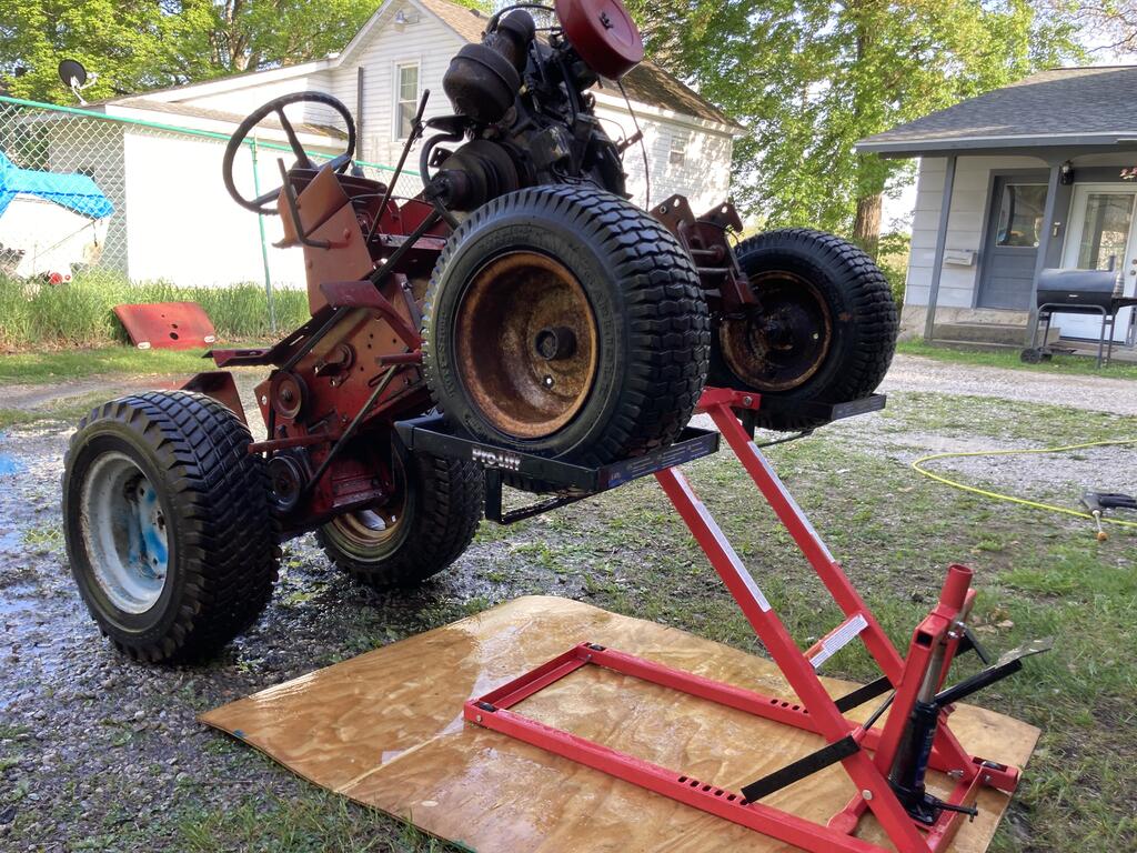

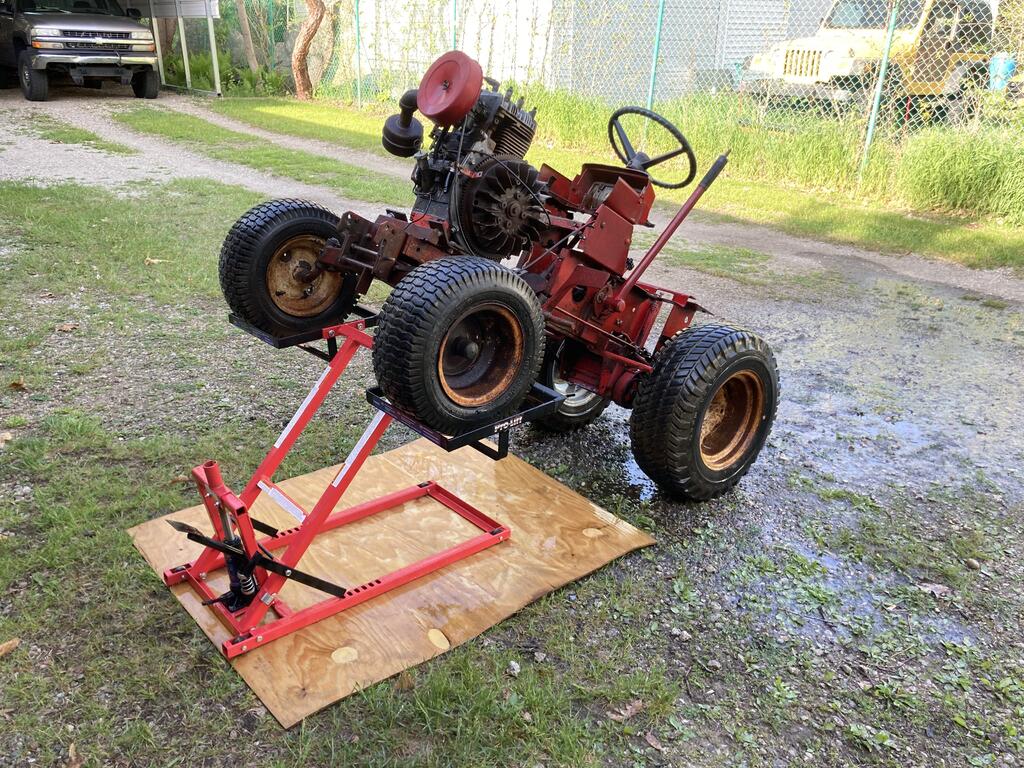

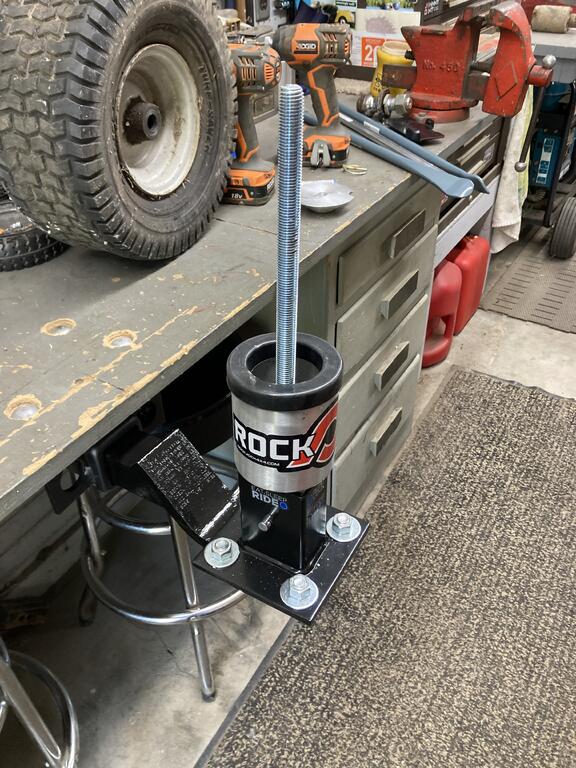

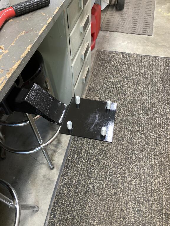

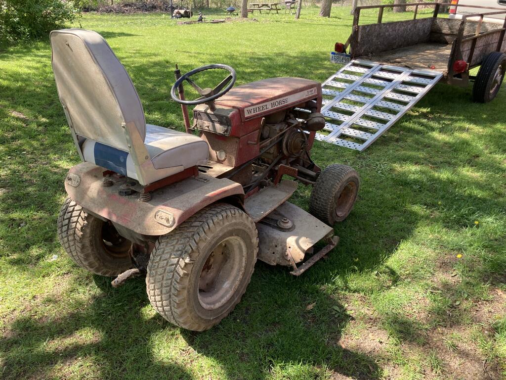

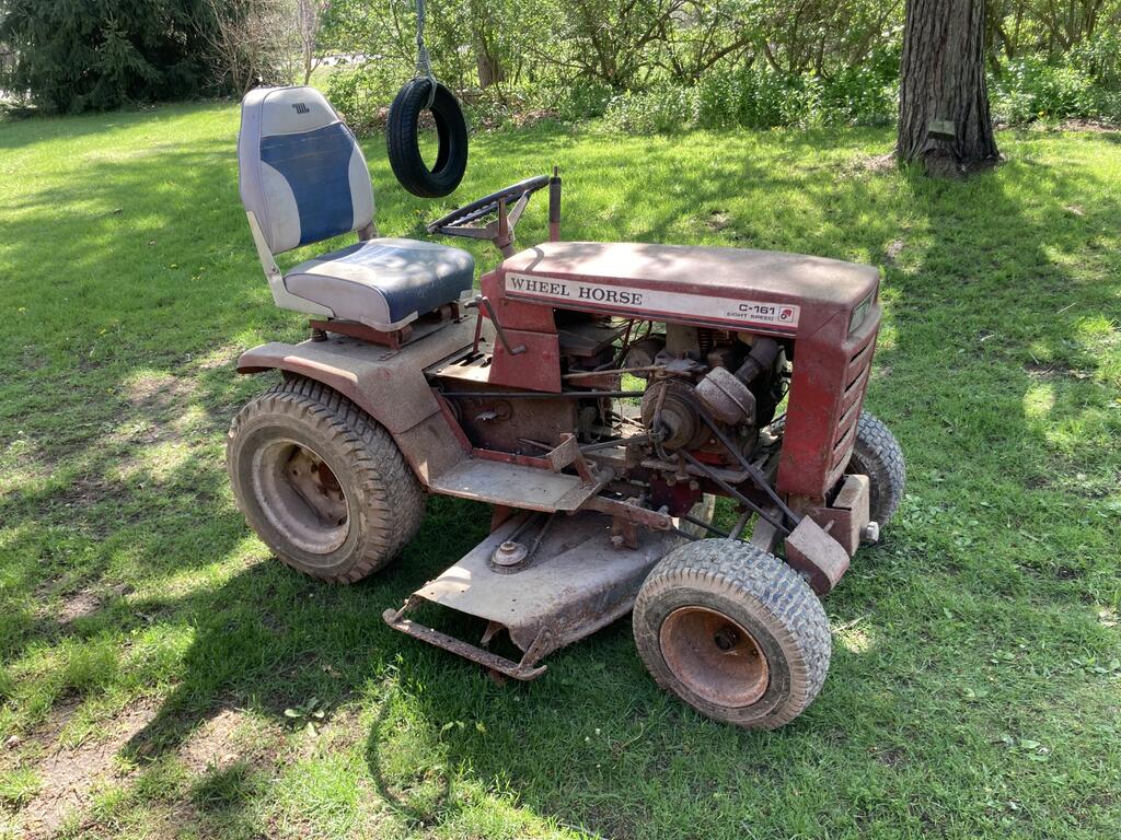

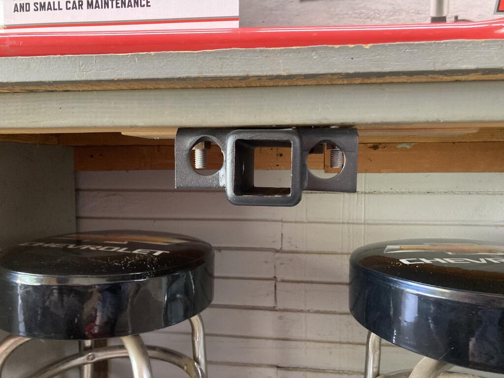

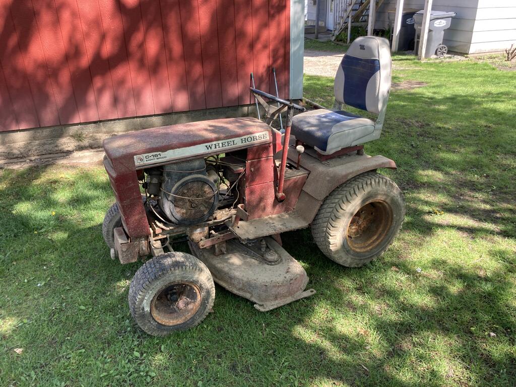

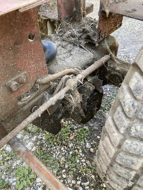

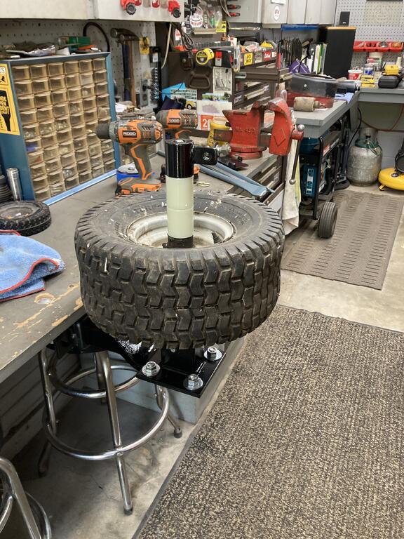

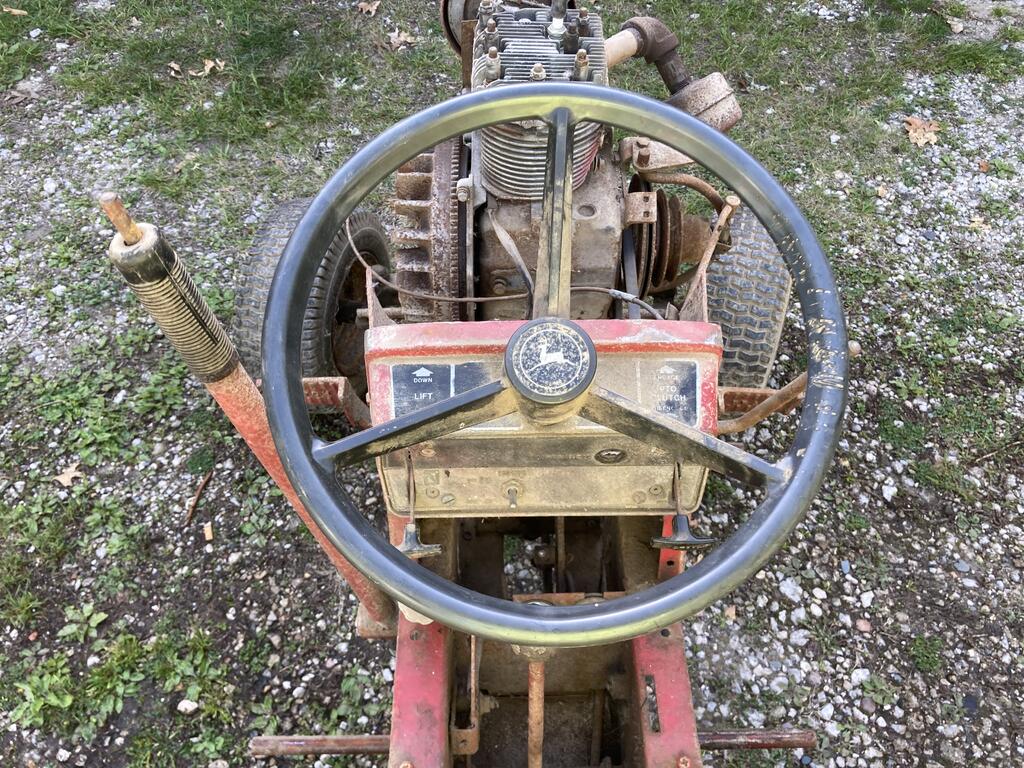

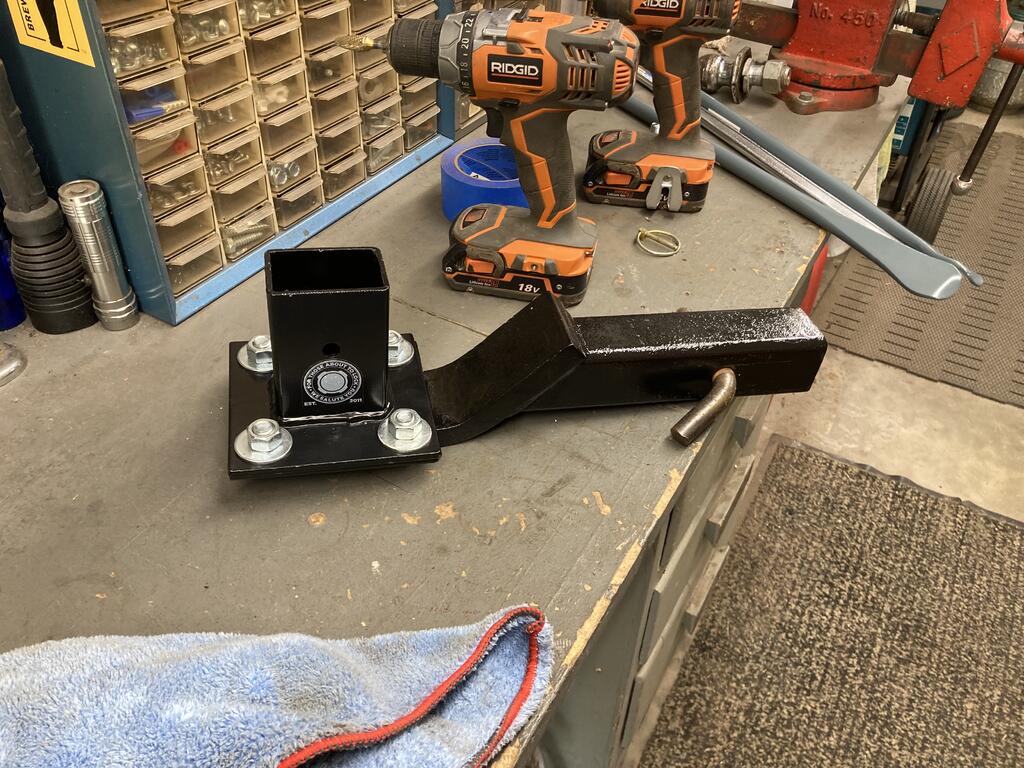

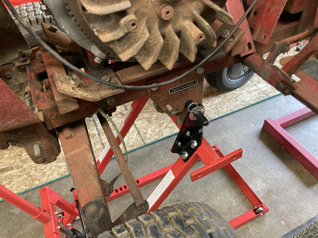

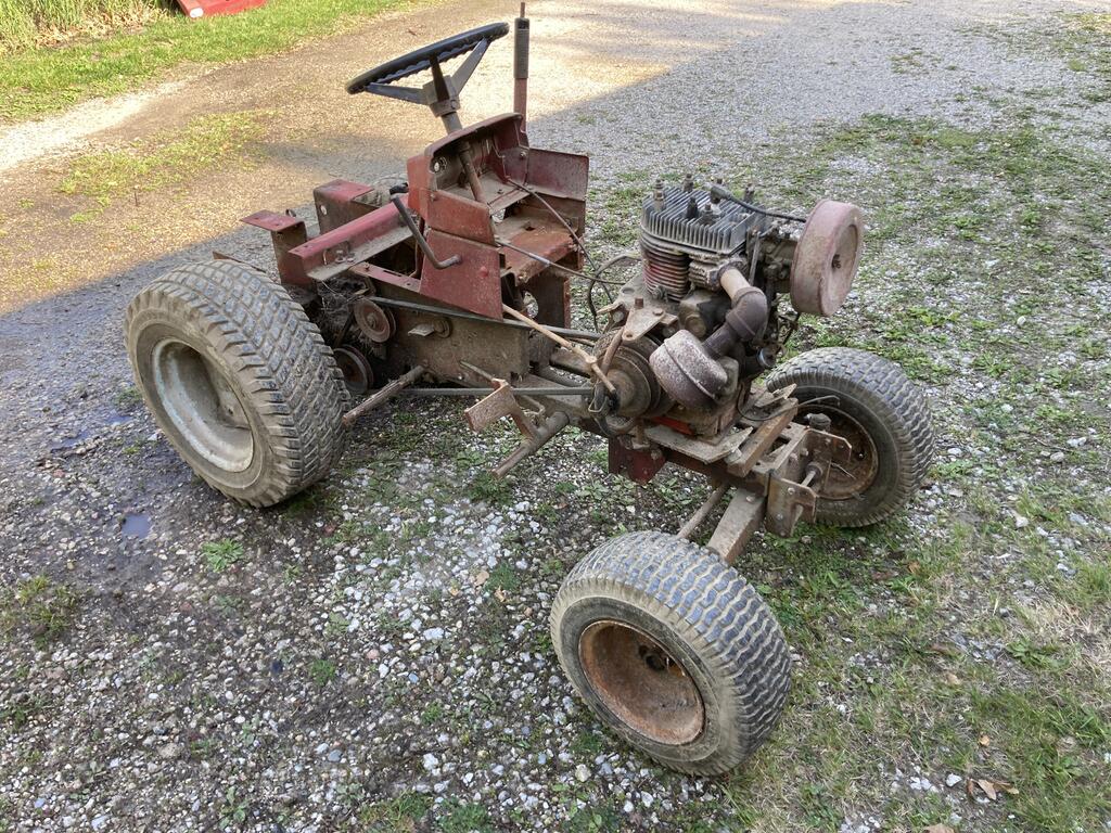

Blasterdad 3,045 #1 Posted May 26, 2023 (edited) Let's start here.... Sold the '73 no name 12 Automatic to a very happy new owner. The void in the collection created a huge vacuum & this was sucked into it the very next day, lol. 1979 C-161 8 Speed with some "interesting" PO's mods... (not limited to the K301 heart transplant) Poor thing had been sitting in a barn for many years with no friends... The most um "interesting" mod..... Clothes off, ready for a bath... I think she might need a brake shaft seal... I was pretty sure there was a under all that dirt & crud! Made a modification to one of my lifts, anyone familiar with mower decks will recognize these brackets & rod.... It can now be locked into the front or mid Tach-O-Matic, snowplow bracket, or rear hitch mount. With both lifts it gets the Horses pretty high up & can remove all 4 wheels. Mounted a Reese receiver under the workbench for mounting my tire changer, fabbed a plate for the mount on a spare hitch I had laying around, solid as Sears... Going to make a couple more, one for my pipe vise & one for an engine stand. Edited May 26, 2023 by Blasterdad 5 8 Share this post Link to post Share on other sites

kpinnc 15,953 #9 Posted May 27, 2023 3 hours ago, Blasterdad said: Mounted a Reese receiver under the workbench for mounting my tire changer, fabbed a plate for the mount on a spare hitch I had laying around, solid as Sears... I wish you hadn't done that. Now I gotta copy it!! That is really nice! 6 1 Share this post Link to post Share on other sites
Wheel-N-It 2,976 #10 Posted May 27, 2023 3 minutes ago, Blasterdad said: Yes, he is very happy, his first . He's already got the bug, he'll have a dozen in no time! Uh Oh !!! I resemble that remark LOL The same thing happened to me 33 years ago 2 1 1 Share this post Link to post Share on other sites
Blasterdad 3,045 #11 Posted May 27, 2023 1 minute ago, kpinnc said: I wish you hadn't done that. Now I gotta copy it!! That is really nice! Thanks, Harbor Fright, step bumper receiver, $18.00 3 Share this post Link to post Share on other sites
WHX?? 53,081 #12 Posted May 27, 2023 17 minutes ago, kpinnc said: I wish you hadn't done that. Now I gotta copy it!! That is really nice! Didn't we just say that KP? Get with the program... 1 Share this post Link to post Share on other sites
kpinnc 15,953 #13 Posted May 27, 2023 46 minutes ago, WHX?? said: Get with the program... I tend to be a couple steps behind... 2 Share this post Link to post Share on other sites
Bill D 2,397 #14 Posted May 27, 2023 Definitely have to copy the hitch setup. Love the lift mod to hook into the tach-a-matic. Will be copying that one as well. Boat seat looks comfy. 2 Share this post Link to post Share on other sites
