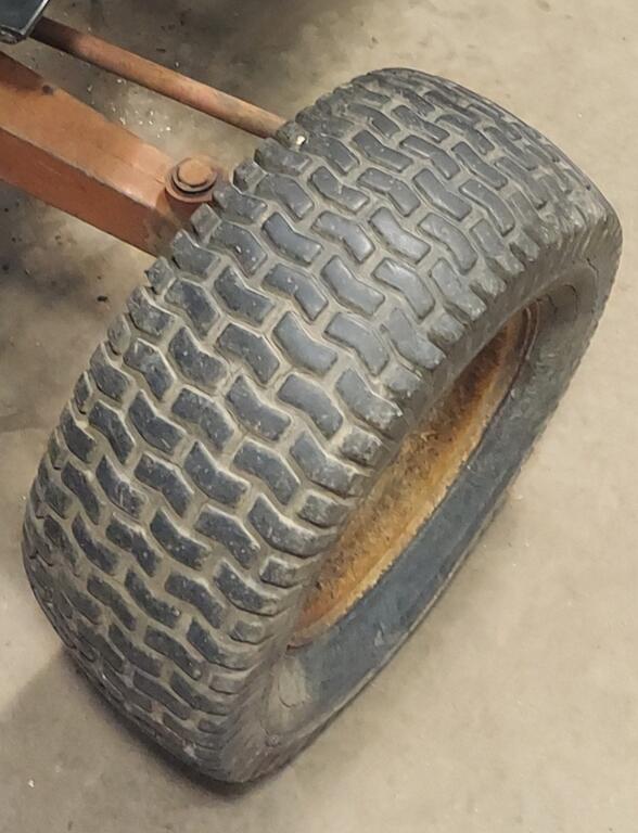

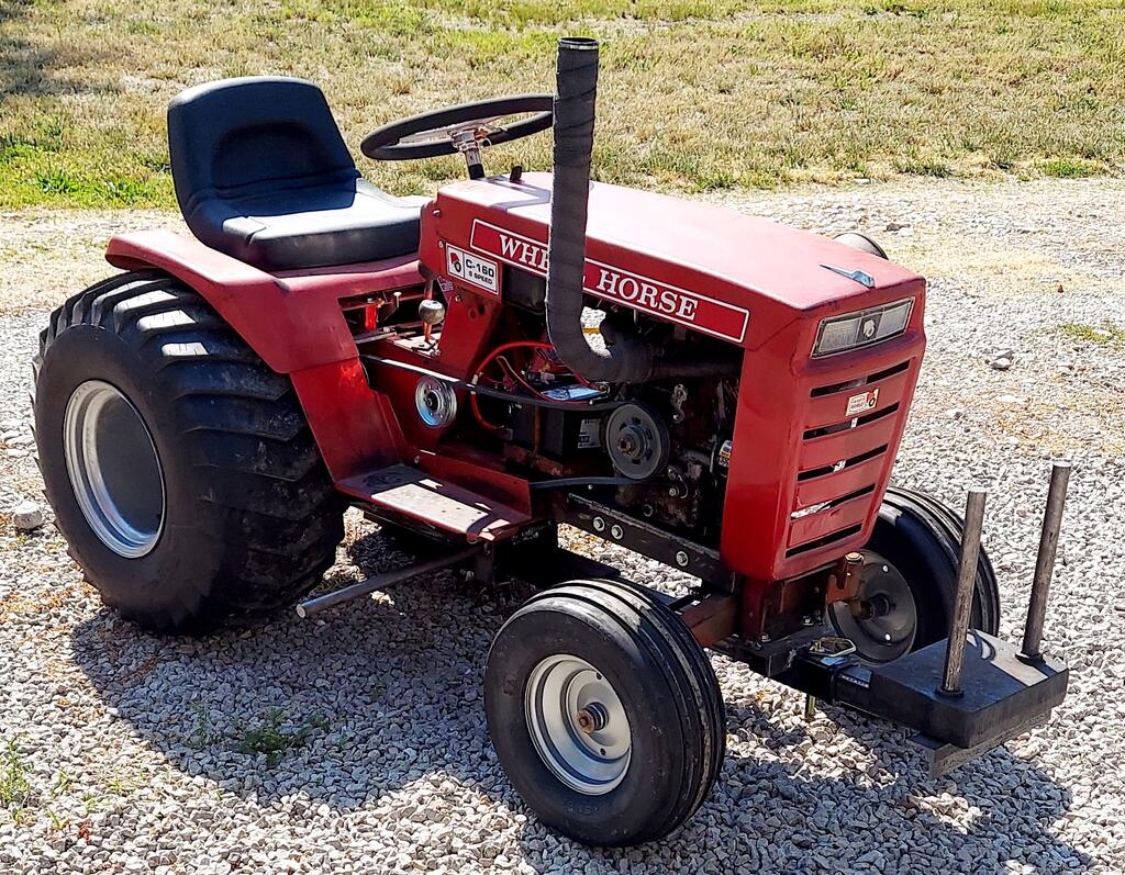

417tractorpuller 59 #1 Posted May 25, 2023 (edited) Hello everyone. First time poster here... Currently building a C-160 for my youngest son to pull and am considering front wheel/tire combos. Does anyone have a photo of 16x6.50-8 Vredstein V61's mounted up on a factory C-160 front wheel they are willing to share? They recommend a 5.38" wide rim, and not sure if mine are that wide. The turf tires on the original wheels seem to be squeezed in more than I'd like a tire to be. Also, does anyone know the factory rim width for the C-160, I haven't dismounted the tires on mine to measure (I would guess 4.5-5")? I know the spindles are around 4" long or a touch over, as I tried wider set of wheels on the front with about a 3" hub length, but was going to have to make a bushing/spacer to take up the room. I decided not to go that route, and haven't been able to find a 5.38-7" wide rim that also has a wide enough hub for the 160's spindles. I attached a picture of the factory wheel and tire as well as a picture of the tractor with the white wheels that would need spacers so you could see what I am dealing with. Thanks!! Edited May 26, 2023 by 417tractorpuller Autocorrect changed a word on my post I didn't notice 5 1 Share this post Link to post Share on other sites

417tractorpuller 59 #4 Posted May 26, 2023 Thanks for the replies. I know a lot of pullers run a smaller tire, I however don't. I run a heavy front bracket and like the ability to go through a low spot without plowing the bracket in the dirt. I know the WH will require a lot more front end weight compared to a cub due to the lighter sheet metal and frame. The heavy bracket will support that without bending too. Has anyone here shortened the spindle length and redrilled the bolt hole with success? 1 Share this post Link to post Share on other sites

417tractorpuller 59 #8 Posted May 30, 2023 Mike, those look great on your 312! I like the ribbed tires myself, makes them look more like a tractor and less like a lawnmower in my opinion. I don't know if the 4.00x8 tri rib would be stretched too much on the factory wheel, or if the V61's would be too squeezed in. I spent the weekend building a hitch, belly bracket, and extendable front weight bracket. I haven't got the tires off my factory front wheels yet. I will try to work that in the schedule this week and make a more informed decision before spending money on powder coating and tires. Thanks for the feedback! Great group we have going here!! 1 1 Share this post Link to post Share on other sites
ebinmaine 79,020 #9 Posted May 30, 2023 1 hour ago, 417tractorpuller said: 4.00x8 tri rib would be stretched too much on the factory wheel Those do have a tad bit of a bulbous appearance on a mid 70s wheel. They do however look great on earlier narrower wheels. 1 Share this post Link to post Share on other sites

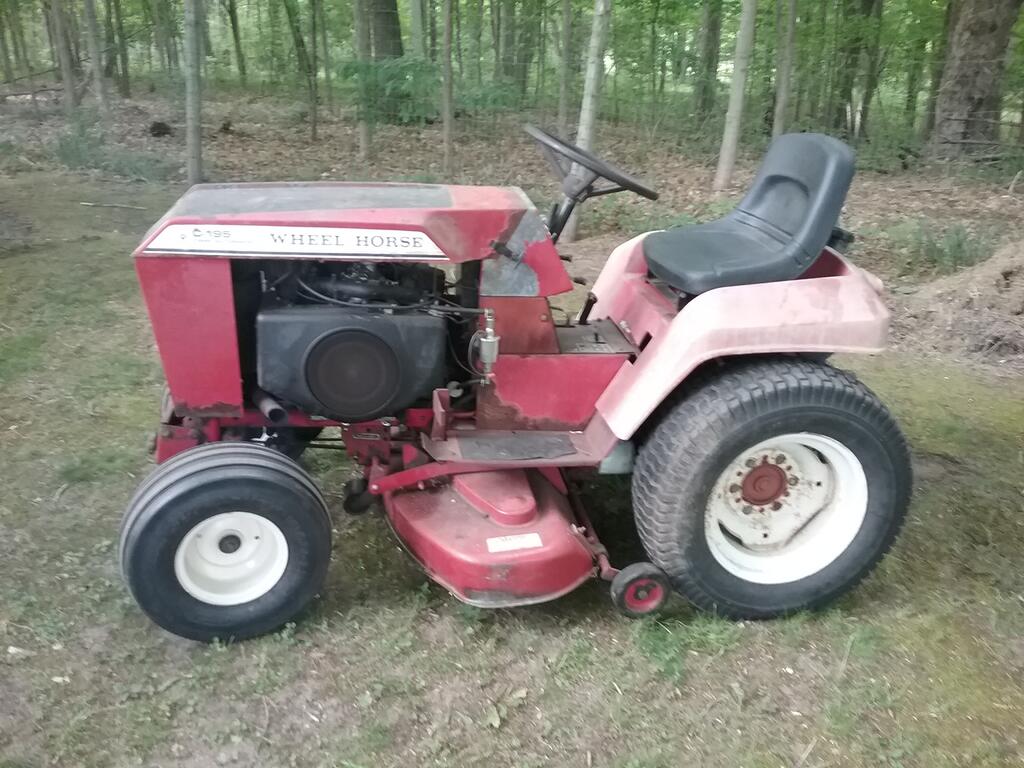

8ntruck 8,916 #10 Posted May 30, 2023 Here is a side on shot of V61's on my C-195. The front wheels are stock. I think the wheels are the same size as on a C-160. I've got a shot more from the front somewhere. I'll add it here when/if I find it. 2 Share this post Link to post Share on other sites

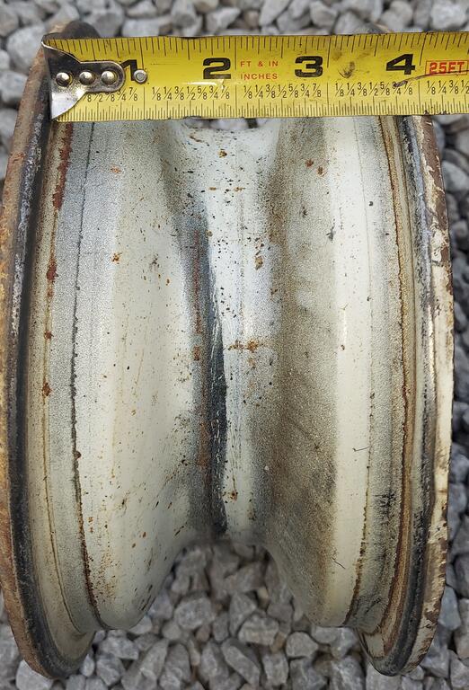

417tractorpuller 59 #12 Posted June 1, 2023 The front rims on our C-160 measure 3.75 width if anyone else needs to know. I ordered the Vredsteins yesterday, but may wish I put the 4.00-8 tri ribs on. Lol 1 Share this post Link to post Share on other sites
