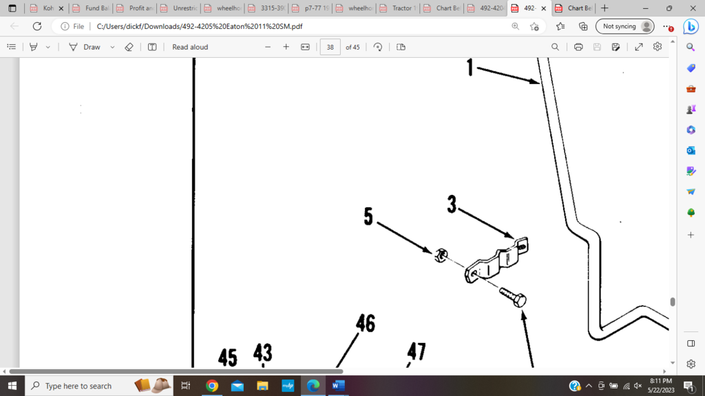

Robaroni 86 #1 Posted May 22, 2023 (edited) I just finished restoring (not cosmetically but mechanically) a 314-8. There is a spring that keeps the shift lever back to make the neutral switch on so the tractor starts ( have all the safety contacts working except the reverse mowing, that's always on now.) What I did was run a spring from the transmission housing bolt to the shift lever, it works but I'd like to find the original spring or even a sized drawing or broken spring that I can duplicate. Thanks for the time and help, Rob Edited May 22, 2023 by Robaroni Share this post Link to post Share on other sites
953 nut 68,503 #2 Posted May 23, 2023 Are you speaking of the detent (part # 3) for the motion controller? If so you would be best off contacting Lincoln at A-Z to see if he has a good used one. https://www.a-ztractor.com/. K&B might have a NOS one. @76c12091520h, send him a PM. Share this post Link to post Share on other sites
gwest_ca-(File Mod) 12,451 #3 Posted May 23, 2023 Is it on this page? https://www.partstree.com/models/73449-314-8-toro-garden-tractor-sn-200000001-200999999-2000/hoodstand-console-assembly-29/ 1 1 Share this post Link to post Share on other sites
Robaroni 86 #4 Posted May 23, 2023 5 minutes ago, gwest_ca said: Is it on this page? https://www.partstree.com/models/73449-314-8-toro-garden-tractor-sn-200000001-200999999-2000/hoodstand-console-assembly-29/ Yes, part# 50. Share this post Link to post Share on other sites
