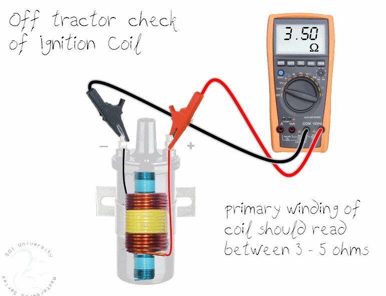

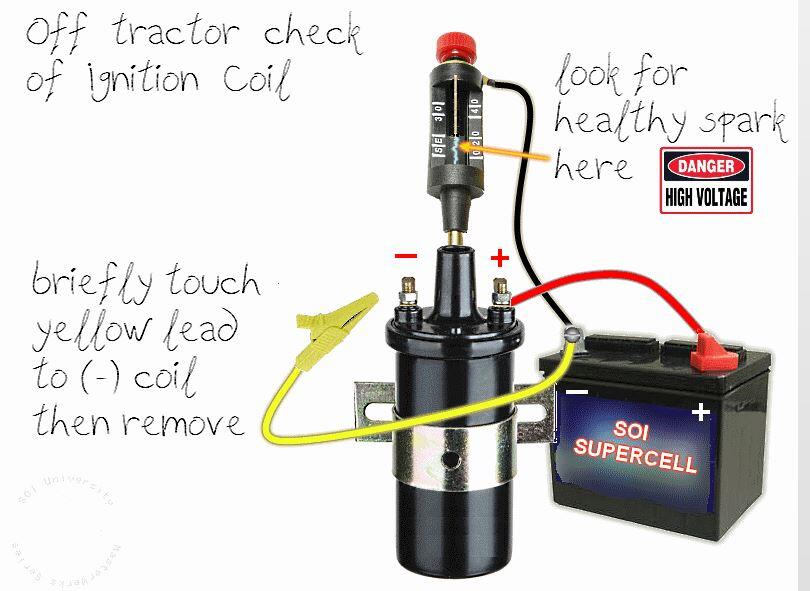

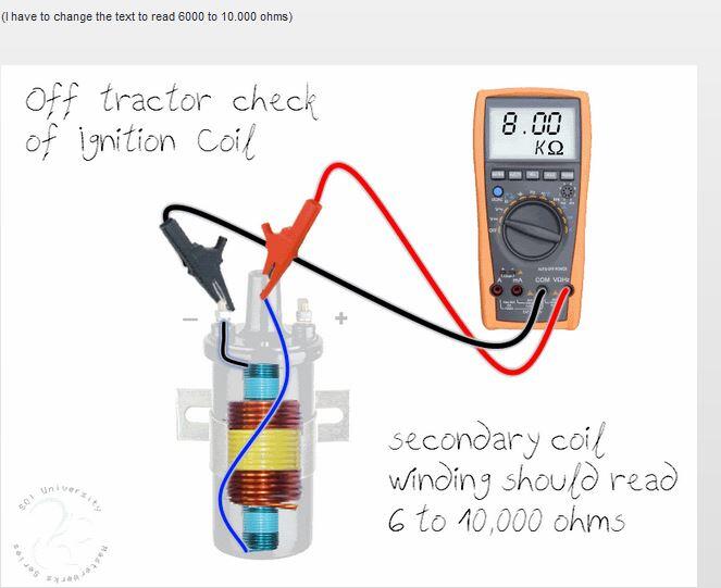

pfrederi 20,060 #3 Posted May 22, 2023 In pi one acceptable reading is 6,000 to 10,000 2 3 Share this post Link to post Share on other sites
WheelHorseNut 222 #4 Posted May 22, 2023 (edited) 2 hours ago, pfrederi said: In pi one acceptable reading is 6,000 to 10,000 OK, so my readings were as follows: in pic 1, 11.11k ohms in pic 2, 4.9-5.2 ohms finally settled at 4.9 I don't have the device for test 3, but I may get it just to have as it would seem that my coil is shot, correct? My new Kohler coil reads as follows: in pic 1, 8.3k ohms in pic 2, 5.8 ohms Edited May 22, 2023 by WheelHorseNut 1 Share this post Link to post Share on other sites
953 nut 64,646 #5 Posted May 22, 2023 The ignition coil for a battery ignition system should have an internal resistor built in that reduces the reading to 3 ohms. A higher resistance may result in less spark being developed because not enough of a magnetic field. 1 hour ago, WheelHorseNut said: I don't have the device for test 3, but I may get it just to have as it would seem that my coil is shot, correct? A good spark plug could be used to test spark. 4 hours ago, WheelHorseNut said: did buy one and a new condenser to replace it. Be surer the condenser you bought is for a battery ignition system. The Kohler 230722 Condenser fits all battery ignition single cylinder and twin cylinder from the K-90 to the K-582. The 235786 condensers are for the magneto equipped Kohler engines only K-161 to K-301 The unit of measure for a condenser is the Farad. Many electronic components like radios and TVs use capacitors that are in the microfarad range (ten to the minus six power Farads) and our small engines use a condenser that is in the nanofarad range (ten to the minus ninth power Farads) which is based on the voltage range they work in. A magneto ignition system uses a 100 to 250 nF condenser and a battery ignition system uses a 200 to 500 nF condenser. A good multi-meter will have a capacitor testing function. Armed with this information you can walk into your auto parts store and get a very confused look on the face of the person on the other side of the counter. The capacitance is not listed on the package and probably not in any of the on-line data they have for the condensers they stock. You just have to go by the application chart and be sure that the condenser you are buying is for the type ignition system your engine has, not just the horsepower or engine size. If an engine idles well, but runs erratically when revved up, like it hits and misses, pops and backfires, then chances are, it needs a new condenser/capacitor. And always install a condenser/capacitor with the wire facing downward so rain water and/or when washing off engine, water will not enter inside condenser/capacitor, ruining it. With water inside the condenser, this will also allow it to idle well, but cause it to run erratically when revved up. What is a farad (F)? A farad (F) is the standard unit of capacitance (C) in the International System of Units (SI). It indicates the ability of a substance to hold an electric charge. The value of most electrical capacitors is expressed in farads, microfarads (µF) or nanofarads (nF) 1 2 Share this post Link to post Share on other sites
