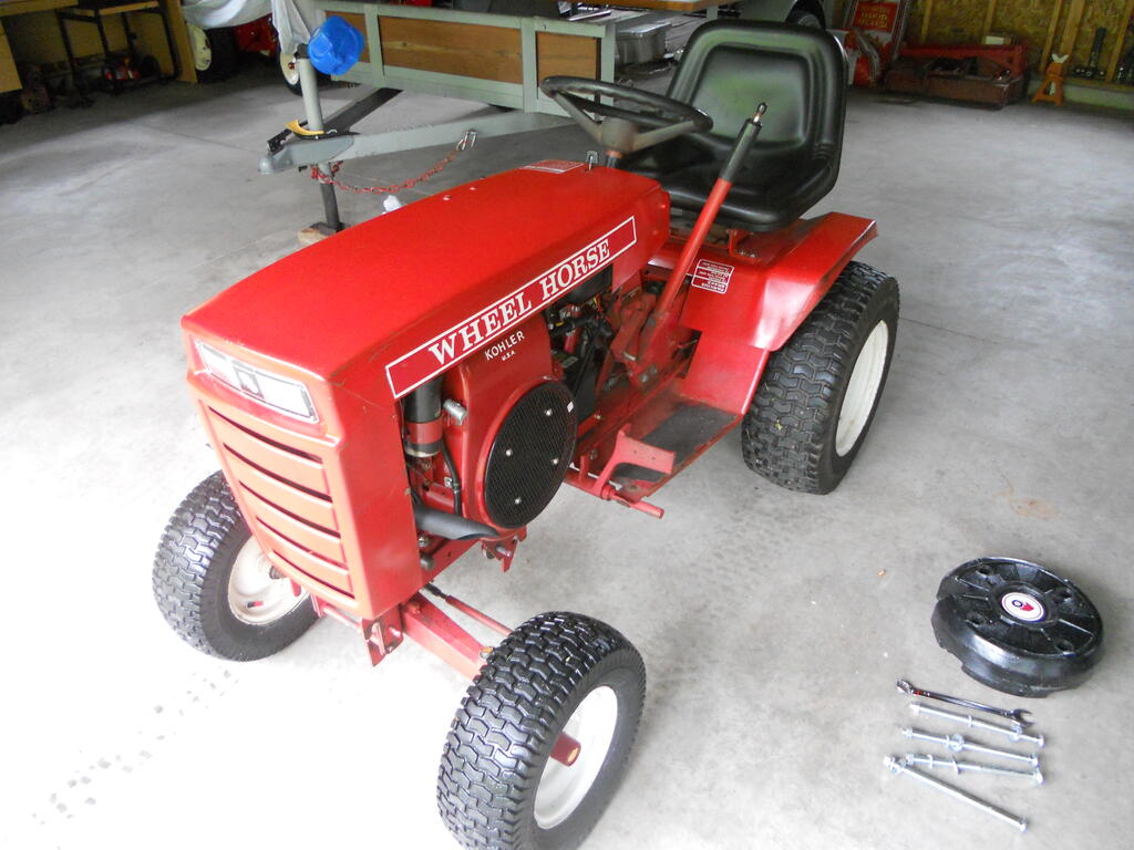

Hornet 8 #19 Posted May 22, 2023 12 hours ago, Racinbob said: The 76 and 77 B's and C's have same frame and transmission. The 74 and 75 B's have a 2" shorter frame. That may give you some additional challenges but I can't be sure of that. I purchased a 76 B-80 brand new and it wasn't long before I had a K-341 on it. Assuming the shorter frame won't matter make sure you get an engine spec'd properly for a Wheel Horse. That's actually very easy. I purchased my K-341 from WW Grainger when the K's were being phased out. It was spec'd fine for my use. The threaded mounting holes under the oil pan for the right side bolts were there and the shaft was fine. Because the crankshaft is bigger it required the PTO bearing to be replaced. The K-181 uses a 6935 bearing while the 341 uses a 6658 bearing. The bracket that mounts on the engine is also different. A 104732 on the small block, a 104729 on the big block. Initially I was able to adapt small block bracket and it was fine for many years but I finally did get the correct bracket. Other than those items it was a very simple swap. A few minor things will come up but are easily solved. A few other minor differences between the B's and C's for those two years were the rear tires, 23-8.5 on the C's, 22-7.5 on the B's. I swapped those. High back seat vs low back. Again, an easy swap. Headlights aren't standard on the B's but I bought a kit when I bought the tractor. The steering wheel on the B's are 13" vs 15" on the C's. I left that as it because I prefer it. Because you have a 75 4-speed your axles will be 1" vs the 1.125" on the 76 & 77. Don't fret that. It's got plenty of strength. You might notice the lack of a 'B-80 8 Speed' decal on the side. I removed them back when I did the swap. I now wish I wouldn't have. I always thought about ordering a couple 'B-160 8 Speed' decals but just haven't yet. Good luck, have fun and show us the results if you make the swap. Beautiful Tractor! That's exactly what I want. Thanks for all the info! 1 Share this post Link to post Share on other sites
Hornet 8 #20 Posted May 22, 2023 16 hours ago, Wheel-N-It said: Yes, go with a K engine unless you want to rewire the tractor. The M engines use a magneto. I'm actually a big fan of the K's. Thank you! 1 Share this post Link to post Share on other sites
ebinmaine 81,289 #21 Posted May 22, 2023 14 minutes ago, Hornet said: Beautiful Tractor! That's exactly what I want. What year is your own B80? Share this post Link to post Share on other sites
Racinbob 13,290 #22 Posted May 22, 2023 18 minutes ago, ebinmaine said: What year is your own B80? He said it is a 75 4-speed which is why I qualified my reply. 1 Share this post Link to post Share on other sites
ebinmaine 81,289 #23 Posted May 22, 2023 33 minutes ago, Racinbob said: He said it is a 75 4-speed which is why I qualified my reply. Ya know if I'd pay attention once in a while..... 1 Share this post Link to post Share on other sites
