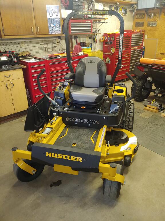

Wheel-N-It 2,976 #13 Posted May 25, 2023 I bought this Hustler Fastrak in April 2022. The salesman told me to blow the dirt and stuff off it every time after I mow, and DO NOT ever wash it. I listened and have followed his advice. So far no problems. 3 Share this post Link to post Share on other sites
