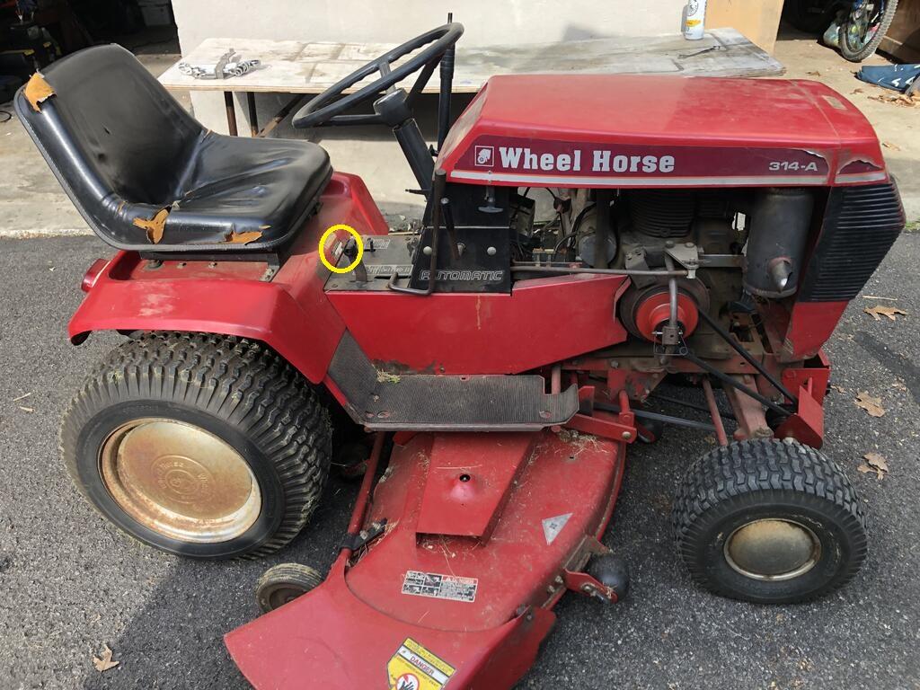

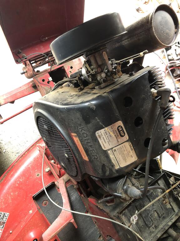

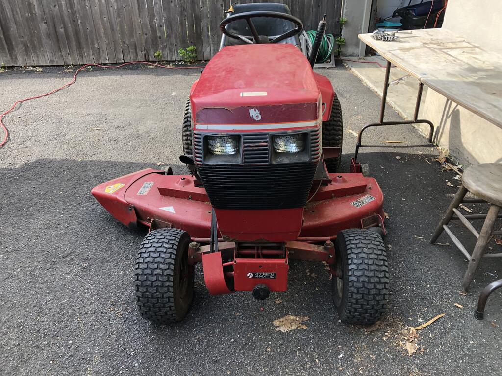

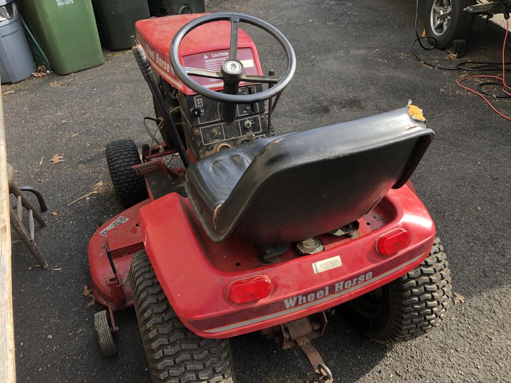

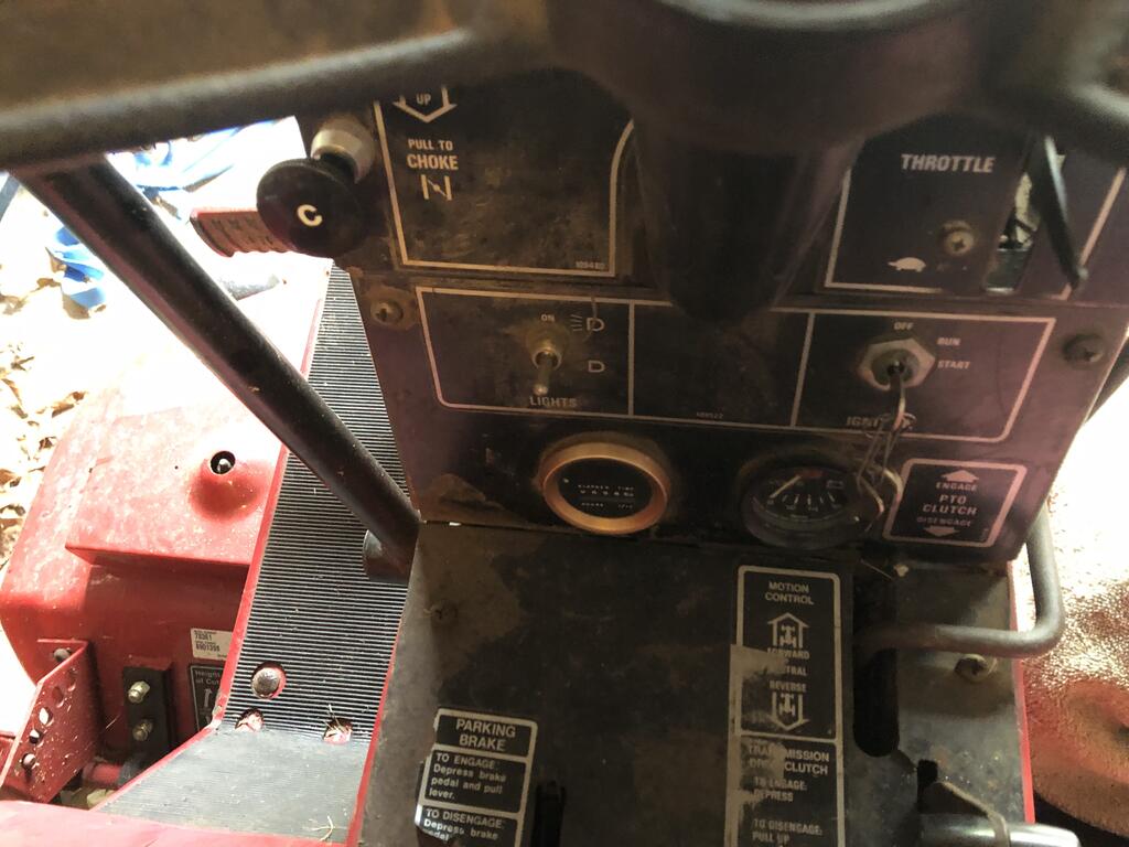

Jedaco 18 #1 Posted May 20, 2023 Hi from NY. I found a running 314-A with newer cutting deck on Marketplace for free! An older woman just wanted it gone and I happened to see her ad 5 minutes after she posted it. It came with a cart as well. The battery was dead, started with a jump but would the engine would only run on choke. The engine appears to run strong and no smoke to speak of. I'm charging the battery to see if it will hold a charge (doubtful) and I've pulled and cleaned the carb. Tires are dry rotted and needed air - I'll know if they are holding air tomorrow. Overall, the tractor is clean. Paint is chipping in places and it needs a good cleaning. As I dig into this project, I'm sure I'll be reaching out to you experts for advice. There does not seem to be a whole lot of information on this particular model. The woman suggested it was a 1983 model but from what I've read on the web, it is likely 1986. I see much more information for the 314-H and 314-8. Anyway, I just wanted to introduce my tractor to the forum. Looking forward to any advice as I get started. Pictures attached. Thanks, Jeff 3 9 Share this post Link to post Share on other sites

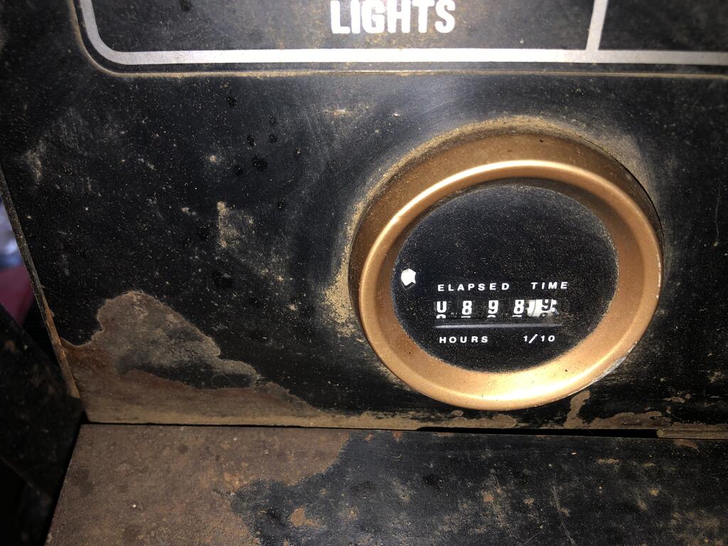

Wheel-N-It 2,978 #6 Posted May 20, 2023 If you don't know much about wheel horses, you will soon discover what an awesome machine you have. The K321 is almost as smooth as its 12 horsepower little brother, and almost as powerful as its 16 horsepower big brother. Its a good combination for mowing with that 48 inch mowing deck. Give the deck spindles a couple shots of grease each time before mowing, and keep the deck clean underneath. The deck and attachmatic is much newer that the tractor. Another plus of the wheel horse. Parts and attachments are easily interchangeable over the span of multiple years. How many hours are showing on the meter? 3 Share this post Link to post Share on other sites

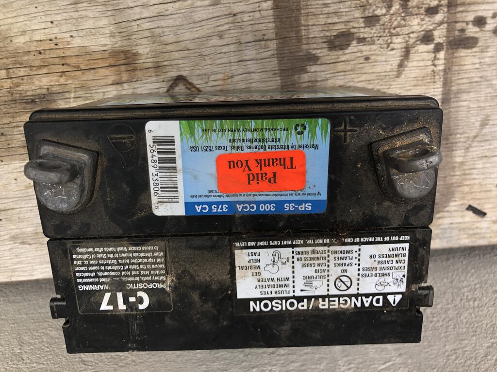

Jedaco 18 #11 Posted May 20, 2023 Thanks for the warm welcome! The battery did not take a charge so I'll get a new one later today. Pushing this beast around isn't easy. Is it correct that the transmission needs to be pushed all the way into "forward" to get it to roll. This is the only way it will disengage. The wheels seem to be holding air so that's good. The carb is cleaned and reinstalled. There's 898 hours on the meter. It's missing a couple of knobs - throttle and parking brake. Is a C-17 battery appropriate? That's what was in it. Thanks all! Great forum! Jeff 2 Share this post Link to post Share on other sites

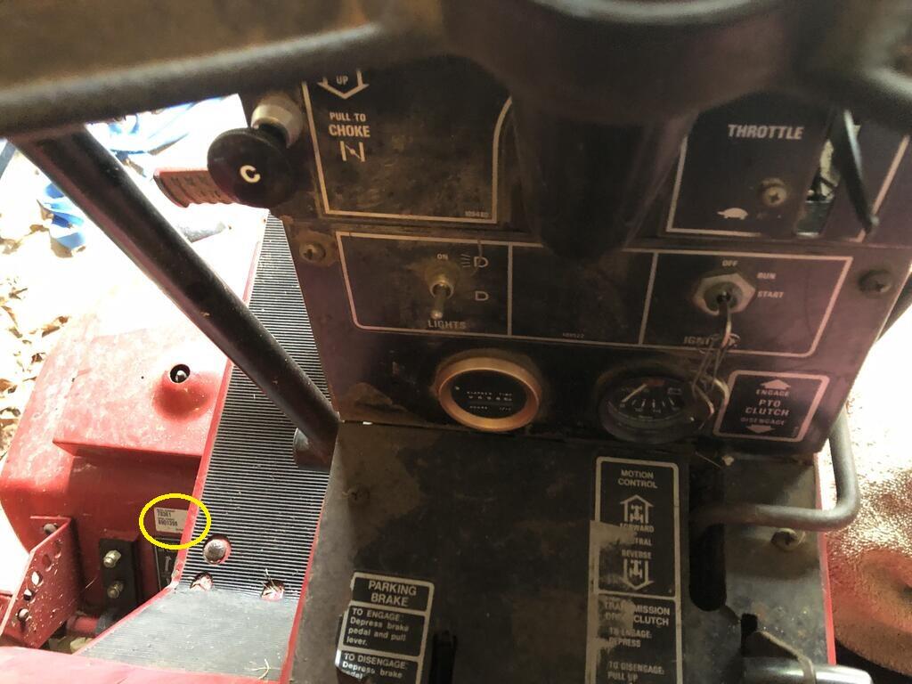

gwest_ca-(File Mod) 12,489 #13 Posted May 20, 2023 A replacement battery with 300CCA will work. ID decals 5 1 Share this post Link to post Share on other sites

Sailman 1,307 #15 Posted May 20, 2023 (edited) 1 hour ago, Jedaco said: Thanks for the warm welcome! The battery did not take a charge so I'll get a new one later today. Pushing this beast around isn't easy. Is it correct that the transmission needs to be pushed all the way into "forward" to get it to roll. This is the only way it will disengage. Just an FYI on "moving' the tractor. The Hydro's (Autos) need to have a valve on the transmissions adjusted (opened) when moving them under man power. I am not sure on your model but I am sure one of the "guru's" here will have that correct information. Great score by the way!!! Edited May 20, 2023 by Sailman 1 Share this post Link to post Share on other sites

Jedaco 18 #18 Posted May 22, 2023 Great advice from everyone. Thanks. So far I've done oil change, carb clean and adjustment, grease, new battery and general overall clean up. I took off that monster deck. It's like new. I'll keep it but I need to get a smaller deck. I don't have a huge yard and there are some tight areas around a pool and the 48" deck barely fits through my fence. I plan on moving to a larger property in the near future so the 48 will come in handy. Engine starts, idles and runs strong. Valves are noisy so I'll check them. What are the clearances? Share this post Link to post Share on other sites
