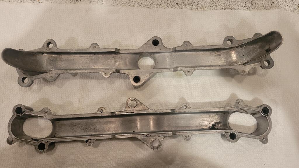

RED-Z06 2,720 #4 Posted May 19, 2023 P series used a 2piece intake, they were riveted together and a bit of sealer used...they have a tendency to go back to being a 2pc...and it causes a huge air leak. 1 Share this post Link to post Share on other sites
MJC12 1 #5 Posted May 19, 2023 Thanks RED-Z06. I watched an Onan carb maintenance video earlier today and heard similar comments. Easy remedy without splitting the manifold was to razor blade off all of the old gasket from the outside of the manifold and RTV grey to seal it up. I'll likely do that at the same time as whatever carb fix I do. Share this post Link to post Share on other sites

RED-Z06 2,720 #7 Posted May 19, 2023 1 hour ago, MJC12 said: Thanks RED-Z06. I watched an Onan carb maintenance video earlier today and heard similar comments. Easy remedy without splitting the manifold was to razor blade off all of the old gasket from the outside of the manifold and RTV grey to seal it up. I'll likely do that at the same time as whatever carb fix I do. If you are replacing the carb, youll have the intake off at that point Share this post Link to post Share on other sites

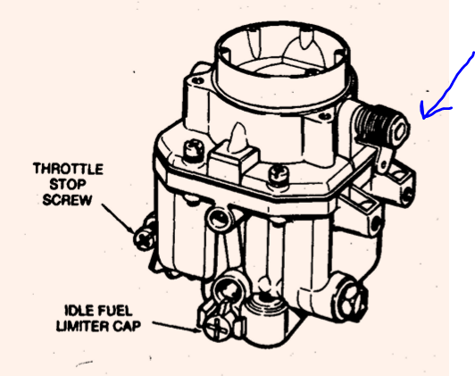

MJC12 1 #12 Posted May 25, 2023 (edited) I resealed the manifold and installed the replacement carb. Unfortunately I'm having the same surging issues. I'm going to clean the Nikki carb and put that back in because the amazon unit is pretty cheap looking/feeling and also the choke mechanism is upside down so I had to hack something together with some mechanics wire to get it to work work with the choke cable. On that note, does anyone know where I can get the connecting link that ties the choke mechanism on the carb to the choke linkage? (goes where the blue arrow is in this pic). EDIT: Never mind, I found it! It's "153–0500 Link, Choke" Edited May 25, 2023 by MJC12 Share this post Link to post Share on other sites
