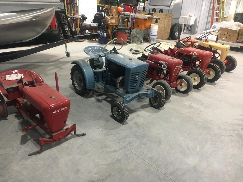

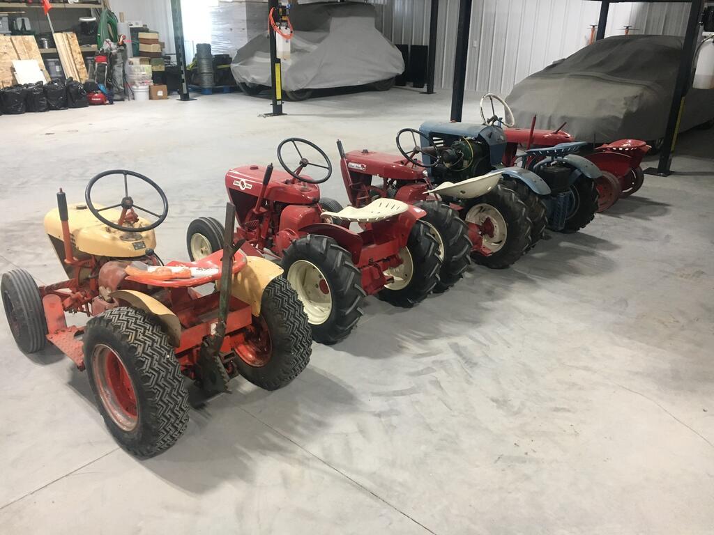

Pullstart 69,184 #1 Posted May 17, 2023 Big trip under Norman’s belt this last weekend. Something like 1,840 miles we ran, to ND and home. I need to figure all these out, but I believe a 400 and some 551s. These are the pictures that got me interested. The Panzer is something else! 9 14 2 Share this post Link to post Share on other sites
oliver2-44 11,312 #2 Posted May 17, 2023 (edited) Based on the hoods the first 2 look like 551’s. Do they have Tecumseh HB55 electric start engines. The 3rd is a 400 or 550. Not sure on the 4th one. I love that model Panzer. I have one like it to restore. Is it painted blue metallic? Does it have a Briggs or Kohler engine? Edited May 17, 2023 by oliver2-44 1 1 Share this post Link to post Share on other sites
Achto 31,244 #3 Posted May 17, 2023 Nice Haul !! But So Umm. What's the Case with that Power Red & Desert Sunset one?? 3 Share this post Link to post Share on other sites
953 nut 64,578 #4 Posted May 17, 2023 So, the pictures of the GT-14 tiller and the Pond walk-behind were just posted to throw us off. Your actual purpose was to move to the Suburbs. 6 Share this post Link to post Share on other sites
ri702bill 11,513 #5 Posted May 17, 2023 Just looking at the "Party Barge" boat trailer - how many Roasters ya think Kevin could fit on that?? (without the boat...) Good score. I acquired the same seat as the middle one along the way - great support but way tooo cold in the winter!! 3 1 Share this post Link to post Share on other sites
Pullstart 69,184 #6 Posted May 17, 2023 7 hours ago, oliver2-44 said: Based on the hoods the first 2 look like 551’s. Do they have Tecumseh HB55 electric start engines. The 3rd is a 400 or 550. Not sure on the 4th one. I love that model Panzer. I have one like it to restore. Is it painted blue metallic? Does it have a Briggs or Kohler engine? I think you are spot on on all your observations. There are two Tecky electric start Burbs and one Kohler. The ‘60 has had some hard repairs done to the right side of the three piece transmission and I consider that side/tube junk. I’ll either be looking for another transmission, or transfer all the goods from that one to the parts ‘61 for the time being. The Panzer has been repainted. I found a couple scratches where the sea green is poking through. It’s got a K-181 in it. 3 Share this post Link to post Share on other sites
Pullstart 69,184 #7 Posted May 17, 2023 31 minutes ago, Achto said: Nice Haul !! But So Umm. What's the Case with that Power Red & Desert Sunset one?? Funny pun there Dan! That’s “Justin”. Justin Case. Those colors will stay. The front wheels had calcium chloride and are pretty trashy. They’ll either need extensive repairs or replacement. 2 1 Share this post Link to post Share on other sites
Wild Bill 633 915 #8 Posted May 17, 2023 The one with rear steel wheels and shaft collars as front wheels is very interesting. LOL. Honestly. Nice haul. 1 1 Share this post Link to post Share on other sites
Pullstart 69,184 #9 Posted May 17, 2023 19 minutes ago, 953 nut said: So, the pictures of the GT-14 tiller and the Pond walk-behind were just posted to throw us off. Your actual purpose was to move to the Suburbs. Those were Tom and Jeremi’s and I was hauling them to Uncle Jim’s for exchange. I grabbed Sylvia’s scoot from WI and kept truckin’ with Mrs. P. To ND and back. We left at 4 pm on Sunday and got home at 6pm yesterday. I’d say it was a quick trip, but we kind of lally gagged on the way home yesterday! 5 Share this post Link to post Share on other sites
oliver2-44 11,312 #10 Posted May 17, 2023 22 minutes ago, Pullstart said: The ‘60 has had some hard repairs done to the right side of the three piece transmission and I consider that side/tube junk. I’ll either be looking for another transmission, or transfer all the goods from that one to the parts ‘61 for the time being. I may have an extra side plate. If your interested I can dig through my parts pile. 25 minutes ago, Pullstart said: The front wheels had calcium chloride and are pretty trashy. They’ll either need extensive repairs or replacement. E Tank and JB Weld are your friend. I’ve also used some thin model boat fiberglass cloth in JB Weld to repair larger holes in some David Bradley rims. 1 1 Share this post Link to post Share on other sites
Pullstart 69,184 #11 Posted May 17, 2023 31 minutes ago, oliver2-44 said: I may have an extra side plate. If your interested I can dig through my parts pile. E Tank and JB Weld are your friend. I’ve also used some thin model boat fiberglass cloth in JB Weld to repair larger holes in some David Bradley rims. I definitely thought about your front wheels when I saw these ones. They are savable, it’s just how bad do I want ‘em!? If you have time, I am not sure when I’ll get to these but would love to have a square side plate. I figured I’d search around at the Big Show too! 1 Share this post Link to post Share on other sites
clueless 3,359 #12 Posted May 17, 2023 Looks like 3 '61 models and a '60 model. The battery on the Panzer is it a side post because if it's a top post and I sat my fat a** on the seat, you get the picture. Well worth the 1800 mile trip, let me know when you ready to make another 1800 mile run, no big hurry. 1 1 Share this post Link to post Share on other sites
RandyLittrell 3,944 #13 Posted May 17, 2023 I really like the Case themed tractor, the colors really work! Glad you are gonna leave it!! Randy 1 1 Share this post Link to post Share on other sites
Pullstart 69,184 #14 Posted May 17, 2023 14 minutes ago, RandyLittrell said: I really like the Case themed tractor, the colors really work! Glad you are gonna leave it!! Randy My issue right now, is what repairs need to be done, and how to keep it looking like it does. I.E. the wheels that need repair or replacement, or if/when that Tecky gives up the ghost… Patina tractors with shiny wheels are always an option however. 4 Share this post Link to post Share on other sites

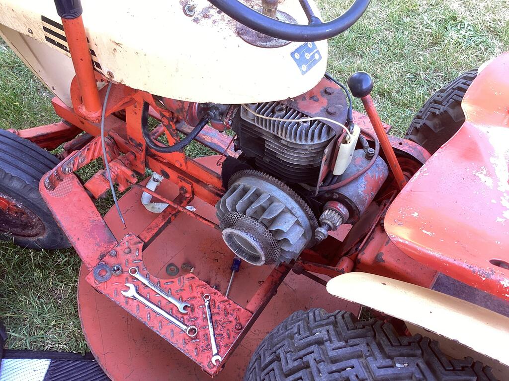

Pullstart 69,184 #19 Posted May 28, 2023 Just kidding! I lost spark. The flywheel cooling fan looks like it’s seen better days. I figured I’d check points and go from there.. Luckily, loosening the hood gets me plenty of access for the hard to reach stuff, and the family out garage saling keeps the campground somewhat quiet for me to work 1 Share this post Link to post Share on other sites
Pullstart 69,184 #20 Posted May 28, 2023 We have pig ribs and stuffed pork loins on the smoker today, cornhole and festivities. Happy Memorial Weekend! Justin is mostly back together and fired up with freshly filed and adjusted points. Good to go! 2 1 Share this post Link to post Share on other sites
