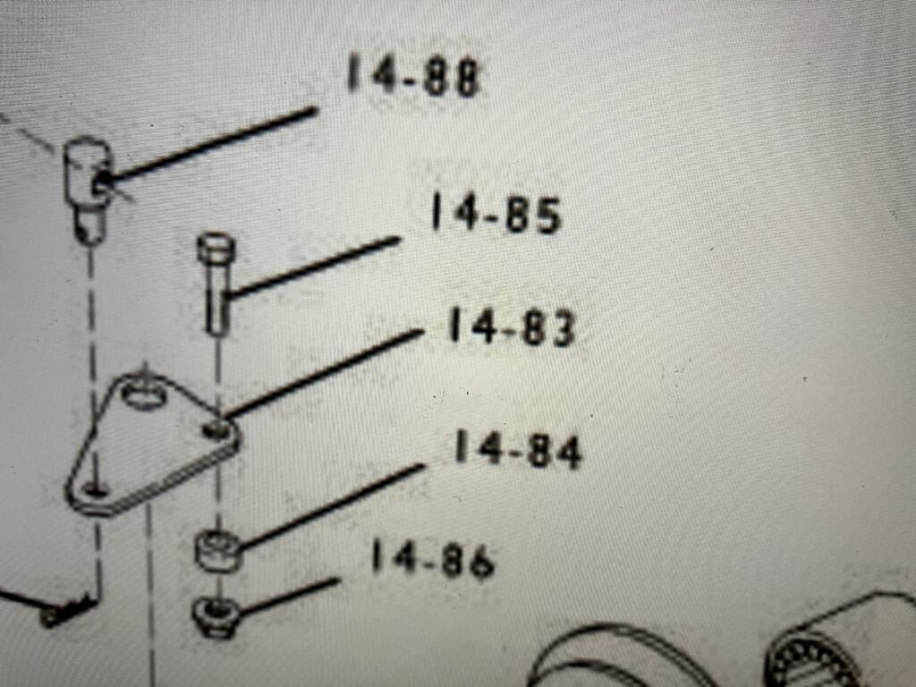

Retired Wrencher 6,979 #1 Posted May 16, 2023 Are these parts on the right side hole for an attachment? I never found what what it is for. P/N 14-85 14-84 14-86 Just asking do not need to use it. Thanks for any info Share this post Link to post Share on other sites
Ed Kennell 47,268 #2 Posted May 16, 2023 (edited) That is the cam lever that engages the PTO bell. The bolt and nut are the pivot that attaches the lever to the engine. Edited May 16, 2023 by Ed Kennell 3 Share this post Link to post Share on other sites

Retired Wrencher 6,979 #5 Posted May 17, 2023 22 hours ago, Ed Kennell said: That is the cam lever that engages the PTO bell. The bolt and nut are the pivot that attaches the lever to the engine. Ed do you have a picture of this? It been awhile since I worked on these. Share this post Link to post Share on other sites
