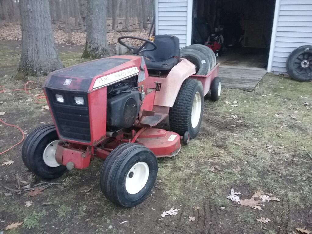

857lover 291 #1 Posted May 15, 2023 (edited) so i did a steering conversion on my 416-8 and i put the wider front wheels on my tractor and i have ags on the back and i’ve been looking to find a set for the front but can’t come up with anything when looking online is there a alternative size i could look for i know 16x6x8 would fit just want the wide look Edited May 15, 2023 by 857lover Share this post Link to post Share on other sites
Achto 32,642 #2 Posted May 15, 2023 13 minutes ago, 857lover said: i know 16x6x8 would fit just want the wide look Try looking for 16 x 6.50 x 8. you will find quite a few choices. Share this post Link to post Share on other sites
RandyLittrell 3,945 #3 Posted May 15, 2023 They have a nice wide stance and work great! https://www.millertire.com/16x6-50-8-v61-hd-5-rib-170-60-8-implement-tire-6-ply/ Randy Share this post Link to post Share on other sites
TJ5208 1,841 #4 Posted May 16, 2023 47 minutes ago, 857lover said: so i did a steering conversion on my 416-8 and i put the wider front wheels on my tractor and i have ags on the back and i’ve been looking to find a set for the front but can’t come up with anything when looking online is there a alternative size i could look for i know 16x6x8 would fit just want the wide look I found you some. Share this post Link to post Share on other sites
8ntruck 9,296 #5 Posted May 16, 2023 Got a pair of those 5 ribs from Miller. Running them on my C-195. 1 Share this post Link to post Share on other sites
twisted metal 49 #6 Posted May 16, 2023 These are a bit pricey but if you want the true ag look here you go https://www.millertire.com/16x6-50-8-firestone-3-rib-front-tractor-tire-4-ply/ Share this post Link to post Share on other sites
CasualObserver 3,416 #7 Posted May 16, 2023 Converted to what width rim? If you want realy wide, you could always step up to the 18x8.50-8 size as long as they fit on your rim. https://www.millertire.com/18x8-50-8-v61-hd-5-rib-6-ply-tire/ 1 Share this post Link to post Share on other sites
