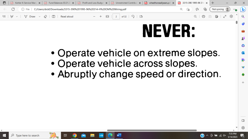

953 nut 70,325 #7 Posted May 14, 2023 6 hours ago, Dominator said: When he finishes up, it’s on a bank that separates our property. This is where it begins. Wheel Horse Safety 101, directly from the operator manual for a 314-H. Not only is your neighbor having fuel problems he is also starving the engine for proper lubrication. Think about where the oil slinger on the connecting rod is placed, smack dab in the middle of the oil pan. If the engine is tilted to one side or the other the oil will not be distributed by the slinger and the engine life will be shortened as a result. Mow up and down the slope. 2 1 Share this post Link to post Share on other sites
Horse Newbie 7,405 #8 Posted May 14, 2023 Maybe he could mow up and down the bank first, to not starve the engine of oil, then finish on the flatlands to not starve the engine of gas… 3 Share this post Link to post Share on other sites
