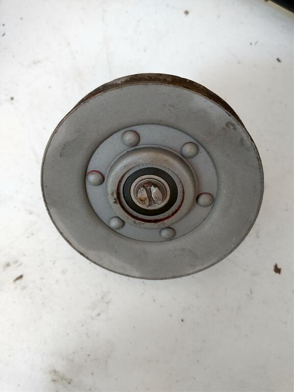

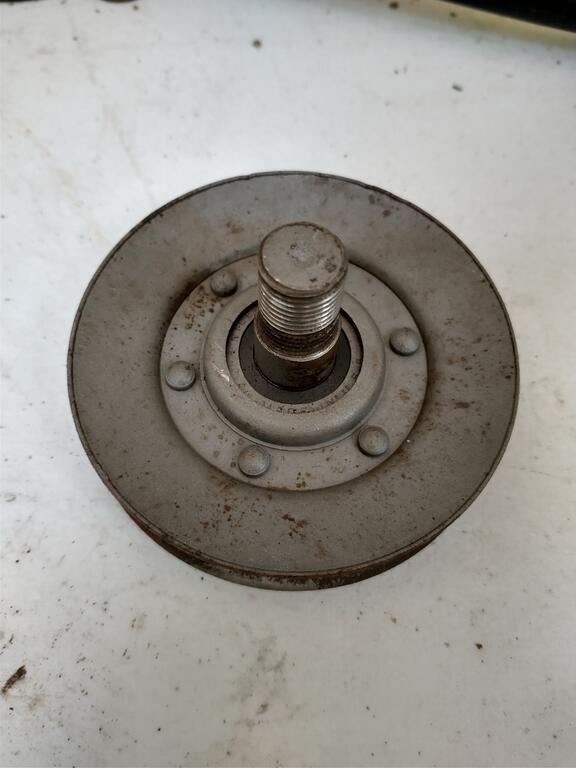

rmaynard 16,543 #1 Posted May 12, 2023 I guess I'll start a new topic here where questions like "how is that done" or how can I do that", can be answered by those who have more knowledge than me. So here is my first question. How do you remove the stud in this idler? I need to replace the bearing and can't for the life of me figure out how this stud is removed. 2 Share this post Link to post Share on other sites
squonk 44,482 #2 Posted May 12, 2023 Press. Use a socket that just fits over the stud so it supports the inner bearing race but the slotted end of the stud will slip thru. Press from the threaded side. 3 Share this post Link to post Share on other sites

rmaynard 16,543 #8 Posted May 13, 2023 8 hours ago, squonk said: Press. Use a socket that just fits over the stud so it supports the inner bearing race but the slotted end of the stud will slip thru. Press from the threaded side. The threaded side is larger than the slotted side. How can it press through? Share this post Link to post Share on other sites
squonk 44,482 #9 Posted May 13, 2023 Is that edge beneath the slot, bigger than the ID of the bearing or is it an illusion in the picture. Share this post Link to post Share on other sites
rmaynard 16,543 #10 Posted May 13, 2023 The slotted end looks like it must be pressed toward the thread side. Threaded shaft is 1/2" diameter which is larger than the inside of the inner race. Share this post Link to post Share on other sites
WHX?? 52,808 #11 Posted May 13, 2023 (edited) Yes remove any burrs and press out from the slotted side. 14 hours ago, JAinVA said: If you need to change the bearing,then all the rivets need to come out. That part was never designed to be serviced only replaced. Correct but where's there a will there's a way. Would guess in 1960 you could walk in a dealer and buy one. Edited May 13, 2023 by WHX?? 2 Share this post Link to post Share on other sites
