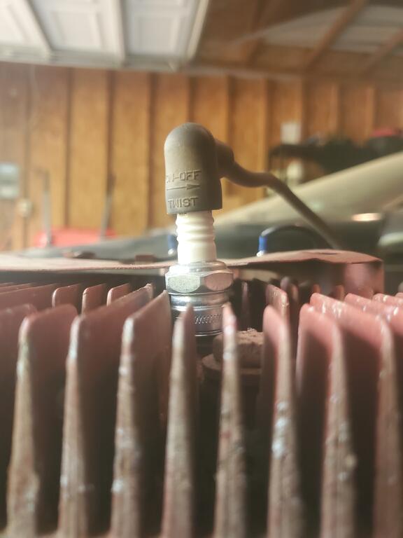

ebinmaine 81,289 #30 Posted June 5, 2023 35 minutes ago, chorusguy said: I can scavenge one off another machine, but am curious why you say that. Is it because a botched the repair, or because generally that doesn't work? 29 minutes ago, squonk said: Altering the angle and or depth of the spark plug electrode can change the flame travel and possibly burn a valve or melt a piston in short order @chorusguy Do you have any pics of the repair? 1 Share this post Link to post Share on other sites
chorusguy 227 #31 Posted June 5, 2023 No pic yet but will take one tomorrow 1 Share this post Link to post Share on other sites
ebinmaine 81,289 #33 Posted June 6, 2023 The angle of that plug doesn't look too bad. How's the depth though? Is the electrode close to the original position? If the electrode is too far up in the head you may end up with excess carbon forming. 1 Share this post Link to post Share on other sites
chorusguy 227 #34 Posted June 6, 2023 Honestly, I don't know. I was afraid to crank down on it to much. It seems pretty snug. I may run it today and let it hat cycle to see if it comes loose. I hate that I did it incorrectly, but am very glad it's running. I do have another head I can swap out, and have already bought a head gasket, so will probably do that one day, but knowing me, if it's running well, I'll put that off. Thanks for your reply 2 Share this post Link to post Share on other sites
ebinmaine 81,289 #35 Posted June 6, 2023 1 minute ago, chorusguy said: I do have another head I can swap out, and have already bought a head gasket, so will probably do that one day, but knowing me, if it's running well, I'll put that off I understand that logic. 😁 Just keep in mind that changing the head out is a simple job. Losing that engine would be a serious shame. They don't make em like that anymore...... 2 Share this post Link to post Share on other sites

squonk 48,429 #37 Posted June 6, 2023 5 hours ago, ebinmaine said: If the electrode is too far up in the head you may end up with excess carbon forming. That will melt a piston. I worked with a guy who put 4 helicoils in a k car, didn't get them deep enough so the electrodes were too high. 4 melted pistons a week later. 2 Share this post Link to post Share on other sites
