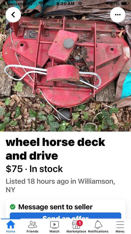

aemsee 93 #1 Posted May 10, 2023 just picked this up. Looks like it should work on my 310-8. 3 Share this post Link to post Share on other sites
ri702bill 12,169 #3 Posted May 10, 2023 Agreed - clean it up, grease the spindles, and give it a "whirl" !! Check the ball bearings on the mule drive too. 2 Share this post Link to post Share on other sites
Rick3478 454 #4 Posted May 10, 2023 Yeah, the 310 will have more power than the deck needs under almost any circumstance, but some users do this if they need to fit through a tight gate, between trees, etc. I've even seen them on C-160's and 416's. 2 Share this post Link to post Share on other sites

aemsee 93 #6 Posted May 11, 2023 9 hours ago, Rick3478 said: Yeah, the 310 will have more power than the deck needs under almost any circumstance, but some users do this if they need to fit through a tight gate, between trees, etc. I've even seen them on C-160's and 416's. yup. I have a zero turn for my mowing, but want this for doing my front yards and around my shrubs. The smaller deck makes for a nice looking cut. Plus I now have a mower to go along with my wheel horse tiller, snow blower and dump trailer 5 1 Share this post Link to post Share on other sites

aemsee 93 #8 Posted June 4, 2023 I did get it greased and mounted up just to try it out. Attacked some two week old grass behind the barn. Didn't miss a beat even with dull rusty blades, lol. Now to find a replacement double pulley, front roller and a set of wheels for it. 1 Share this post Link to post Share on other sites
