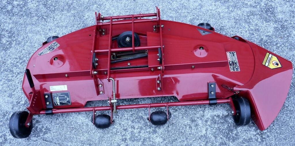

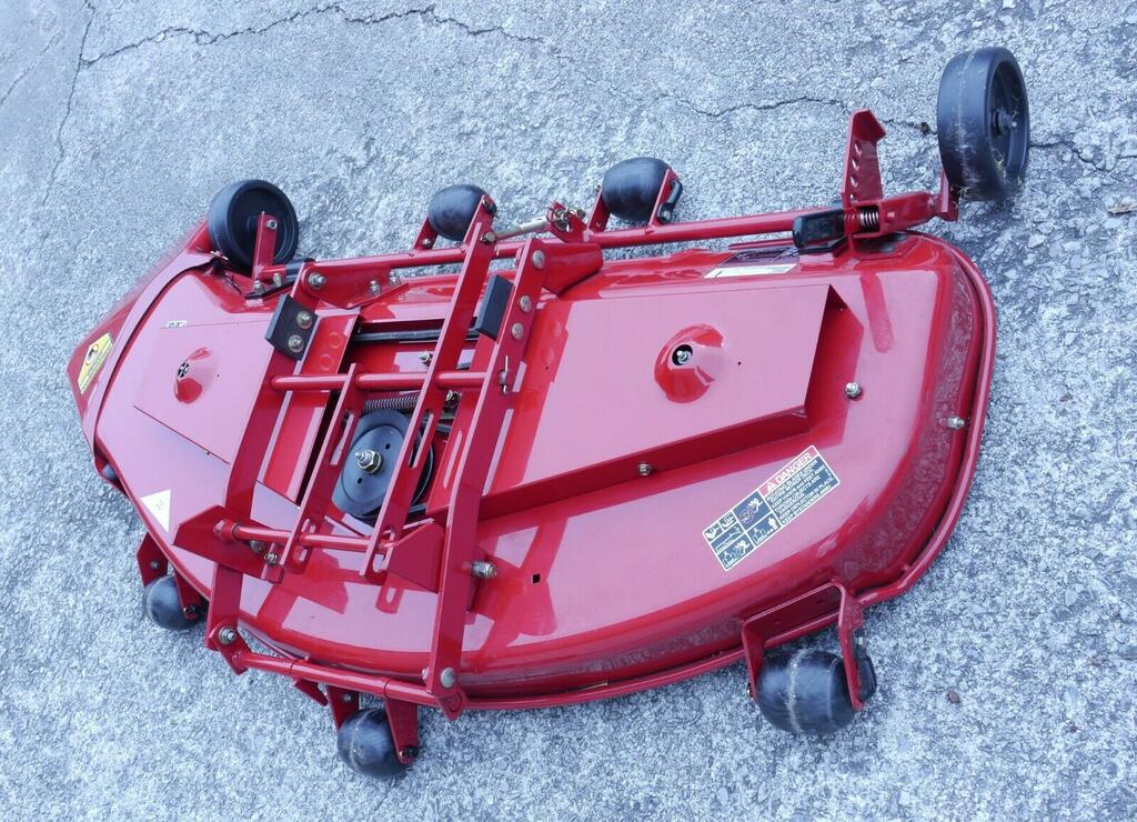

daveoman1966 3,884 #2 Posted May 10, 2023 Almost any deck...except for the big 60"... will hang on the 314-H tractor...thanx to the Tach-O-Matic system for attachments. You can hang 36, 42,and 48" (3-blade) side and rear discharge decks made from 1973 forward (& some earlier) on that tractor with no mods at all. Decks with this style of Tach-O-Matic hardware will work. (this is a 48" deck) Share this post Link to post Share on other sites
