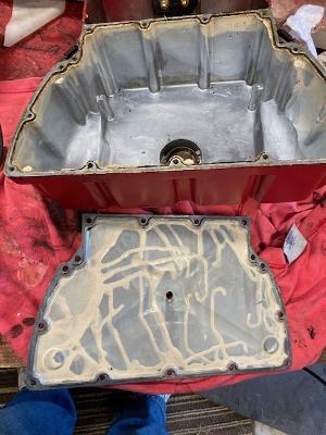

Pogo 57 10 #10 Posted May 11, 2023 Well Guys I got the tank out and 12 of the 13 screws loose. ONE IS PRETTY TIGHT AND i HAVE BEE TRYING TO GET SOME kROIL to sk in. Would heating the area with a heat gun help? Still not sure what route I am going to go. Going to talk to my welding guy and see if he is interested in doing it . I still may seal the stank with KBS if I weld. Thoughts on that idea? Share this post Link to post Share on other sites
Handy Don 14,884 #11 Posted May 11, 2023 45 minutes ago, Pogo 57 said: ONE IS PRETTY TIGHT AND i HAVE BEE TRYING TO GET SOME kROIL to sk in. Would heating the area with a heat gun help? Yes, heat/cool cycles will help. Being aluminum, which conducts heat much better than steel, handle with care. Also, where with steel I’d consider getting it very hot, with aluminum I’d back off a bit. Kroil will get in there in time, especially helped by the heat/cool cycling. It may take several cycles! Share this post Link to post Share on other sites

Pogo 57 10 #14 Posted May 12, 2023 Got the tanks a part with no broken screws! Someone tried to seal it and didn't do a good job. Have spent the day cleaning and O think I found someone that will wekd it up. I may still put KBS in it when I'm done.. Thanks for all the help and guidance. 1 Share this post Link to post Share on other sites
