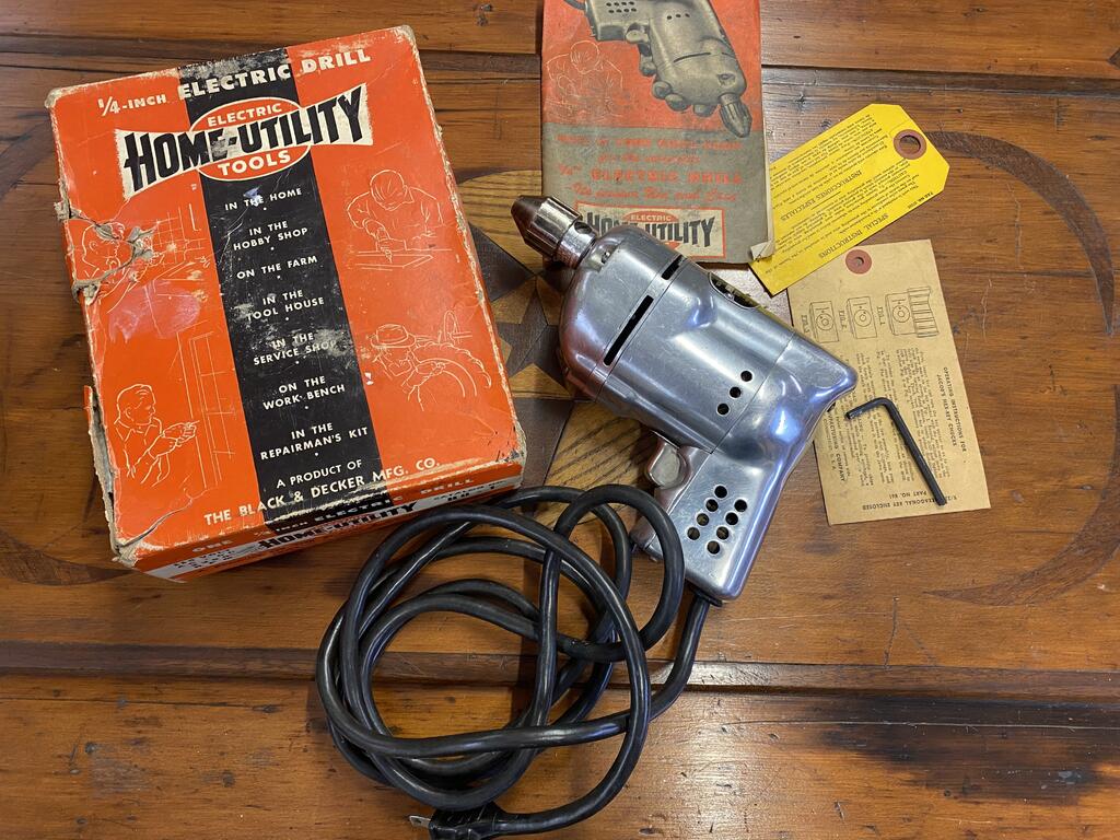

formariz 12,381 #1 Posted May 8, 2023 Already owning and using constantly several of these vintage drills I was happy yesterday when I came across this NOS beauty for a whopping $5.00. Even with hard use I am sure it will be around long after anything made today. 6 6 3 Share this post Link to post Share on other sites
Handy Don 17,739 #2 Posted May 8, 2023 Enjoy it! I could no longer work comfortably with a cord (including extension cords) and without a keyless chuck, reverse, and variable speed. But that’s me. 2 Share this post Link to post Share on other sites

ri702bill 13,399 #5 Posted May 8, 2023 Is that a "keyless" chuck?? 2 prong, probably non-polarized cord, metal housing-- there's a reason they don't make them that way... The 1/4" chuck is way old school - I buy all 1/2" cordless ones now.. My Dad had one similar mounted in a small drill press stand. I remember the distinctive gear whine it made, along with the sparking brushes!! Share this post Link to post Share on other sites
formariz 12,381 #6 Posted May 8, 2023 12 minutes ago, Handy Don said: Enjoy it! I could no longer work comfortably with a cord (including extension cords) and without a keyless chuck, reverse, and variable speed. But that’s me. I keep several each with a commonly uses bit such as with one with a countersink. No reverse needed on those. Drilling speed is ideal on these old drills. This chuck does use a key. It’s an hex-key chuck. 1 2 Share this post Link to post Share on other sites

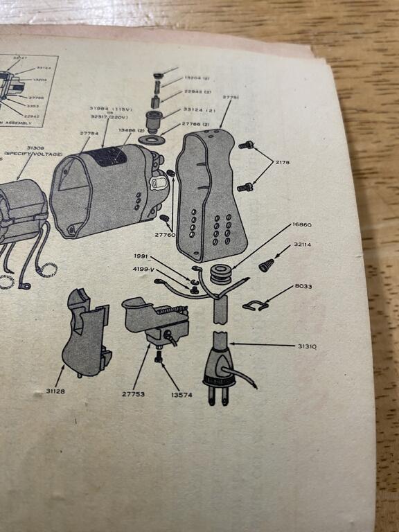

formariz 12,381 #11 Posted May 8, 2023 Real interesting stuff. I never had the instructions for one before. Here is what instructions say in reference to grounding. None of mine however have that wire depicted in instructions. 2 Share this post Link to post Share on other sites

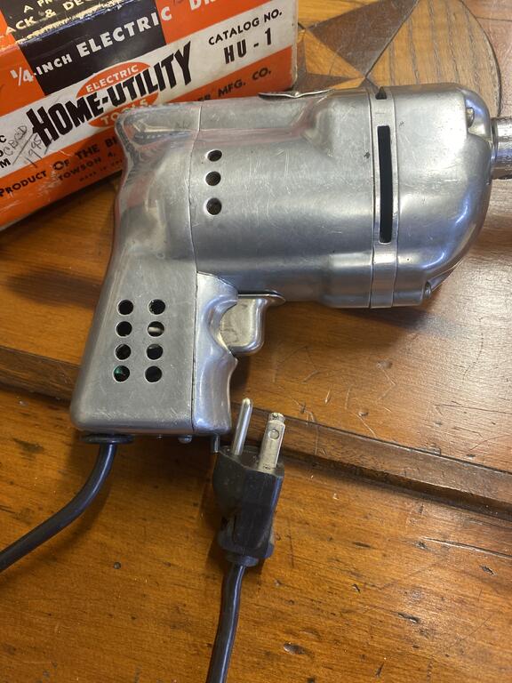

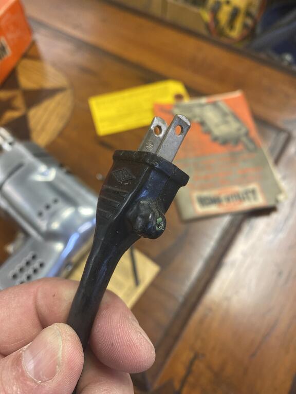

formariz 12,381 #12 Posted May 8, 2023 I stand corrected. Upon closer inspection of plug what looked life a pulling aid is actually where ground wire is. Looks like it was cut off. Will then install the proper plug . 1 Share this post Link to post Share on other sites
rmaynard 17,659 #13 Posted May 8, 2023 My dad had one exactly like this in the 1950's. He got tired of trying to find somewhere to ground the green wire, so he too cut it off. He was never electrocuted, nor did he ever admit to getting a shock or even a buzz from the drill. Share this post Link to post Share on other sites

cafoose 3,883 #15 Posted May 8, 2023 5 hours ago, formariz said: Looks like it was cut off. Will then install the proper plug If it was mine I would put a three prong grounding plug on it and attach the grounding wire from the cord to the drill frame. Then you could plug it into a three prong outlet and it would be properly grounded. 2 Share this post Link to post Share on other sites

formariz 12,381 #17 Posted May 8, 2023 9 minutes ago, cafoose said: If it was mine I would put a three prong grounding plug on it and attach the grounding wire from the cord to the drill frame. Then you could plug it into a three prong outlet and it would be properly grounded. Already done. All the others were done also long ago. The old cords turn to mush after so many years also. 4 Share this post Link to post Share on other sites
